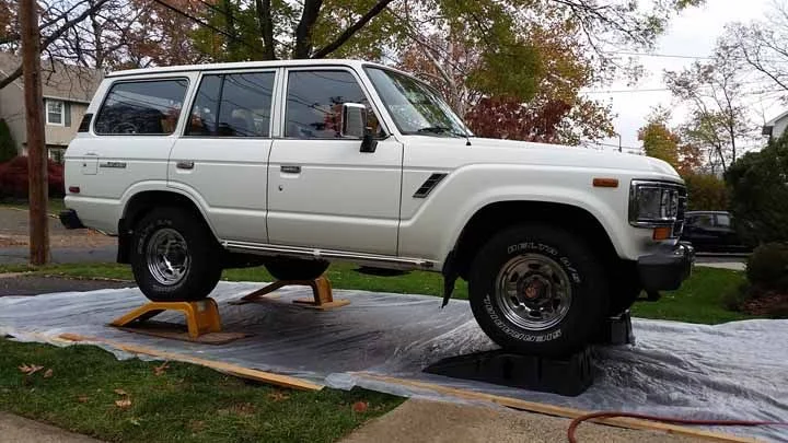

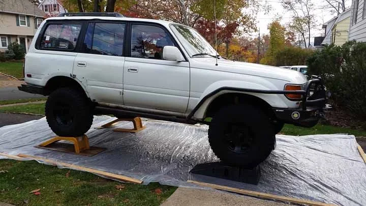

It was a beautiful day yesterday so I had a Fluid Film spray party. I did 4 80 Series, 1 FJ62, and my M416 trailer.
I laid out plastic drop cloths over my driveway with scraps of wood to keep them in place and set up 4 ramps. I put on my Tyvek suit and went to work.
The cheap spray gun from Amazon worked like a dream and I was going through about 1/2 gallon per truck. I sprayed anything and everything starting from the inside of the front bumpers to the rear. I made certain that the entire frame was covered as well as the underside of the body panels. Got axles, suspension, brake baking plates, all up into the wheel wells, etc. Took about 30 minutes of spraying for each truck including refilling the gun.
I got some crazy looks as I was driving around town. The truck was smoking pretty badly as the overspray was burning off the exhaust manifold, but it only lasts a little while.
