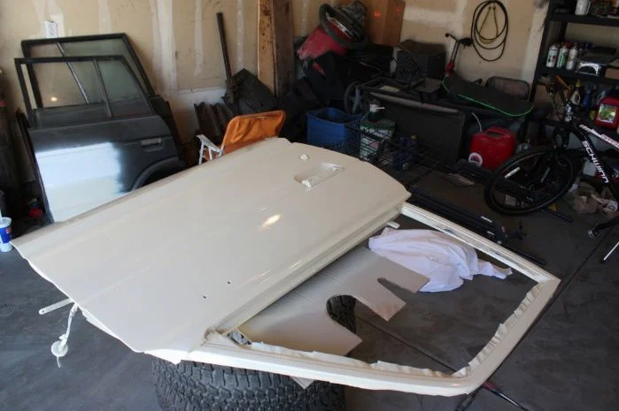

Rust fix and face lift in 10 days!
Here is the new color........its called "NAVAJO WHITE"!
Not a bad job for a spray can huh?????

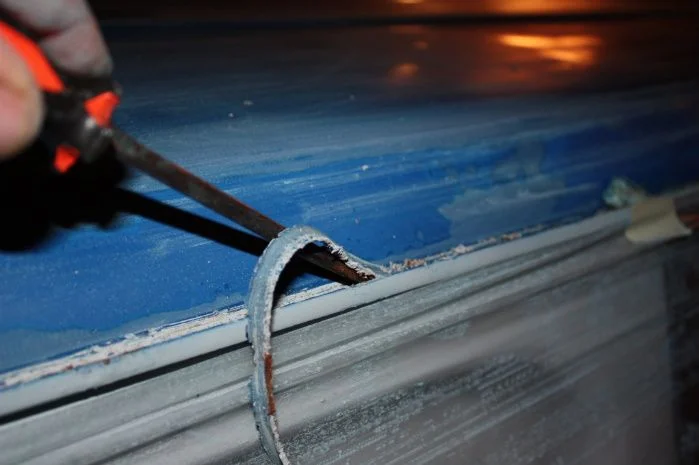

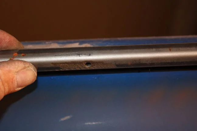

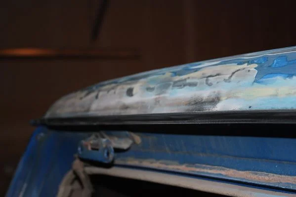

I scraped out all the old silicone from inside the raingutters. I used a flat head screwdriver and a wire brush on the end of my cordless drill. Worked great! Got all the old junk out of there and replaced it with new adhesive/caulk. Much better seal now. I also determined that this sealant is the key to keeping your roof from rotting out. The way the raingutter was designed, it wraps around the two layers of the roof and is tack welded. The gaps are then sealed with the silicone. The condition of the silcone in the raingutter will determine the life expectancy of your roof.
And this was an easy upgrade and I could not believe what was living under that old silicone!!!!???
A must do, if you haven't checked that overlooked area lately!
I'll post more in a bit! thanks for the nice comments from everyone too.:smokin:

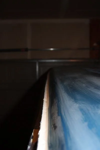

I also got the rear raingutter replaced with that 1/2 X 1/2 stout angle.
I cut the vertical edge off the old gutter leaving the flat part. I then took the angle and drilled a series of 1/8 holes down it. (shown below)
The holes let me tack it on to the underside of the old gutter. this allowed for great penetration and filling of the hole with the mig. I then cleaned it up with a sander and filled the new gutter with adhesive/caulk. It really came out great. I am way happy with it. It is also sooooooo strong. I want to do the whole gutter on my rig with this stuff. (some day)

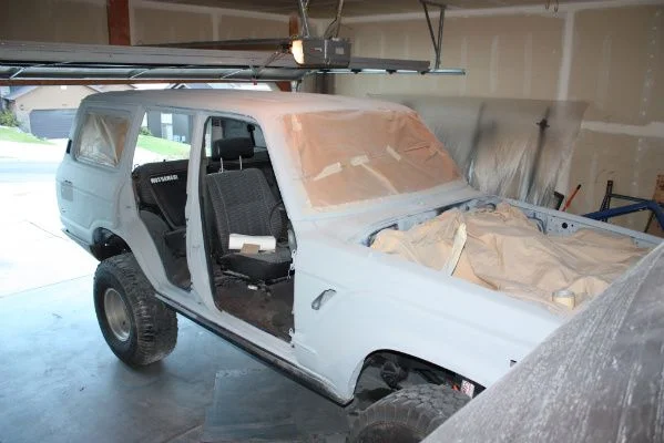

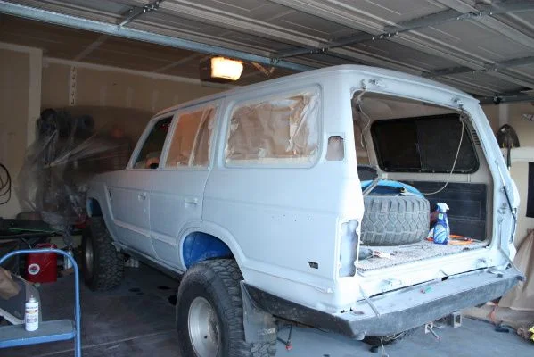

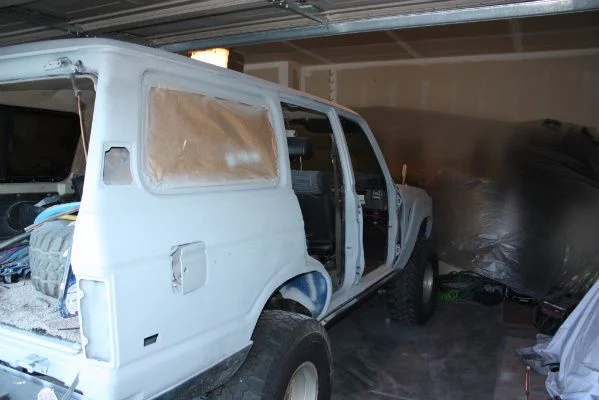

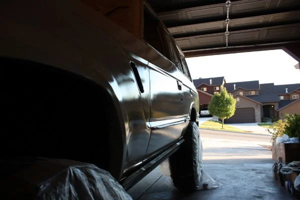

I also ended up sanding the entire rig and first coated her with primer. It was late so i didnt shoot any photos. i will in the morning over some hot coffee.:D
i plan to sand the first coat primer and tack it off and hit again with a second coat. 400 grain sand. wipe her down again..... Tack again.... then,,,,,,,,The first coat of color!
Of course i need to pull the rig out of the shop and do some cleaning and organizing before any paint is thrown down. Not mention building a cacoon to paint in. I'll take it in sections to keep the over spray down to a minimal. See you in the morning.

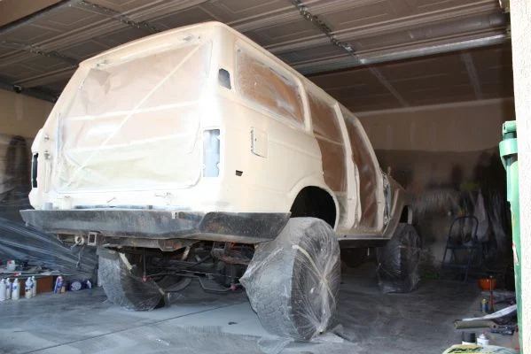

Here is the primer from last night. First coat will be sanded today and second coat primer will be sprayed today too. I should be able to get some color sprayed today as well. I'll post some progress at lunch! I also need to sand down the new back hatch as well as 1 passenger side rear door. For now, it is coffee and some attitude adjustment and preparedness for another long day.:smokin:

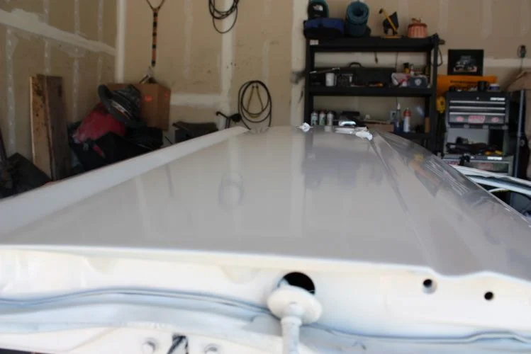

No worries on the headliner. The roof is made of 2 layers. An inner and an outer layer. I just cut out the outter layer. i did have a hose right next to me though.:eek:

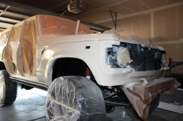

I just got done spraying the first coat and second coat of finish paint!!! i will take some photos when things settle down in the shop. Man.....those fumes are.................................terrible?
I looks good I think? I have a couple of runs. It was the X2 paint! It also means.....move twice as fast when painting. I'll get the photos up in a bit.
NAVAJO WHITE.
