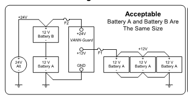

I built a 12v switched and constant fuse panels to be used for all the 12v accessories including the fridge. The 12v constant feed to the fuse panel comes from the pos terminal of the forward battery. The switched power source is activated by a 24v relay thats triggered by a 24v switched power source, it switches a 12v feed from the constant panel to the switch panel. So yes the 12v is coming from one of the batteries, therefore discharging it faster then the other battery, to take care of that, I installed a battery equalizer that keeps both batteries even. I've had this setup for 3 years, although I don;t have any major 12v accessories like a winch, I run the fridge, gauges, 12v usb ports and have not noticed any ill effects on the battery. The equalizer is a must I use the Vann guard one, I periodically check voltage on each battery and its always within .1 volts of each other.

Here is another option that the Vann guard equilizer provides that I may do in the future. It can charge auxiliary 12v batteries without the need of a separate 12v alternator. One thing I am not sure of is how does it know if the main batteries are healthy enough to charge the aux, maybe some kind of smart solenoid can be used.
