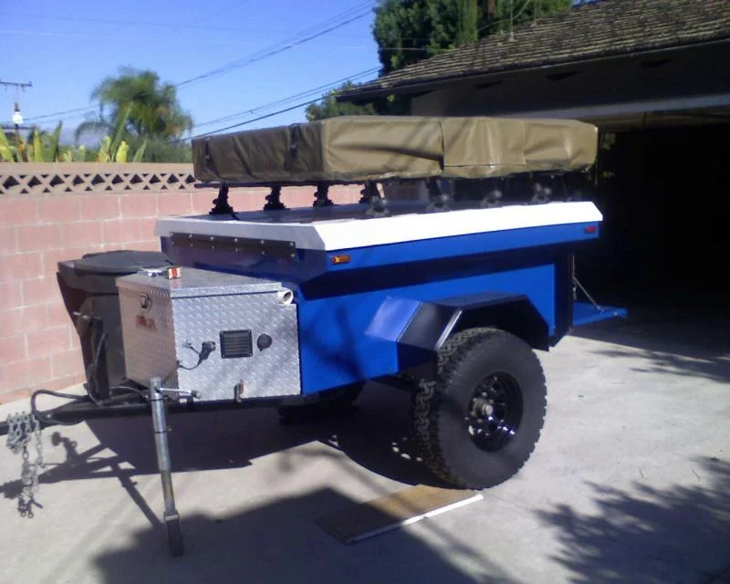

So, I got my RTT on top of my trailer.
attachment.php
Im going to get rid of the yakima rack and bolt it down to the lid.
Just like Exiled did..
attachment.php
Any pros, cons on this....??
I didn't like the way the RTT sits on the top, it makes the COG higher and I need to haul 4-5 bikes on this trailer but I dont have a hitch nor do I want to install one on the rear...
Im trying to come up with some sort of cage that would sit on top of the RTT during transportation and could lift to the side whenever I set the tent up.....
Any pics or ideas are most welcome...

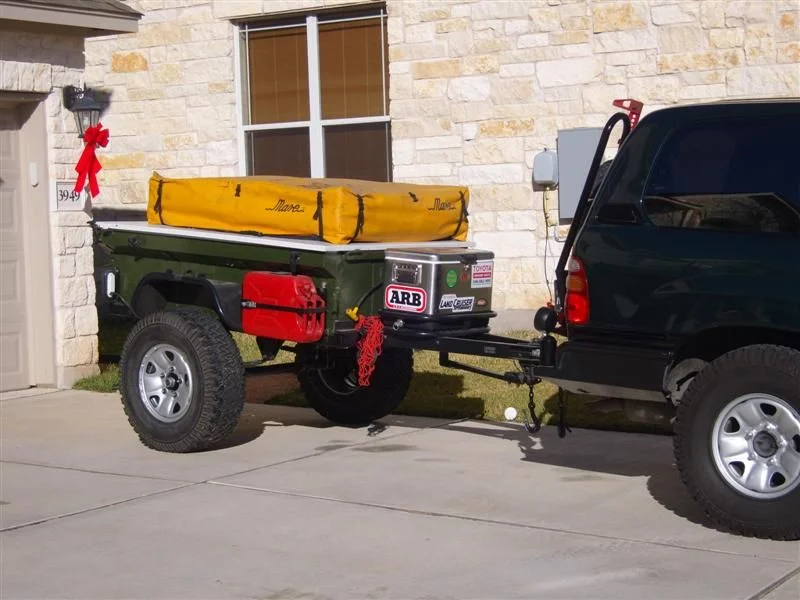

I've run mine like that for years, primarily for the low profile. Lately I've been thinking of another design, sort of a rack assembly that mounts to the lid (bolted) and allows the tent to mount in the center, but with the ability to carry a boat over the rack. I can't leave well enough alone, it's like a disease...
Exiled... yes that's is what Im looking at doing.. I want to carry primarily bikes but obiously I could carry other items as well.. I already did dropped it and bolted it to the lid.. and it looks a LOT better.. now I just gotta come up with a home made rack basket that wraps around the tent and opens to the side....
Im also working on some of the jerry can's saddles that came with the trailer but I want to mod them so they can hold Scepter fuel cans which are plastic...
What about instead of the load bars you just mounted some 1" square tubing directly to the lid. You could make these new "load bars" wide enough (wider than the lid) that you could mount your RTT to it but keep it all the way to one side leaving an extra foot or so of exposed "loadbar" on the other side for your bike mounting system. That way you get a much lower profile/lower COG and can still carry a couple bikes without a rack above the tent to get in the way when you want to deploy your tent.
Maybe I'm missing something but that's the idea that popped into my head.
Adam.. I forgot to mentioned that I also wanted to keep the RTT on the center of the trialer...
I initally I had it to one side and it made the whole lid twist a bit.....
The idea of keeping enough space on the one side does work.. thing is that I need to load 4-5 bikes on the top..... so I really need to come up with some sort of cage/roof rack top for it..
Im also thinking I could get rid off of the aluminum box and install a hitch square tubing and intall my bike rack there.. but then I would need to come up with another place for the two marine batteries, water pump and AC battery charger....
Exiled is right.. its a never ending addiction..
Ok, so how bout this.......
What if rather than a full rack over the tent, if you just built a single hoop at the rear of the trailer that was high enough to have your mounts for all the bikes. Then the bikes could essentially hang vertically down the back of the trailer with the rear tires resting on the rear bumper of the trailer or thereabouts. That way you could still deploy your tent and open your lid without the bikes being in the way. The only downside would be that you would not have access through your tailgate but you could still get to everything through the lid.
