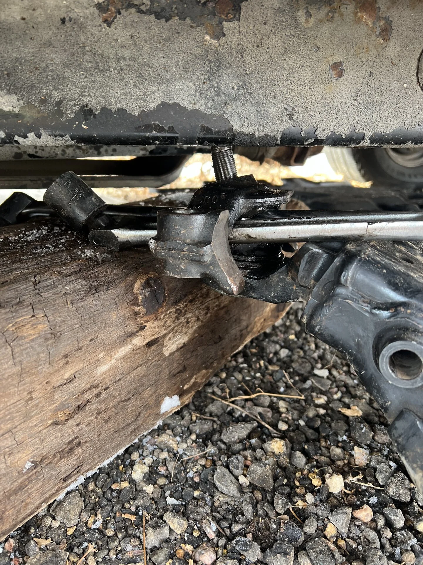

Separation anxiety, plain old bad attitude, not sure why but LBJ is just not releasing the knuckle. Have burned through all my propane, broken a ball joint separator tool, then a second. Am about to resort to dropping a non-running project car on the thing with some leverage. Have a new LCA in the 200 and would really love to not have to reinstall a shot one.
Any other brilliant ideas?
BG Automotive in Fort Collins clutched up. Went to panic stations, dropped the project car on the BJ, no dice, third ball joint kit broken, ditched propane and upgraded to MAP gas, two cans, nothing. BG had the thing sorted in 10 minutes.
FWIW, this mount is out of stock in this country. Got pretty close to hopping on a plane.
