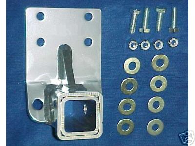

I got one of these extra beefy Downy receivers delivered to me by Mark A. at Surf & Turf. I don't plan lots of towing, but I have a receiver-mounted bike rack. I may mount it behind the rear cross member if I can, to get it out of the way so I don't have to remove it when I'm not using it.
The PO saved the rear step for 28 years, it's perfect, and the kids like it. I have to pull it off this weekend for trailer duty, and it will probably stay off for now.
