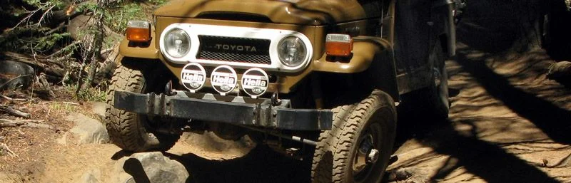

Those can't be B5010's
Hey Eddy,
Just want to know if the springs are stock and if so, which Bilsteins those are?
In with the new
Tint is cool
I disagree, but it's still there. Send me a pair of untinted windows and I'll swap them in and send the tinted ones back to ya.
