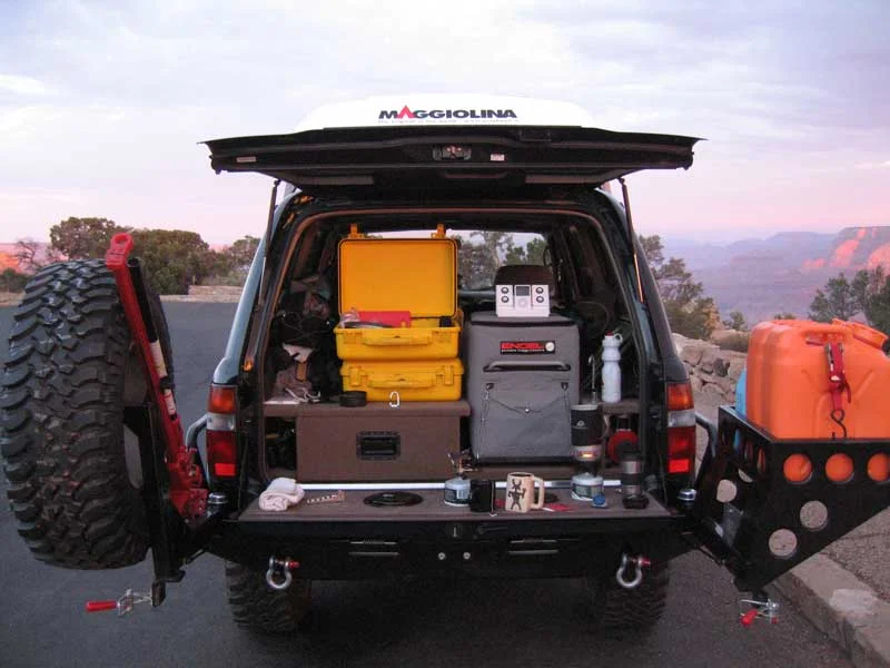

desertdude said:
none - not sure what you see?
I was talking about those black circles on the tailgate...
what are they? look kind of like subs
attachment.php
attachment.php
I see now what you mean - that is an MSR cook pot top and a jet boil cover behind the other stuff - no subs in there :)

I guess a few more questions are needed. Where did you get the handle/pull for the drawer and what sort of mechanism is used to keep the drawer from moving when you accelerate and decelerate? Is the drawer able to be locked?
Thanks!
The handles used are speaker handles US Speaker
The drawer is a near exact fit so when the tailgate is closed - it fits snug against the drawer - the drawer closes with a snug fit due to the covering and I have not had any issues with things opening up unexpectedly
