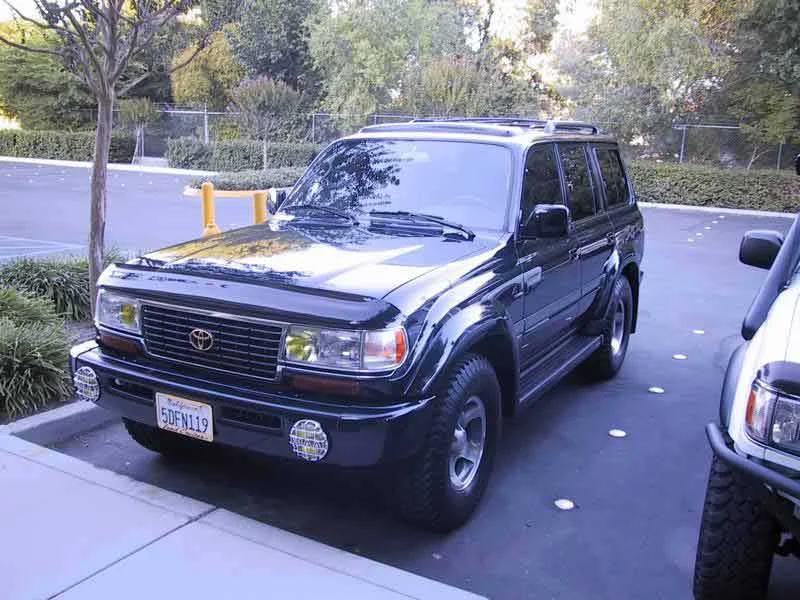

We found our 40th anniversary model in Cupertino Ca. The town made famous by Apple computer. The 80 came to us with 40K miles. The previous owner was meticulous with his care for this vehicle. He drove it on occasion on the pavement only and when he was finished driving it he gave it a complete detail and put it back in the garage. The 80 series was in new condition. And dripping with gold bling. ( first thing to go was all that extra gold bling badging... )

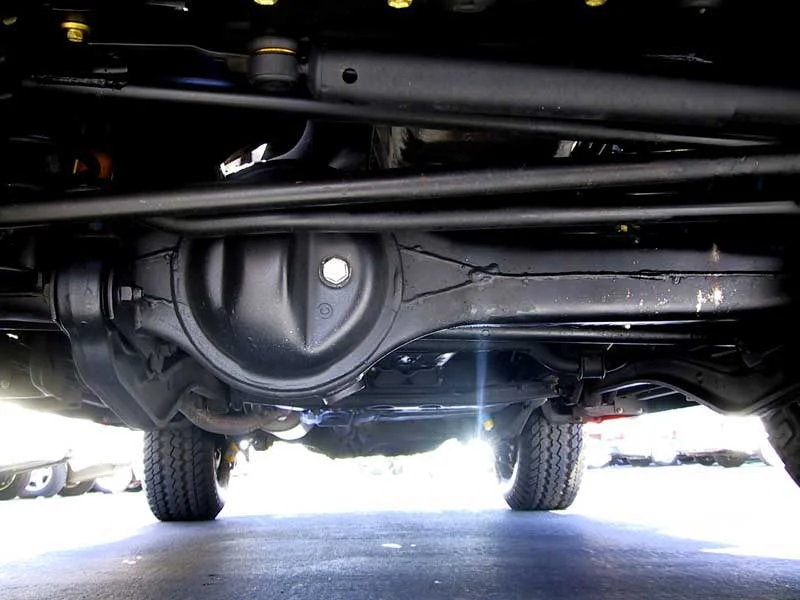

Once we took ownership desertgirl and I made or mod list and prepared to dig into the axles and brakes to make sure the landcruiser was ready for a 2.5 month Alaskan adventure. Once we had all the axles cleaned and re-greased bearings replaced and greased with new seals -slotted rotors and new '97 brake pads , which included Slee's stainless steel brake lines, we started the process of installing Slee's 4" lift kit. Using Christo's detailed PDF it was a breeze for us to do in the garage, while the 80 was up on 12 ton jack stands. I also used Slee's front control arms and the stock drive-shaft for the install.

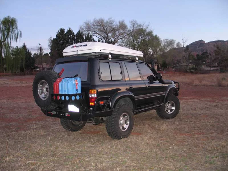

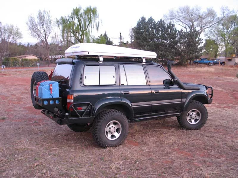

We installed and ARB front bumper along with an XD9000 Warn winch fitted with Amsteel blue rope. Ken Hanna was kind enough to make us a rear bumper with tire and can carrier, along with a set of solid sliders. We installed Since this 80 came without lockers, we sent the diff's up to Slee off-road for ARB locker install and to have the diff's re-geared to 4:88's. We went with 315/75/16 BFG MTR Km's all the way around. I used the OEM locker switch to make a clean install ( and will soon replace the ARB compressor switch with something OEM for a nicer panel look.

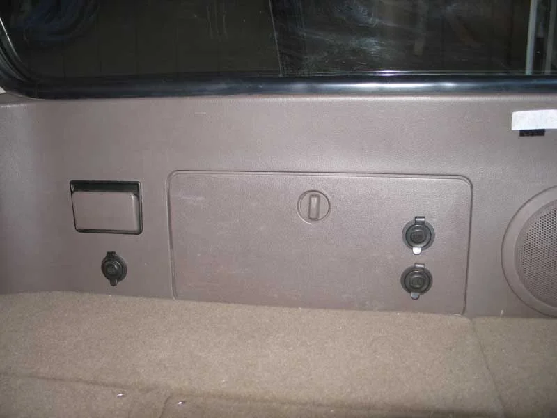

For the many 12v outlets I added - I set up a blue sea 12 space fuse block in the rear under the panel on the passenger side. I ran a #4 wire from the main battery to the fuse block, from there I was able to distribute the power as needed. I used a Hell roaring battery combiner/isolator and installed a second Aux. battery in the engine compartment. Using Slee's washer bottle re-locater kit and a second battery tray I was able to fit in a second optima yellow top group 31 battery.

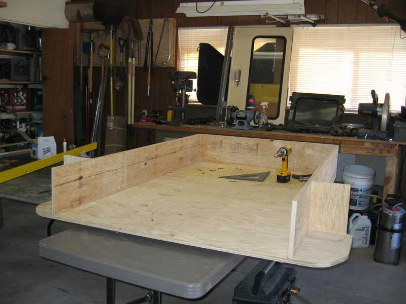

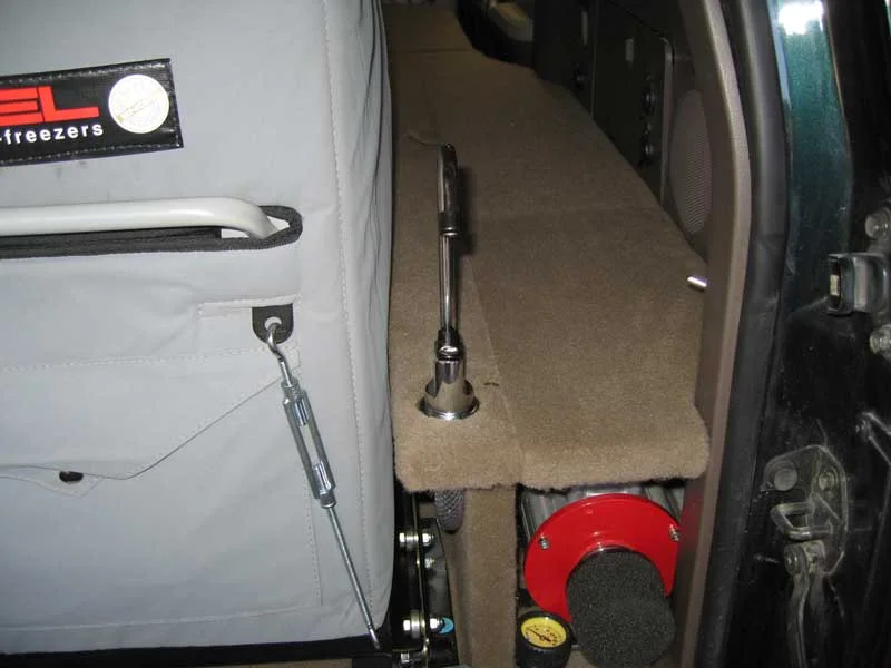

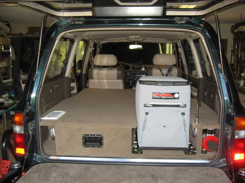

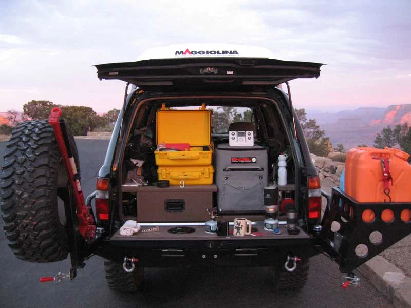

We took the time to custom build a deck/drawer system which holds the Engel 45 fridge freezer a 48" drawer, a 15 gallon poly tank , an Isotemp Marine water heater which runs on 110 and or hot water from your engine, as well as a 12v shurflo water pump, 12v pump and a 12v extreme outback compressor. All of this fits neatly under the deck we covered the unit with heavy duty speaker carpet in prarie tan a perfect color match for the oak interior. I installed a couple of ties downs for the pelican cases and his and hers extra large North Face duffel bags -
See the complete set of deck/drawersystem photos HERE
I did install a pair of 240 light-force aux lights on the ARB front bumper, but they came to an early demise on the Norcal Wagons Moab Prerun ( I should pay more attention in the forward direction) I replaced those with something I bought for my Tacoma. A nice pair of OEM Toyota aux lights purchased from Mot in Japan. Besides the 240's a quite big and could be blocking some cooling air in front of the radiator. I Switch those lights from an OEM light switch I bought from Slee.
In the ashtray position is a Uniden PRO510XL Compact CB Radio and behind the armrest console we installed a Yeasu 2800 2M radio. The CB antenna is a firestik Venice - and the 2m is a Comet 2m/70m - both on Comet hood lip mounts -I decided to use a hood mount on both the CB and 2M for a quick install ( I am thinking of moving the 2M antenna up on the back hatch like Cruiserdrew has , after talking with Andrew and Ron ( paradisecruiser) they both seem to have the best signals. and getting the anttena up higher should yield optimum results. The CB and 2m radios are powered directly to the main starting battery as are all the extra 12v power. I have a 60 gig iPod running into an FM converter module that the previous owner used for a DVD system. I use a monster cable from the ipod to the module. The 80 series sound system leaves a lot to be desired and this will be replaced at some-point with a new system once we finishe the more important modifications.
The last thing electrical we did was to install a Xantrex 1800 watt inverter to run the Isotemp hot water heater and to run/charge our Apple powerbooks and anything else we need 100 volts for. I ran extra heavy 3/0 wire from the Second Aux battery to the inverter. Trying not to make too long a run acrosst the Radiator to the main battery. This works out OK as I usually have the invertor on and heating water while I am driving, which keeps a fresh charge in the Second Aux battery. It takes about 30 minutes to bring the watwer temp to hot in the Isotemp stainless steel marine heater.
I installed a cold water dispenser in the back on the passenger side of the Engel fridge for easy access to cold drinking water, I included a marine aft deck shower controls on the rear drivers side of the deck for outside showering. The water tank is filled from the water inlet we drilled into the raer panel near the gas door. We use an inline water filter and a coil hose to fill the water tank. If we are out in the wild and can find a good water source I have a 110v water pump and can pump filtered water from a stream with ease.

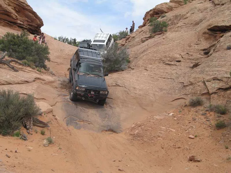

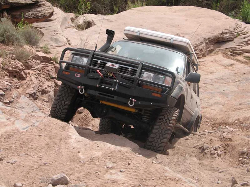

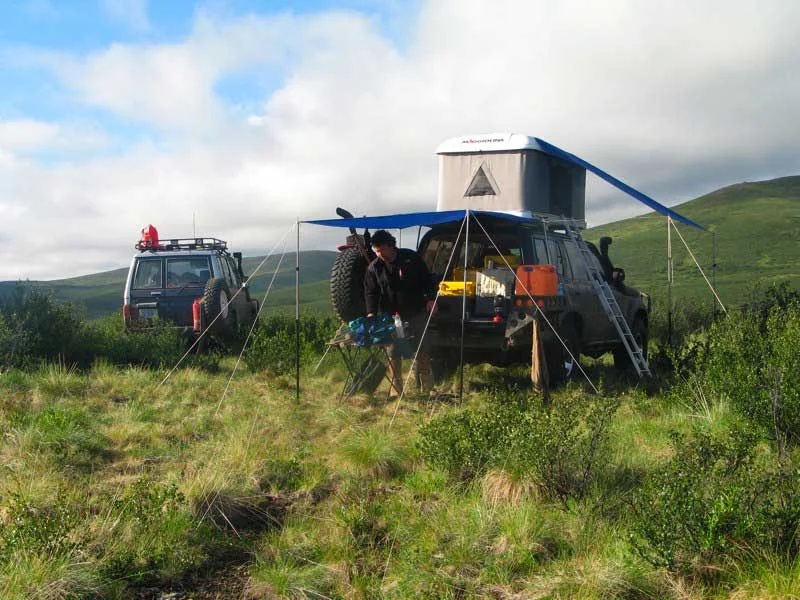

We had a chance to test out the 80 series on the Death Valley Daze 06 trip with the Norcal Wagons as well as their Moab Pre-run. The 80 performs beyond all our expectations. Having just spent the last 2.5 months on the road up to greet Mark Whatley and the Alaskan Cruiser Crew for the ACT06 trip - We had a real chance to get this vehicle out in the outback for river crossings and mud bogs. Even though we were traveling quite heavy the 80 wheeled well and got us up and back with no real mechanical issues. I changed out a cap and rotor and had two flats which I plugged. We we getting between 12.5 and 14.5 MPG depending on how hard I pushed. The leather interior seats make it very easy to drive for 12-16 hours with little fatigue. We are stoked to be driving this incredible legend, being a part of this community, and look forward to wheeling this 80 down through Mexico and on to South America...

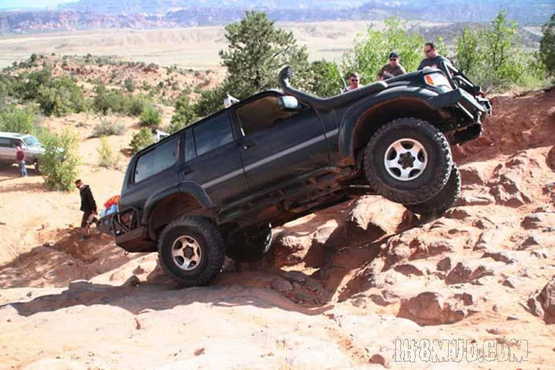

in the last photo -see Jay DeShetler (AKA snook) hanging on for dear life (bless his heart) to get a video of the water crossing at Kane creek at CM06 for his up and coming Norcal prerun DVD

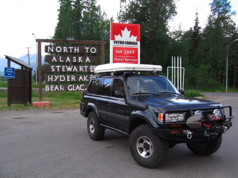

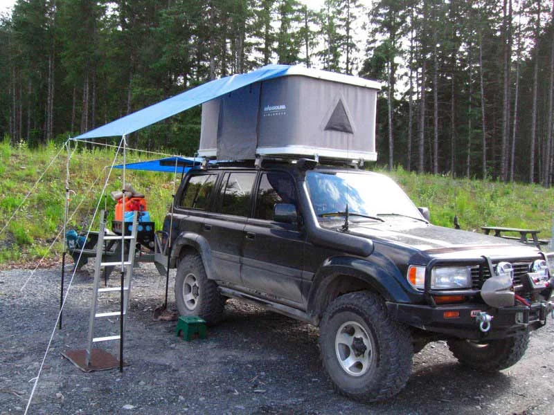

:eek: can anybody give me directions to the gas station in pic #1???????

Very nice truck. My wife and I are very impressed. The tent is super interesting. I need to go research that and might have some follow-up questions.
edit:
1st question: What width of tent did you get? Seem roomy enough for 2 adults?
