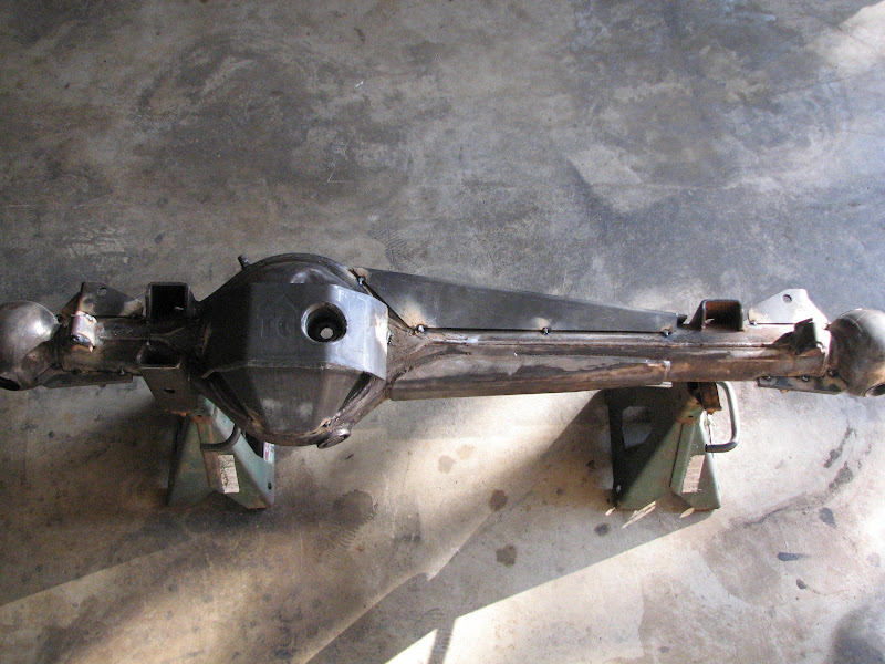

Front axle beefed up with 30sp Longs, hub gears, ARP hub and knuckle studs, Longfield wiper seals, trussed and armored.

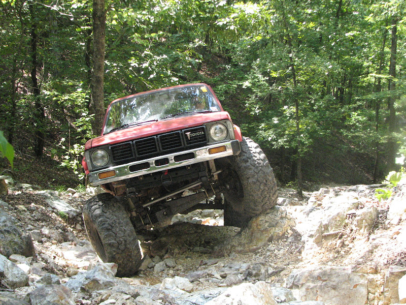

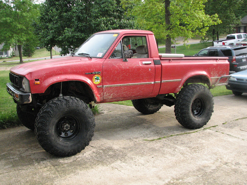

As it sits today:

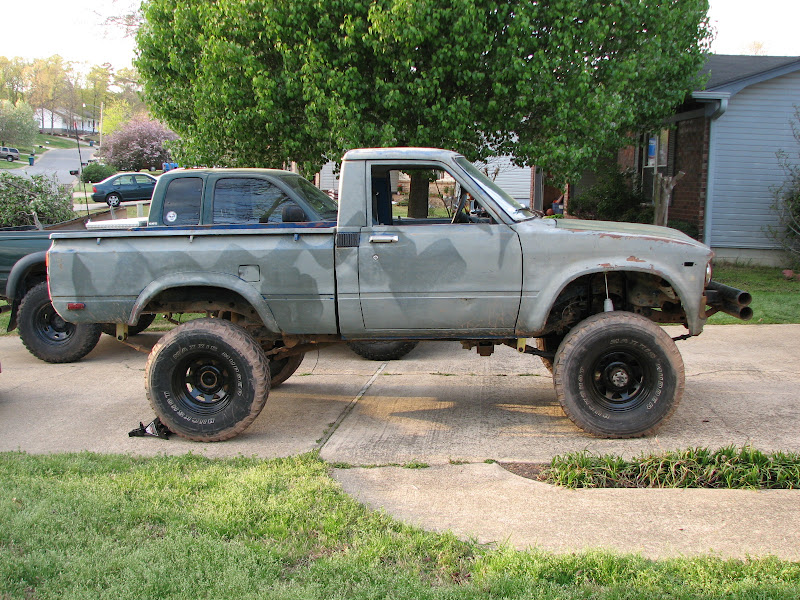

It all started in December 2006 when my wife purchased my first truck for a Christmas gift (I chose the truck).

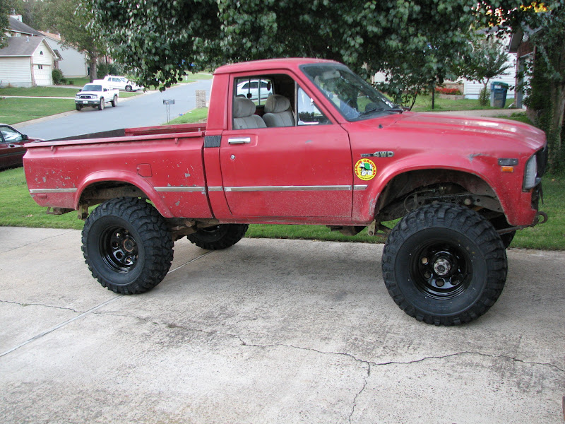

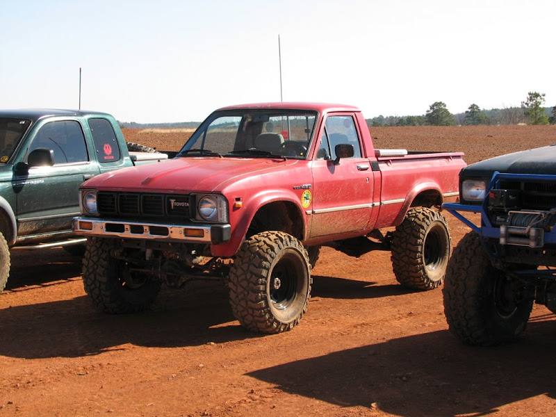

After some slight modding, and some general maintenance work, this is how it sat around March 2007:
A few things that I didn't realize about this truck is that it was wrecked pretty bad at one time, and the frame was bad bent, and the body was tweaked to where nothing lined up right. So, I made a few phone calls, and found a good '82 frame, cab, and bed to move all my running gear over to. This was July 2007.
I worked frantically for 3 months making 2 become 1, and finally got it on the road again and ready for it's first real offroad trip in September (ARTTORA 1st Event). September 2007:
I won some better tires in the raffle at that event, so I had to get them mounted. They were 33x13.50x15 Pit Bull Rockers.
I then put in a IFS rear end, and made a few other mods, then it was time to test the tires. October 2007.
Some of the work that was done during the swap to the red truck was doing a "J-Arm Ball Flip" and running a drop drag link. I also was running an Aussie locker, and both axles had the stock 4.37 gears. I also when ahead and upgraded to a L52 transmission over the L43.
That wraps up the intro of my truck, and finishes up the first year of it's life with me.

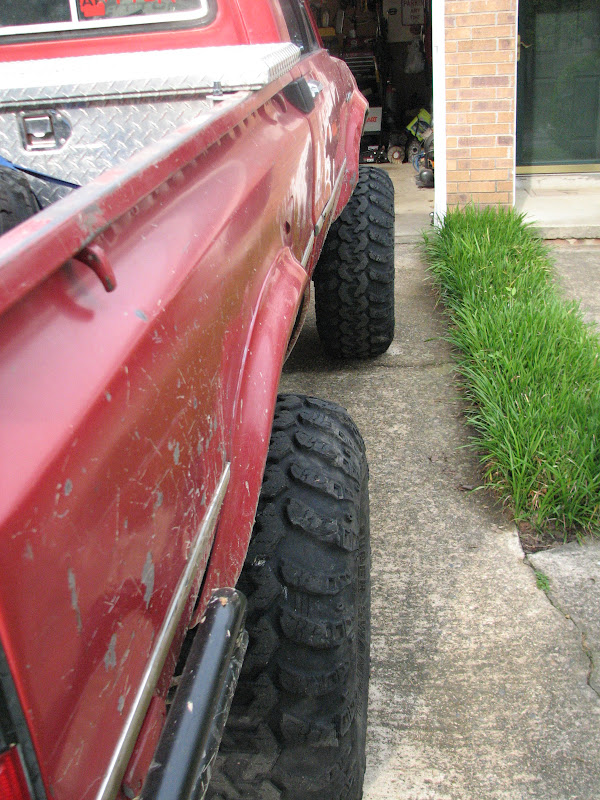

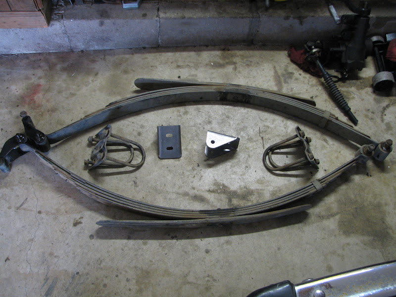

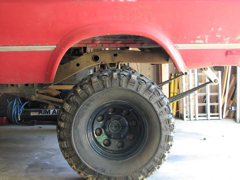

I soon realized that I needed better springs in the rear, so I started researching the Chevy swap. I really didn't like how much spring was overhanging, so I decided to try Ford F150 (57") springs instead.
I got a sloped Chevy spring hanger from Datin fab (has a 9/16" hole instead of 18mm), and welded it to the frame to move the front hanger 4.5" forward of the stock position. I carefully cut the rear shackle hangers off and moved them back 3" (probably could move them 3.5"). I am running them short side forward instead of the optional long side forward.
I kept the factory Ford bushing in the front, and used the bolt from the Ford as well (hence the reason for the 9/16" hole in the hanger). I drilled out the shackle end bushings with a 1" hole saw, and the bushings that came with my Marlin Crawler shackles popped right in.

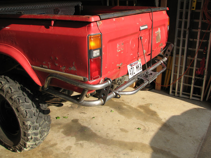

Then, I bought a MC rear bumper. So far I have no complaints of it. The side protection gets all the abuse on mine. :D

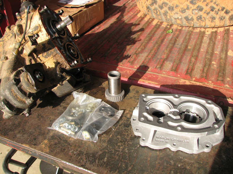

I got a smoking deal on a brand new MC07-R10, so I started working on dual cases. Both are stock geared at 2.28 for now.

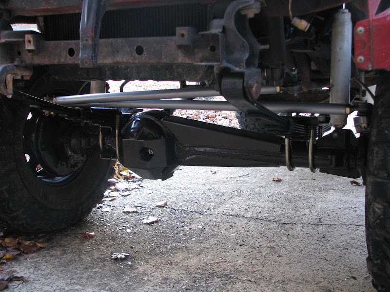

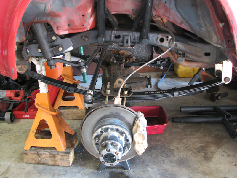

The summer of 2008 was spent wheeling the truck as is, and taking a break from the garage in preparation of our daughter being born, so things kinda stopped until November. Then it was big upgrade time! Highsteer and new springs were installed.
Here's what I had piled up:
New All-Pro 4" front springs
Marlin Crawler front spring hanger
Marlin Crawler HySteer kit
IFS calipers for the big brake swap.
A pile of front axle armor and a 83 front housing to chop up and swap all my guts into
Some of those nifty Marlin inner axle seals

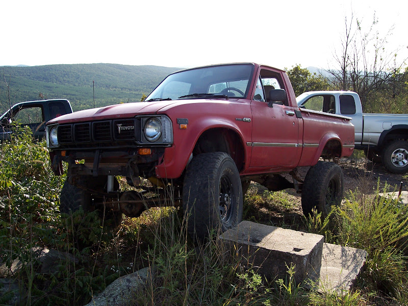

That pretty much rounds out 2008. I'll leave you with some wheeling pictures collected from various events that year...

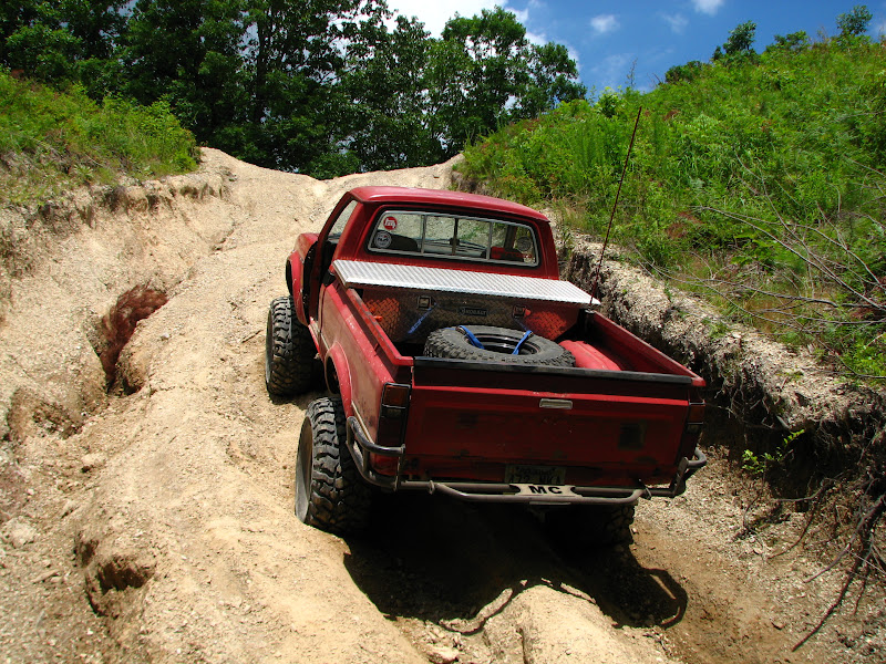

2008 Lone Star Toyota Jamboree
2008 Razorback Ramble
2008 AR-TTORA Event

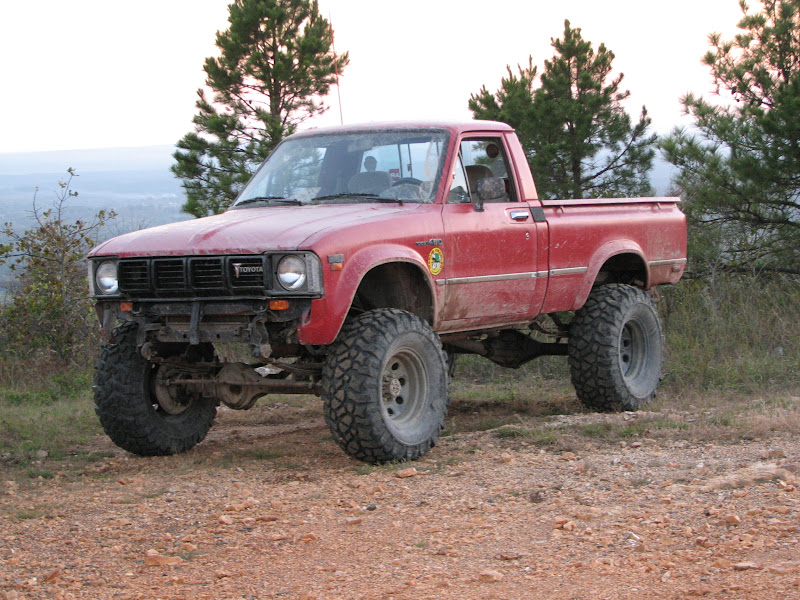

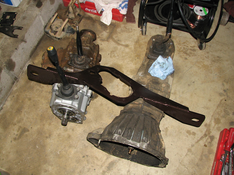

So, 2009 started out with me finishing up the crawl box install.
I decided to ditch the L52 for a W56 while I was having to make room for the dual cases and the Front Range Crossmember. My L52 was getting sloppy, and the W56 gives me more options later (like 3RZ options :hhmm:).
I built my own "4RnrRick" jig to setup the driveshafts. The front turned out perfectly straight (can run it 50MPH without any vibes), but the rear was off a tad. I used an All-Pro long spline kit, and some schedule 40 pipe to make a beefy front driveshaft. I also used the schedule 40 on the rear shaft, and had the local driveshaft place balance it.
I got everything installed, and took it on a trip or two. Man, dual cases are the mod to have! :grinpimp: Lower gearing is so awesome, that I soon realized that my 33" tires weren't going to take me where the crawl box wanted to go. :lol:
So, I traded my PBR's for an 8274 Warn upright winch (more on that later), and found some used 36" IROK's. I love the size, but I miss the highway ride and traction the PBR's had.

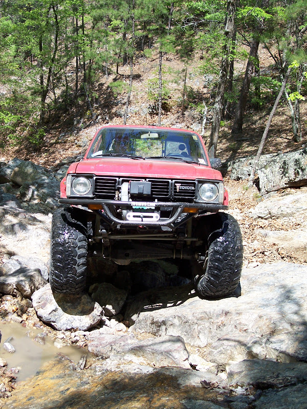

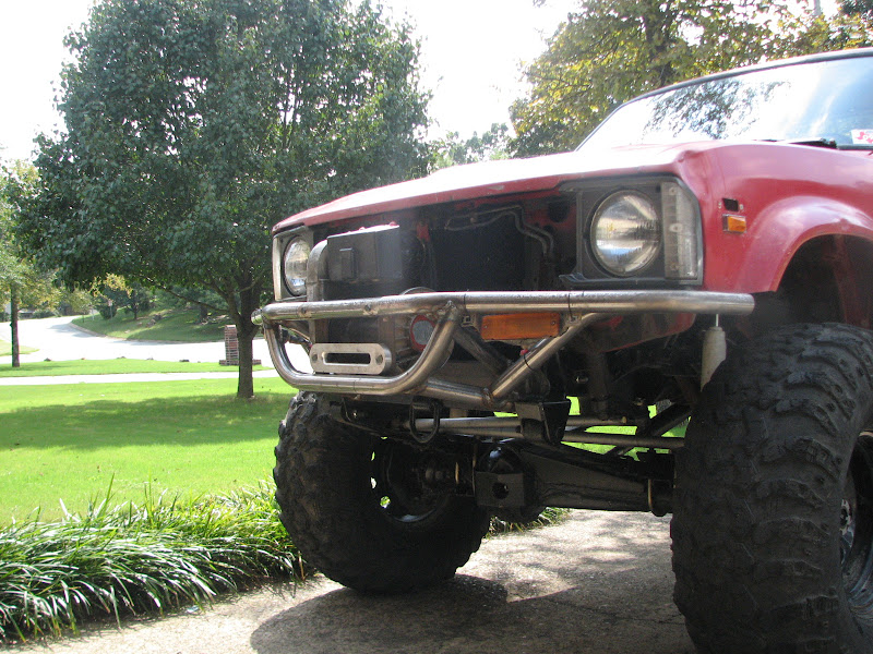

Now on to the 8274. I bought some synthetic line from OKOffroad, and a Sky aluminum fairlead. Two sticks of 1 3/4" .120 tube and a Saturday later with gittinit left me with a new custom bumper! I wanted the winch recessed as close as possible without having to cut the body (didn't mind cutting the grill).
This is how it looked at the end of the day.
And this is how it looks now.
I still need to get better pictures of it. I kept the stock blinkers and mounted them with some welded bolts.

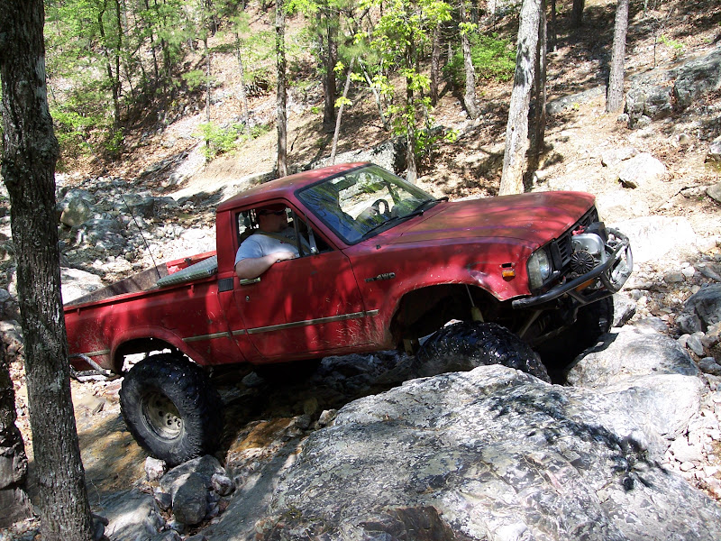

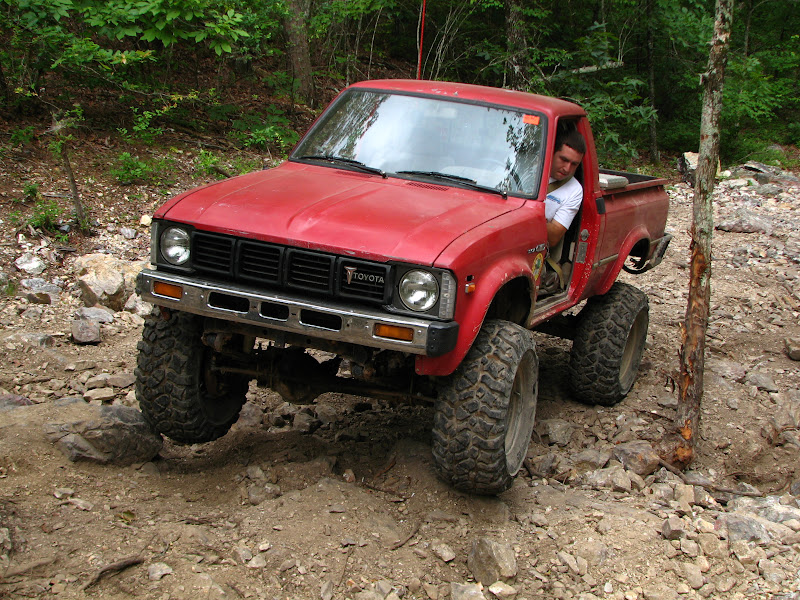

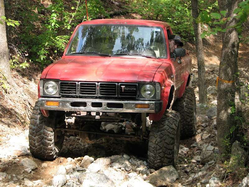

And there's 2009 in a nutshell. :) I spent more time wheeling than wrenching it seemed. I hit 4 major events in our area (LSTJ, OCC "non-ramble", National TTORA Takeover, and the Souther Cruiser Crawl), and probably half a dozen other trips with my usual crew.
I also started a bad habit - wheeling and not stopping for pictures often enough, or making sure there is a camera monkey for every trip. :lol:

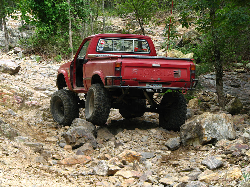

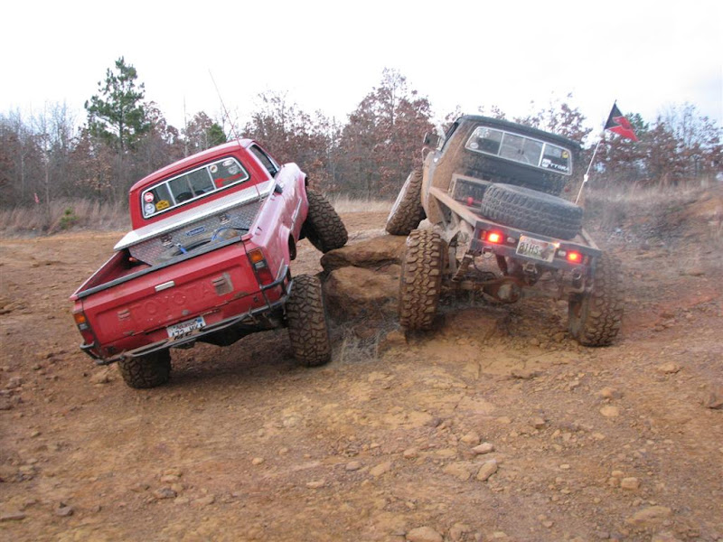

Here are some pictures from various wheeling trips...
2009 Lone Star Toyota Jamboree
2009 Ozark Cruiser Crawl (the Non-Ramble) (not my pictures)
2009 National TTORA Takeover

Next came a set of Longfield 30 spline birfs and axles. I've wheeled 3 years without blowing a stock birf - that is until i bought the Longs, but didn't find the time to install them before the trip I broke the birf on. :bang::rolleyes:
Pretty much the next trip lead to more carnage. The center pin in my 4 cylinder Aussie locked rear diff broke, causing the locker to slip and pop, and eventually it rounded the teeth on the locker that it pops all the time. :bang::rolleyes: Oh, and that loose center pin took out teeth on the pinion. Thanks to a friend, I found another center pin, and kept wheeling that weekend. The chipped teeth on the pinion lasted the 45 miles home too. :D
Now, I've got a pair of Elockers going in. The rear is done and wheeled on already, and I'm working on the front as we speak. While I have the front end apart, I'm upgrading to the ARP hub and knuckle studs.

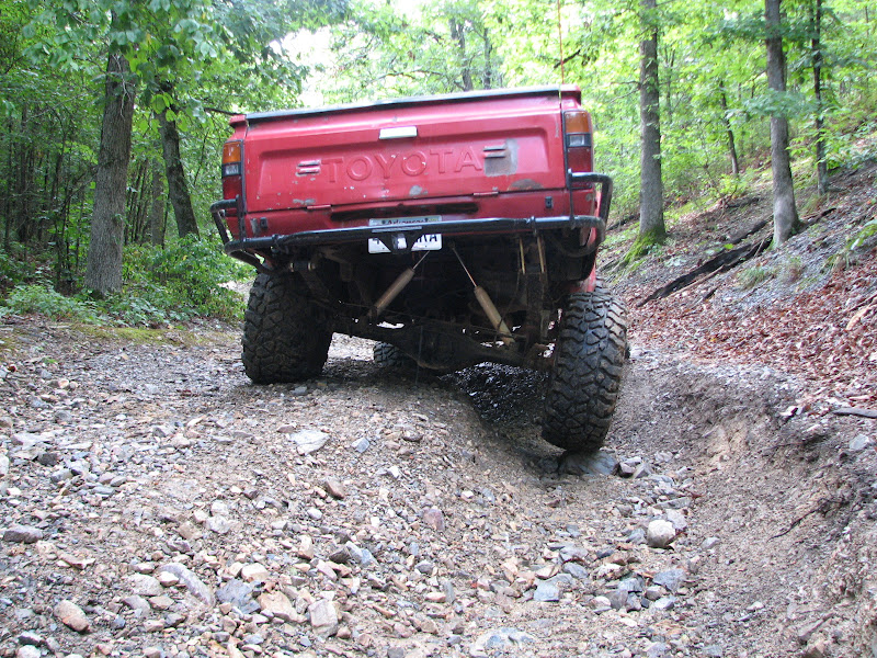

Need to either build a traction bar, or add some more leafs to the F150 pack one day. Too much wheel hop when climbing ledges.

Do you think if the rear springs had the long section in front it would reduce the wheel hop on ledges?
Awesome truck Josh.
Thanks John!
Not sure on the direction vs spring wrap issue, but I know that I didn't want to go through the hassle of rotating the perches to get a decent pinion angle. Mounting them long side forward tends to point your pinion at the ground.
I know of people running them both ways. Mine aren't doing it bad. I'd say they aren't doing it any more that 63" chevy springs.
