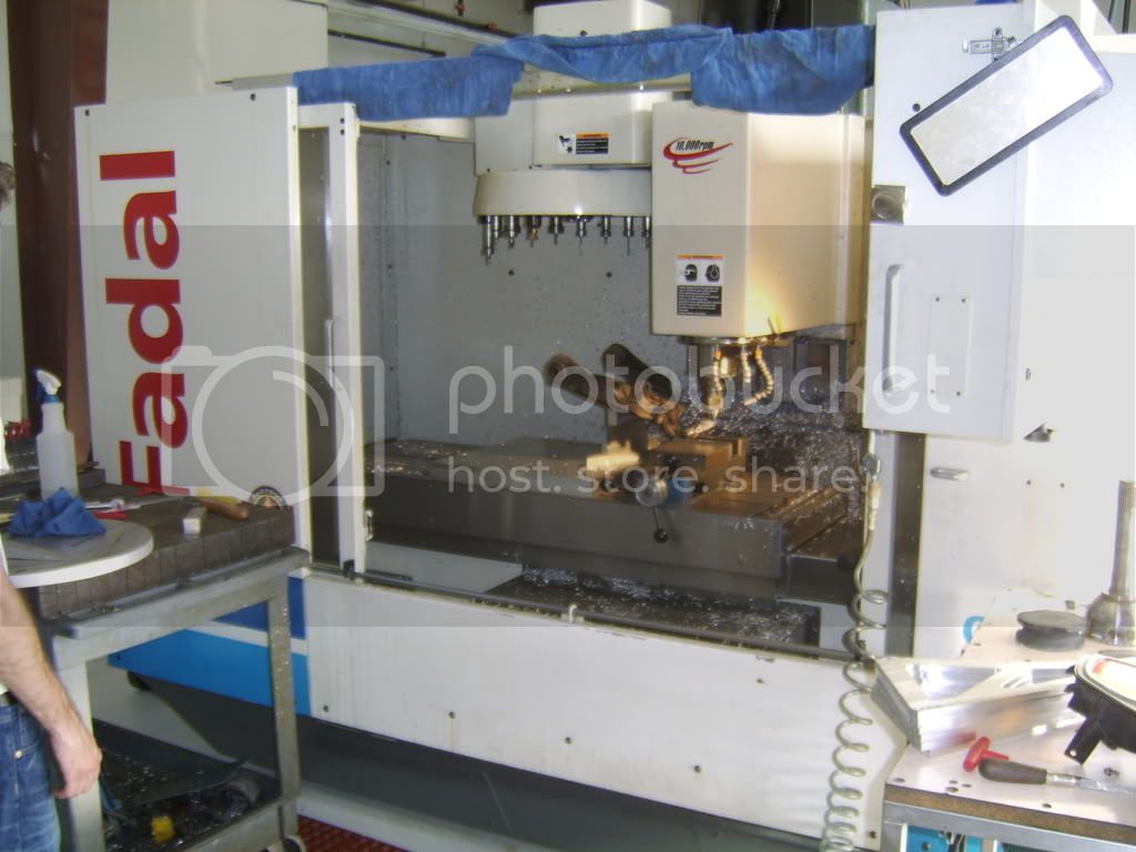

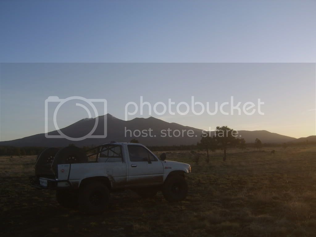

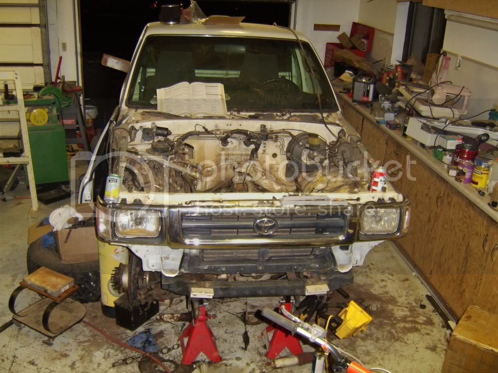

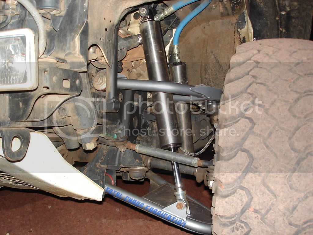

I've had this thing for about 1.5 years, not too much room and not clean at all :D. Absolutely the most fun I've had with a rig in my life, got it for 1k with issues from coolant mixing and crummy wheel bearings. Very generous deal, even got to use the host garage to straighten things out. I don't have a garage so all the elaborate work is done at my buddy's machine shop. This wouldn't have been possible without M0627's help, thank you sir.
I like to play in rocks, however 9.5 out of 10 miles are just really bad roads. Gathering parts for a long arm setup took a couple of months but it's been worth it. I got the first generation Total Chaos kit to use ball joints. My first experiences with spherical bearings (heim's) made me believe ball joints were more streetable for wear characteristics. However since then I've waffled :D, torsion bars are just irritating from a maintenance standpoint now. In the last year we've gotten better at swapping heim joints and the cost is marginally higher than a BJ. Saving up for a gen 2 Chaos kit after I get tires. Yes, that is rust on that hardware :o.
I cleaned and painted things before winter hit, however even with religious washing habits rust creeps in wherever it can. The frame is fine, it got two cans of paint a month in the summer.

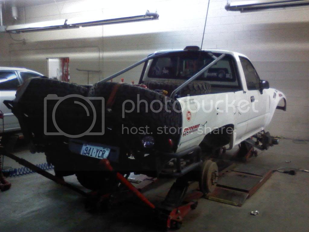

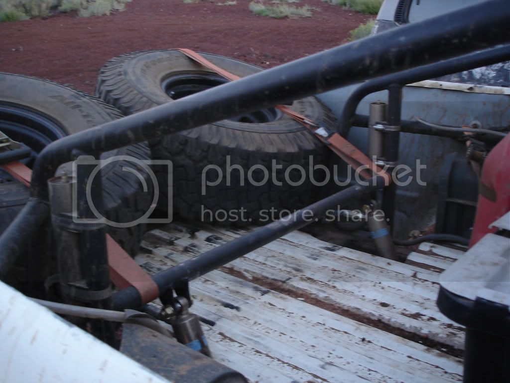

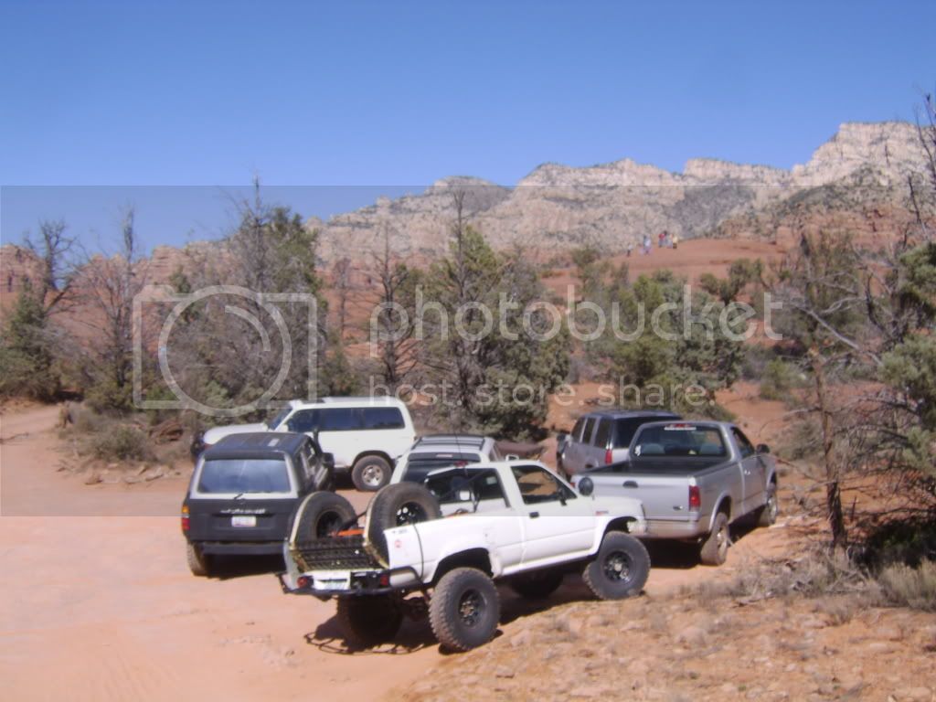

I wanted to keep the bed at first but a rear end collision bent things up pretty good. Happened three days after I had a practical hinged gate mount for my sandladders. I started making another variation of the hinged mount that ended up failing. The straps hold the gate well enough for now until I make something right. I can still cram bikes in the bed, just gotta ditch a spare. I'd rather keep them both, if I need one I swap them both for the dang offset. Getting spare wheels for my 10.50's when tires happen.
The rear shocks are smaller Bilstein 7100's. I thought I could get away with lighter shocks in the back but I've bottomed out back there lately. Rear springs came with the truck, appear to be Rancho's :doh:.

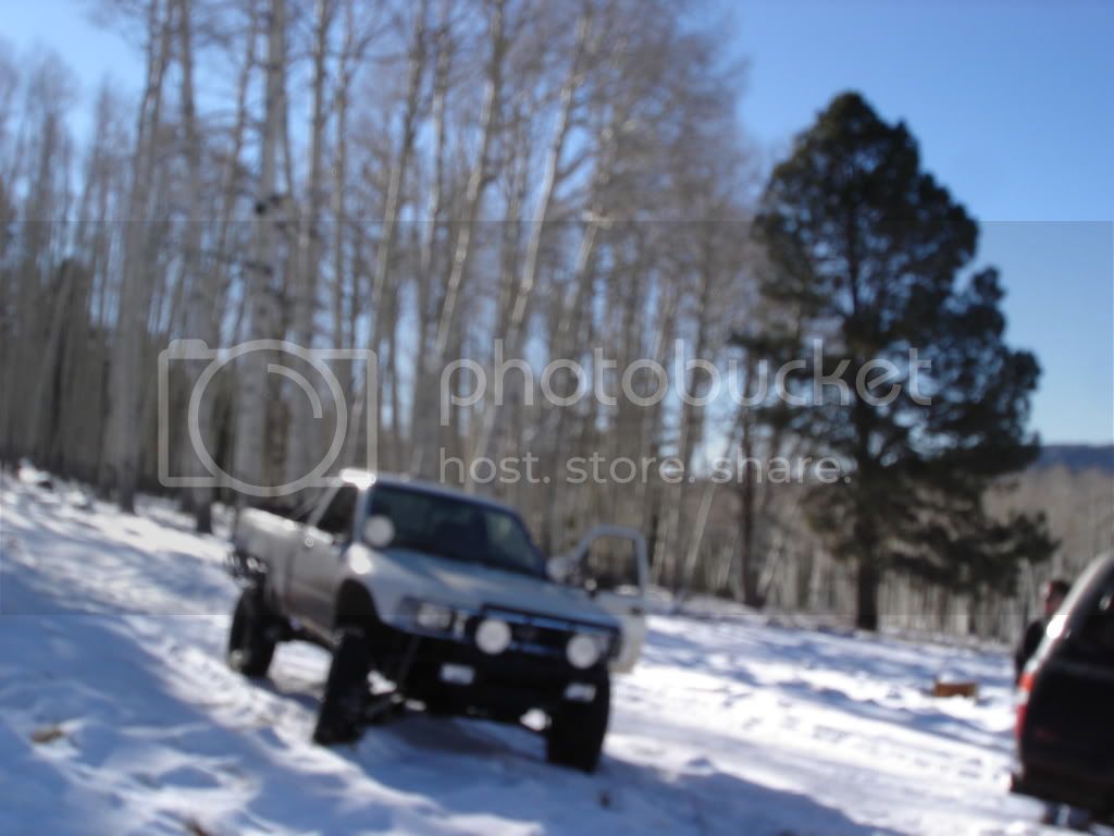

Here's some of the first wheeling days, no problems getting around stock :cool:.

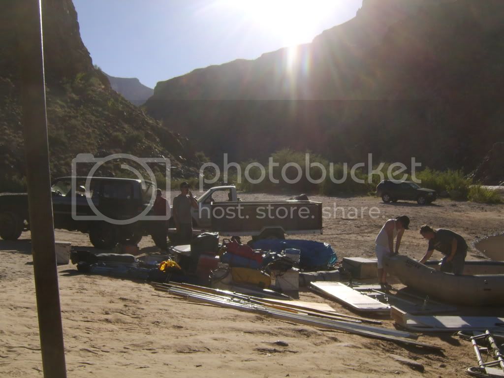

Here's something I miss, the bed utility for river trips and camping. I can make a solution with more work in the back, hopefully in time for next river season. The roads to the Colorado are rotten and the shuttle drive takes you through miles (30+) of sandy washes.

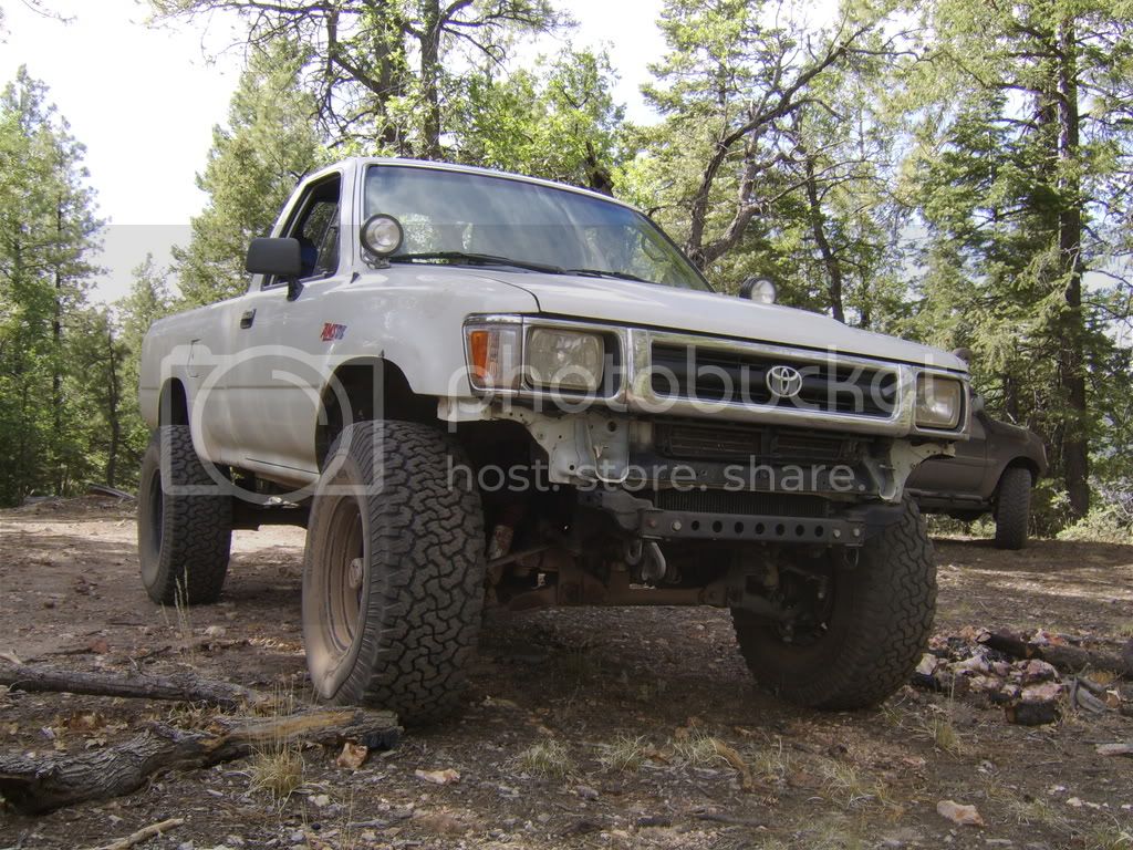

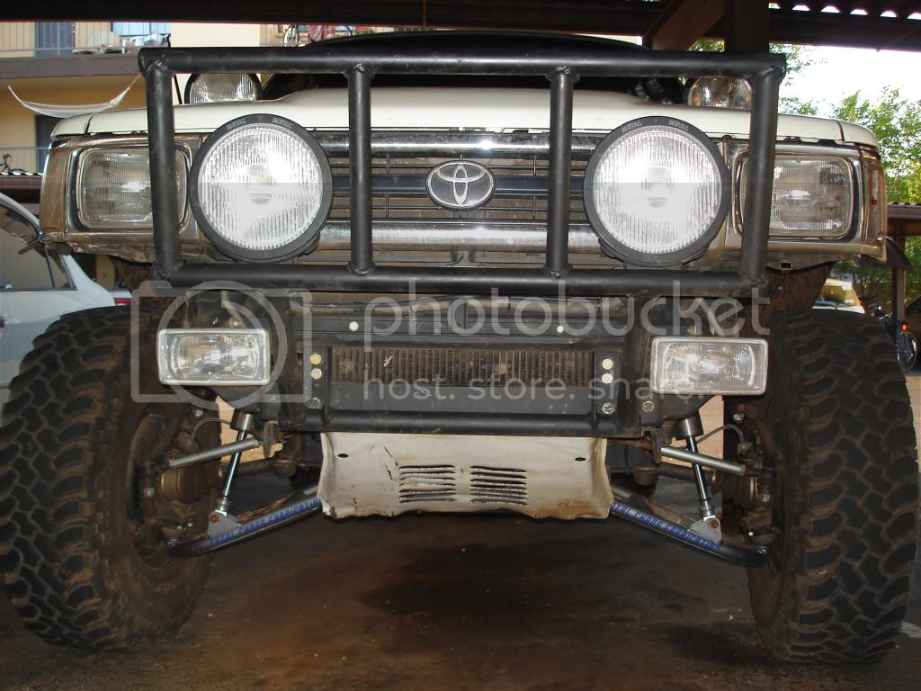

The cow catcher's lower rectangle is .250 DOM with mounts to an ORS Frame Crossmember. Upper tubes are .125, the rest was left until I figured out how wide the truck would get. Welding is at a standstill for now, welding buddy slashed an index finger tendon. It's fixed now but recovering, I'm getting better but need practice.

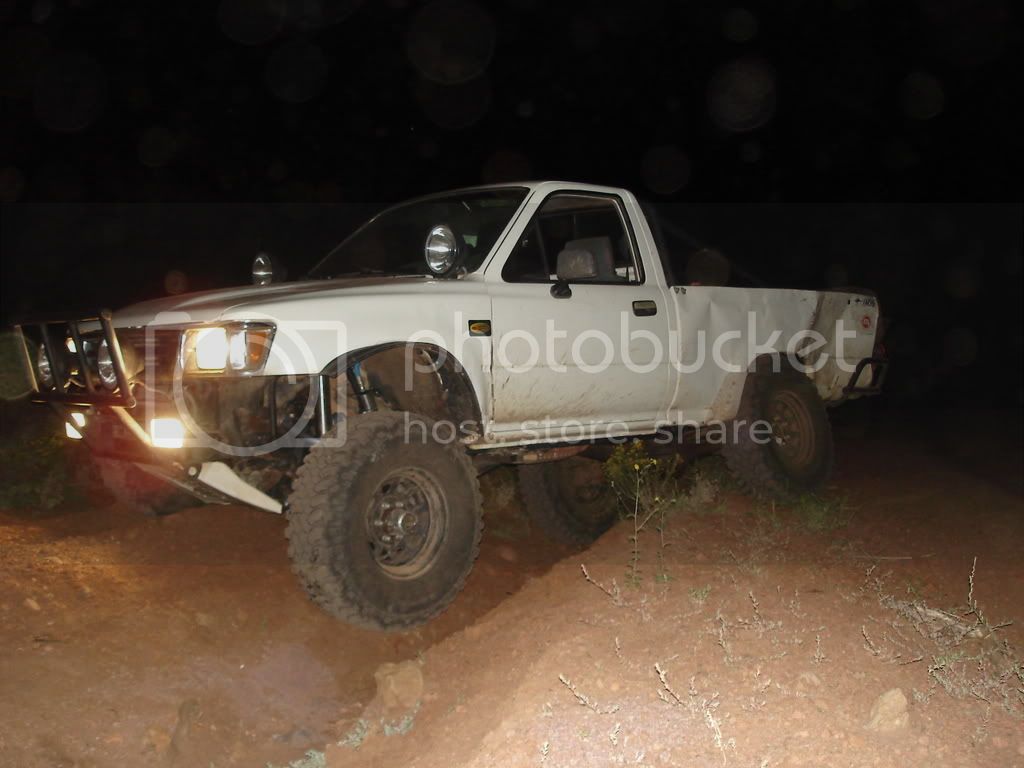

You can't see it in this picture but I've got some gouges from sliding over rocks and a dent in the passenger LC arm. The gouges were gentle but I remember the rock dent, that was a big hit.
While getting around stock wasn't a problem the suspension takes me further. We measured 11.75 inches of travel in the front after installing the TC Caddy Kit. Rear gets about 18 inches, more up-travel than I had planned. I've nose-planted this thing about hood high but that's it for now (BJ's gotta go). Urethane stops shatter after a few good hits. My buddies swear by bump cans, much softer landings at any angle.

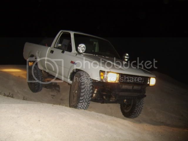

Current front end wheeling, wasn't able to make it this high up the hills before:

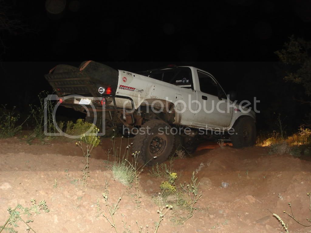

A problem with jumping that my arm truck buddies also have is you usually charge your shocks on the lighter side for better DD manners. Jumping is best from a "tabletop" otherwise you've gotta hit your jump fast for the truck to launch right. Bad launches bring the nose down hard as sin. That being said I'll see what I can do :bounce::bounce2::steer:. I wish we had that last one on tape, I don't bottom out the rear end every day :D.

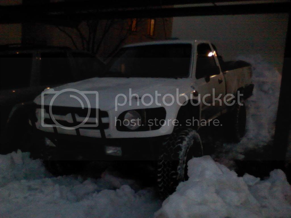

I got a one piece front used, need to get lights still. I put 55w's in the Hella's with a low aim. Not offensive from an oncoming vehicle's perspective. The cab needs metal work in the wheel wells to clean things up. Fresh tires in a week, I've struggled a lot in the snow lately.
Thanks, it's been a lot of fun to build and drive. I've verified that I can fit 2.5 coilovers, I can order them in a week. The Bilstein 9100's take about a month to get here after placing the order (parts are readily available stateside). I need to fabricate an improved upper crossmember and bolster the shock hoops, that's about it.

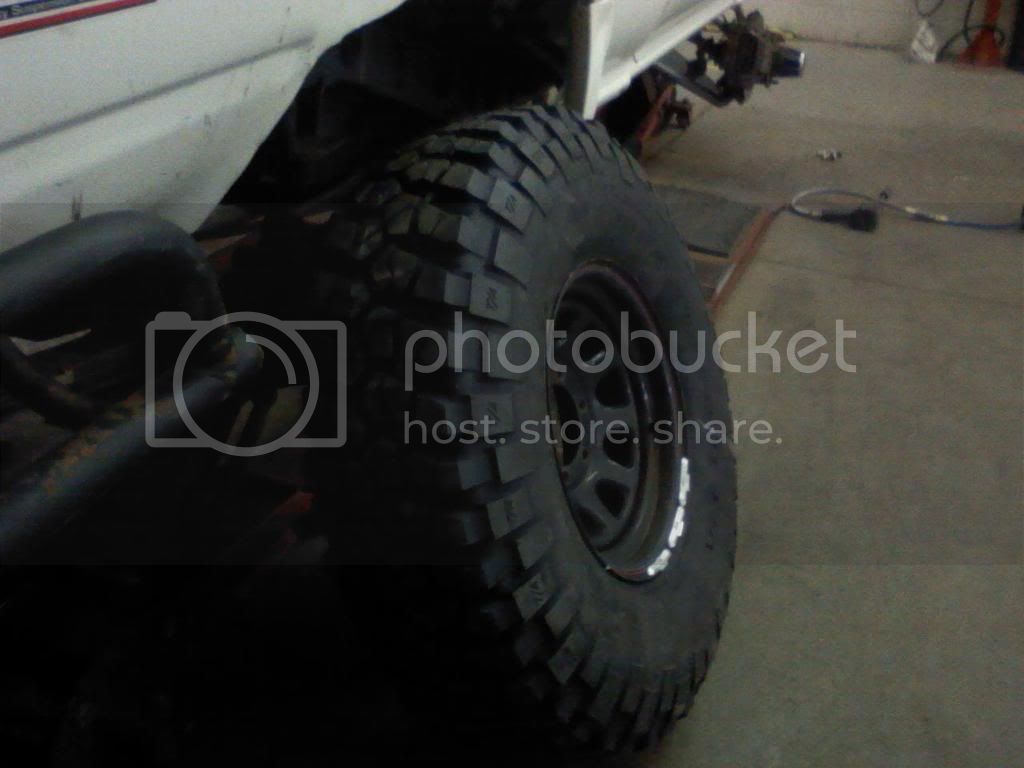

In the meantime it's time for some new shoes :grinpimp:. The older style BFG Mud Terrain has been superceded by the KM2. I liked the old ones just because I knew what to expect, the new compound is very soft. The truck rides great, even goes in a straight line down the road :hillbilly:. Expecting some snow tonight, we'll see how they do.

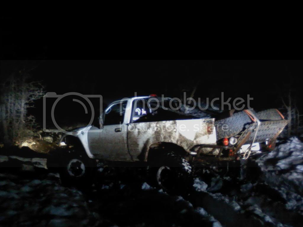

The tires do well, more positive control in deep snow. Tire tread cleans out faster in snow, they dig their way down fast. Corrections at speed are extremely consistent. I can follow through with a turn correcting crab walk without fish tail in the rear. They took me about as far as the old version MT's. Here I'm moving back and forth but it's too deep to turn around. The truck's weight distribution makes backing up slick surfaces difficult, it took almost 10 minutes to make it backwards up the hill. I was stuck in this same spot last year with the old MT's fresh but deeper snow.

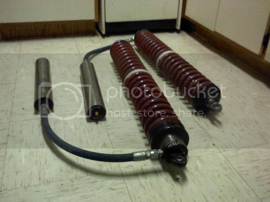

Here are the front shocks, a few other things need to get straightened out before they go in. Those are the springs that came with them, different coils will be installed.
