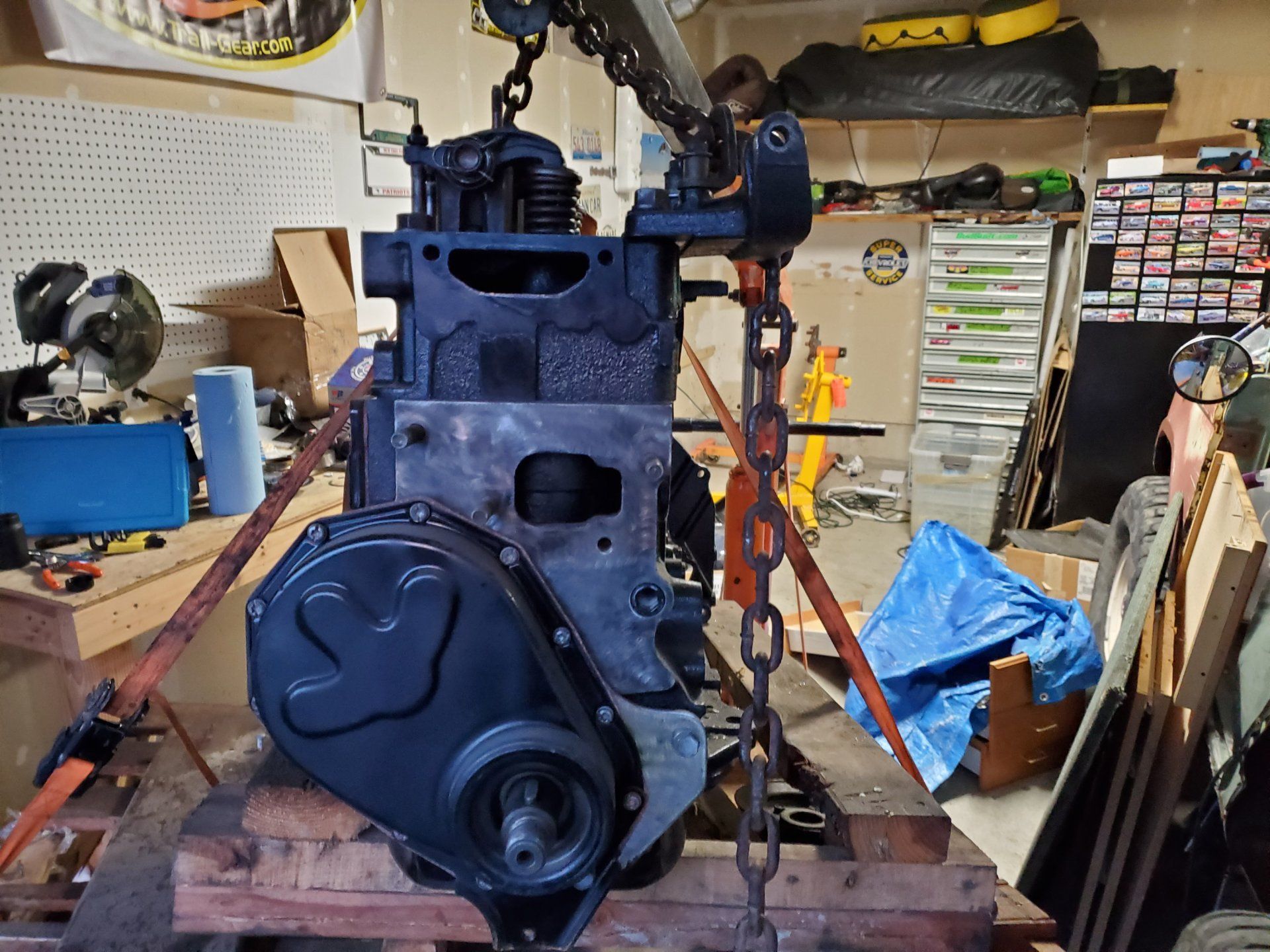

Reason I don't care about the motor in there is I found a rebuilt 3fe about 10 miles from my house. So I picked it up and i'm slowly cleaning and putting on all my spare parts to it.
After the install and break in period i'll put the turbo on . If I don't like it for some reason there is always my 4bt I could put in or an LS swap ;)

I ended up selling the rebuilt 3fe to a local because my buddy @mtweller sold me his awesome 2FE out of his 40 since he was doing a 6.0 swap
However plans changed on that also when we pulled the old 3FE out to do the install I decided to switch gears and go with a V8 swap.

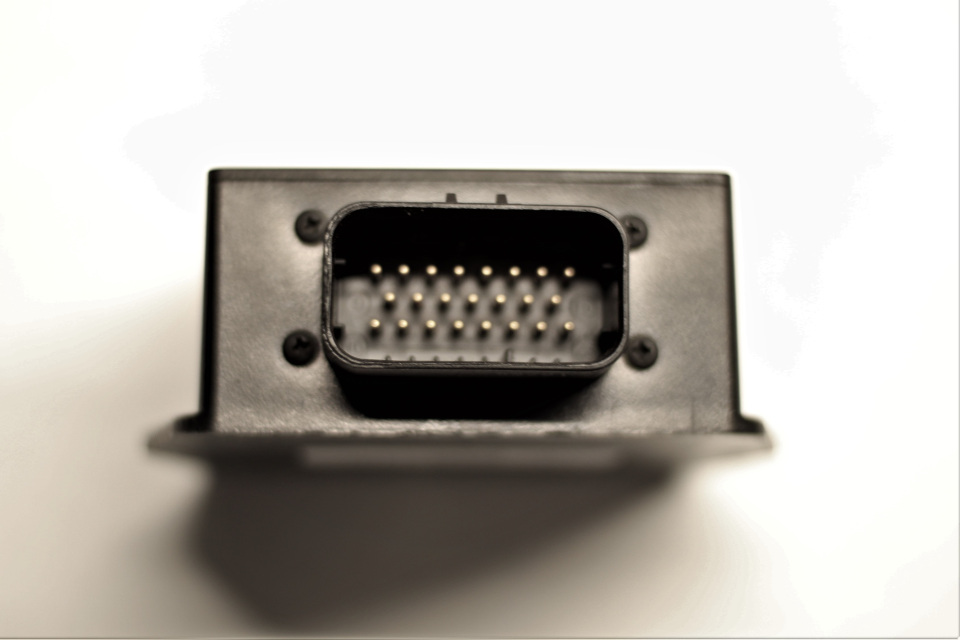

Swaptime Muscle Car Module $450
Swaptime L84 Wiring Harness $750

But the swaptime harness, my HP Tuners module and my tunes and unlocked ecu and tcu arrived. Mitch forgot the muscle car module to add tap to shift so that is on the way.
