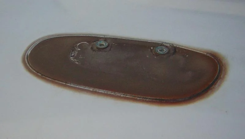

How bad is the rust? I did the clean-up myself.
I used Permatex "Water Pump & Thermostat Housing RTV Silicone Gasket" to plug and seal the holes.
If for whatever crazy reason I want to reinstall the original rack, the holes are still there.
Make sure whatever brand silicone you use it is RTV so it doesn't cause the metal to corrode.
Here are before and after pics of the clean-up (before sealing the holes).
