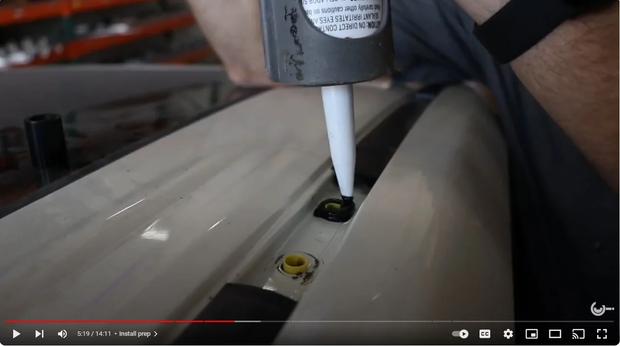

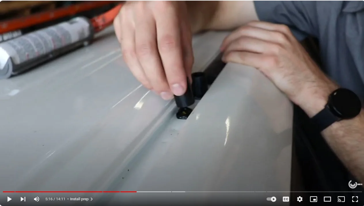

When installing the Prinsu rack, I was hyperfocused on not allowing the bolt insert to fall into the headliner. I used silicone around the insert like the pics below., then pressed the Prinsu spacer on top of it. The seal is waterproof. What I didn't do, like the Prinsu Video mentioned, was put a dab of silicone into the insert where the bolt threads into. Water shouldn't make its way down the threads right? I really don't want to remove those bolts again.. wondering if this is good enough. Truck sits in the garage but I live in the PNW..

Not to be a downer but you know the old saying if it can go wrong ..it will go wrong, especially since you're in PNW not Scottsdale.
I did the same thing….so far so good….. doing both is like belts and suspenders …..
It has been doing fine for the last 2-3 yrs ….but I am in SoCal though….
