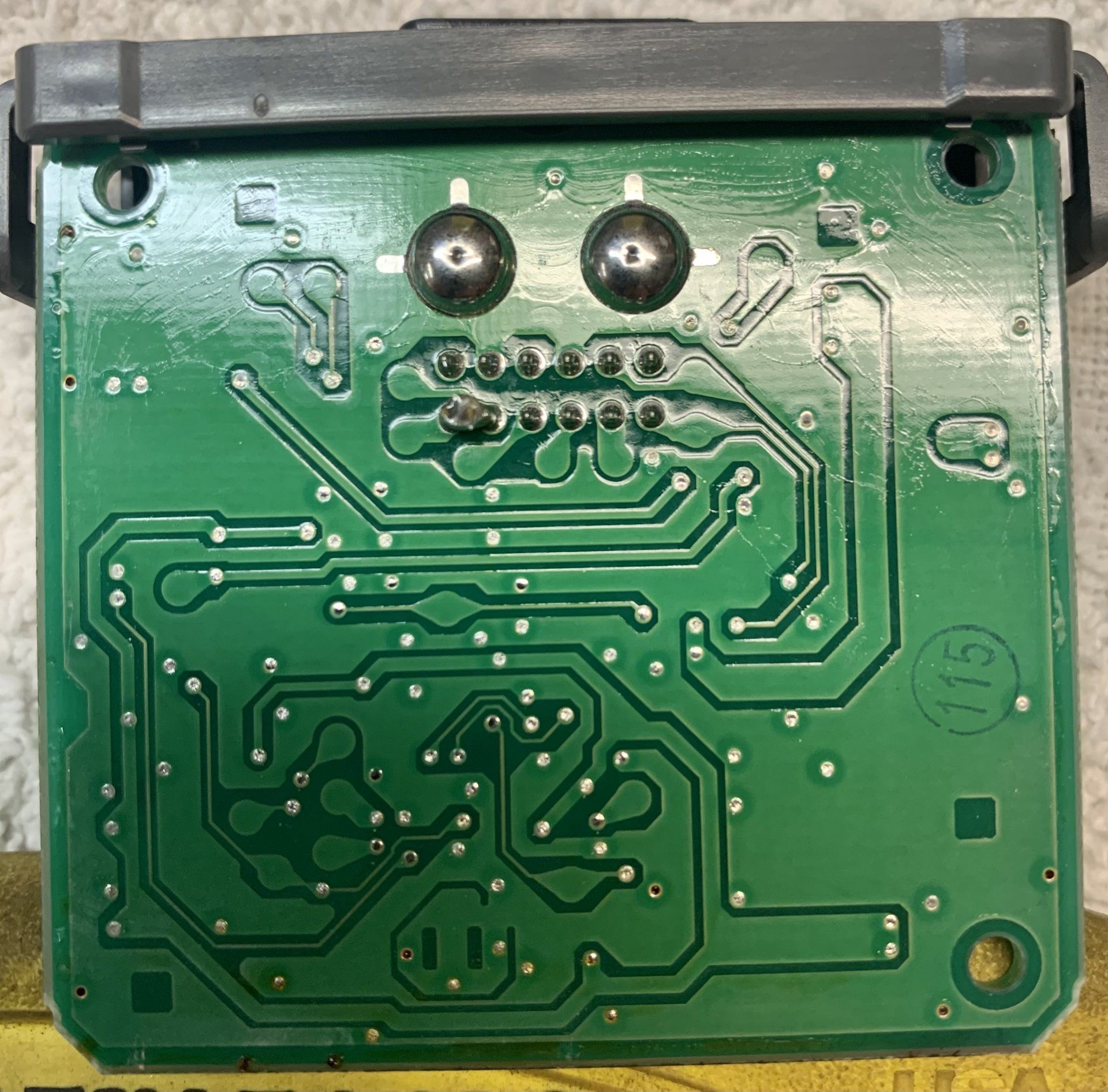

Until I get a rear bumper with a tire carrier or some other solution, I am driving around without a spare (I have a plug kit and a compressor just in case).
Since the computer keeps looking for a 5th tire, I have been living with a low tire pressure idiot light...............
Until now!
Problem fixed with a spot of solder and no more light.
Nice fix. I hate it when I remove my spare occasionally and the light comes on within 50 miles. Getting a proper rear bumper with tire carrier can't come soon enough.

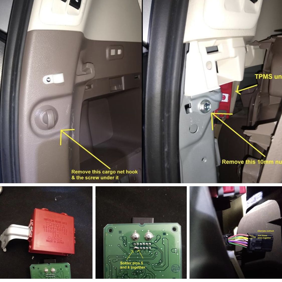

With all due respect, what are we looking at?
Yes, I know it's a PCB, but from where? Where did you pull it from?
With all due respect, what kind of a GX guy are you when you can’t even recognize the circuit board for the TPMS computer?!?!
Nah, I saw reference on the GXOR Facebook page to fix the TPMS light and decided I should do it. You pull the panel loose on the driver’s side rear like you are accessing the sub woofer. Bolted behind that panel is the TPMS computer. You access the circuit board and solder pins 5 and 6 together and ... no more low tire pressure idiot light.
Duh!!! Who'd a thunk!! :rofl:
Seriously, thanks! Didn't even know about that.
Great tip!
