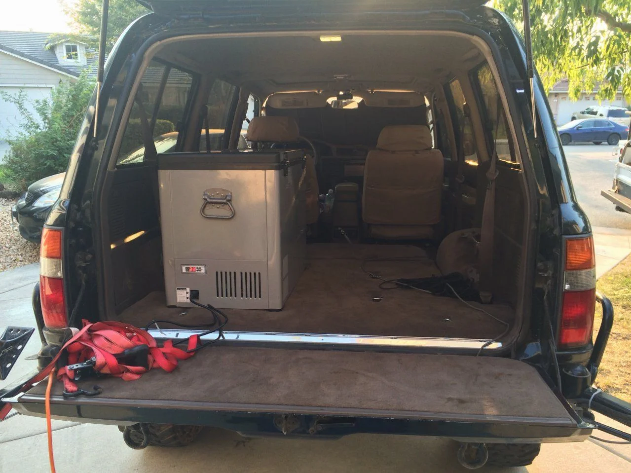

Let's see some pics of that 80qt!
Not the best shot, I was in the middle of loading for my trip. This is positioned as if the second row seats were in. I have it located directly behind the driver seat which will be where it spends most of its time.

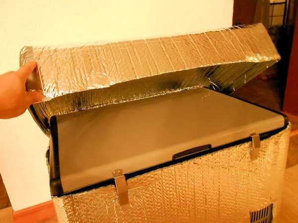

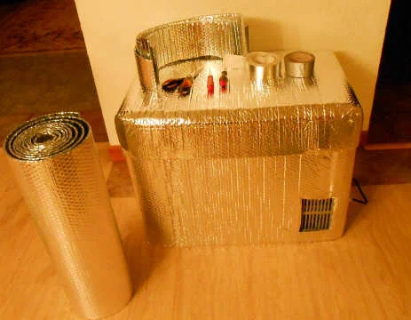

Here's some cladding I created, as going to be on the road for a year (see sig line). Dent on side. colors wonky with flash on & off
edgestar_dent_email.webp covered_fridge_1.webp covered_fridge_2.webp covered_fridge_open4.webp covered_fridge_open5.webp
Nice what did you use double sided tape? 3M?
Didn't. I used alu. type backed sticky foil. What you pickup in Lowes when doing ducting work.

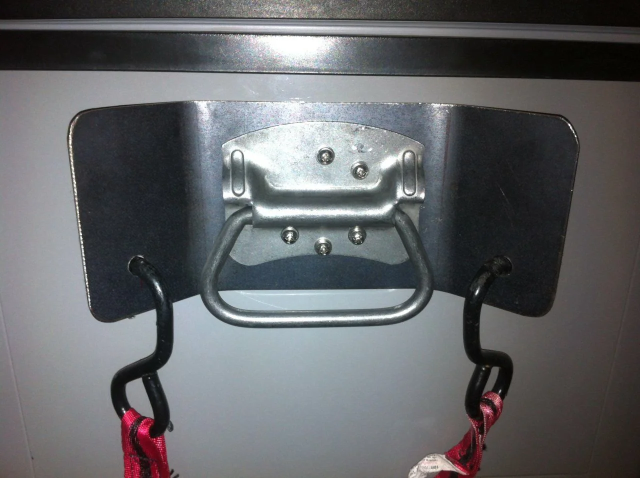

Is anybody selling the tie-down 'brackets' that mount behind, or in place of, the handles? I need a set.
You can make a set pretty easy with some 12ga steel, drill, vise, and a grinder. I wouldn't hesitate to tie down my fridge by the metal handles though.

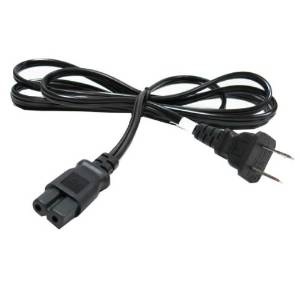

I think I may have found a replacement cord that will work with the edgestar (that doesn't cost $70). I was digging around in my old computer crap and found a 2 pole cord that goes to a laptop charger. The one I have doesn't have a keyed end, and while I think it would work, I'm not going to chance plugging it in the wrong way.
I want to hardwire the cord for my LX and keep the original cigarette lighter cord for my other car. I think this cord from Amazon will work, just have to be sure to make it up to the vehicle side properly since the positive and negative cords aren't colored. For reference, I believe it is a C7 polarized plug end.
http://www.amazon.com/dp/B0017UCTX8/?tag=ihco-20
This graphic in this video has it backwards, but they explain it correctly I believe.
Finally got around to hardwiring the 12v cord for my fridge (which I should have done to being with). It's much improved not having to worry about the "locking" plug and outlet disconnecting when I'm on the road. I empty a tank of gas before I stop sometimes and a hot fridge is irritating.
The above refrenced amazon cord & plug works. Just cut off the 110 plug and make up the ends to the electrical system... Be sure to note the polarity of the fridge.... The cord that came with the fridge is color-coded, so you can use that to determine the + & - .
I needed an additional cord I could hard wire because I want to keep the cigarette style plug for use in my other vehicle.
