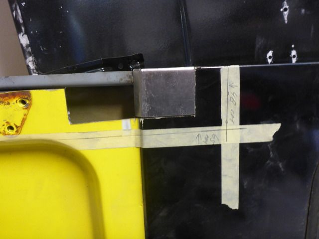

Never done sheetmetal before but bambigirl, gave me quite some pointers while i was there. So I figured what the heck it's only metal:meh:

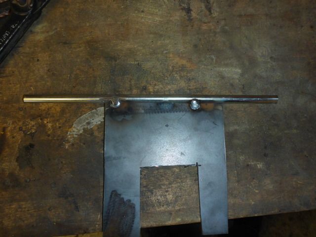

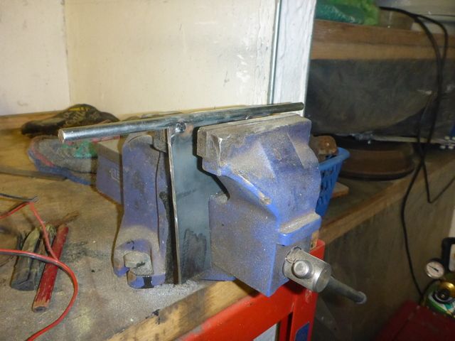

I realy like the radius in the bottom of the door under the door seal. Here's what I came up with to reproduce it
Just clamp the sheetmetal in the vise and hammer away. Just take care to fold the metal in stages, otherwise the you won't just fold it into 90% but it will start to arc in the other plane as well
I got the inside of the door done. Tomorrow i'll start on the outside panel
here's where I am so far

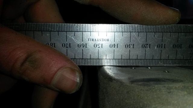

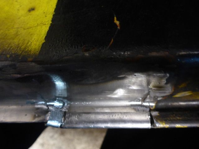

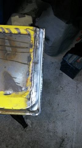

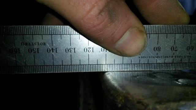

I thought and long and hard about how to tackle the doorskin. I like things to look as original as possible after I'm done with em. The main issue with the doorskin being the folded over part on the inside. I WANT IT FOLDED OVER i guess i'm just nerdy that way. Anyway if all panels are 1.6mm thick, it looks like mister toyota at least thinned the lip that folds to the inside. I tried to keep it at 1.5mm thickness because that's the how thick my sheet is just for a test, but I think i'm going to keep it like this. What do guys think?

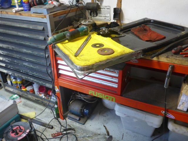

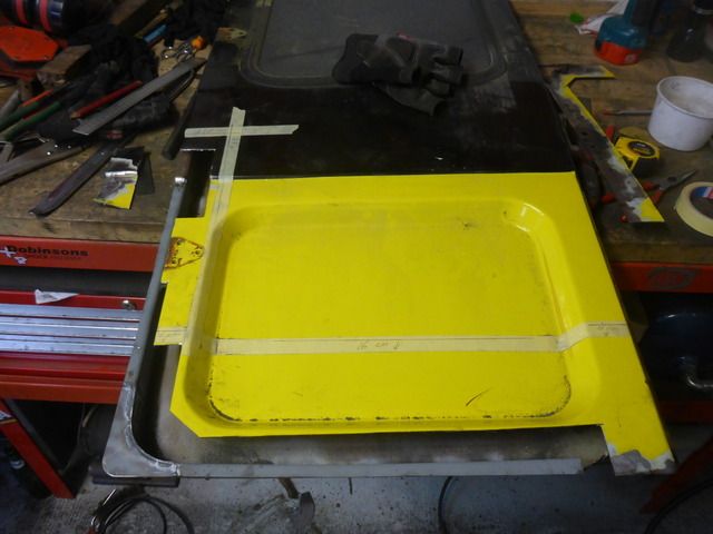

Next was the question whether or not to try to make 1 or 2 large panels, or make several smaller ones. In the end I opted for making a couple of smaller ones just to keep it manageable. The downside is that on the lip that folds over you get a couple more welds. Maybe when I get a bit better and my confidence grows, I'll start making bigger panels
OW.. and mark the distance to the edges before you cut them off. In this instance, it wouldn't have been the end of world but if you cut the inside and outside panel at same time, you're pretty well f :censor:ed
the cut:

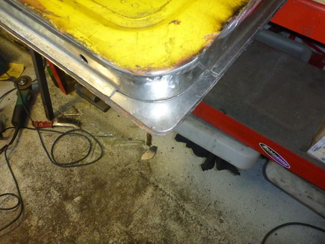

The first of the smaller panels:
The folded over lip:
You can see where the new part begins, because of the total thickness of the door. The inside look alright though. I just hope that the extra thickness won't bite me in the end with new weatherseals installed

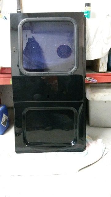

First ambu door finished. Still a rattle can paintjob for now...

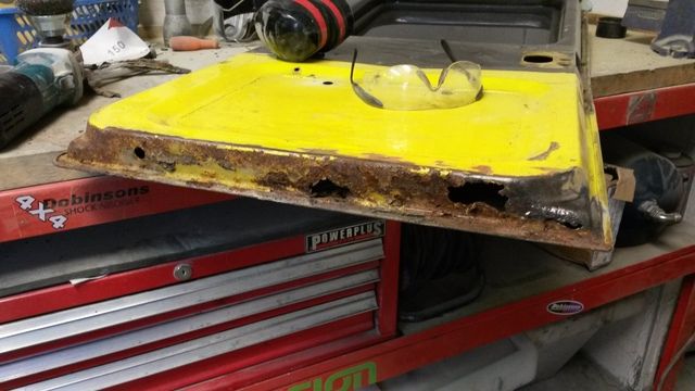

Started on the second door. Again found more PO:censor:
door skin on the bottom hinge was rusted trough, so off course you just arc weld the door skin to the reinforcement plate thereby warping the door and just glass over everything
and some more rust:

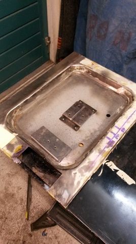

replaced all PO repairs and welded in new sheet. Including the recessed center panel because someone tried to hamer a dent with a BFH stretching the panel so bad it was bulging out about 1/2 inch

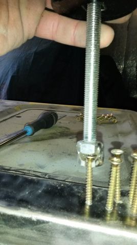

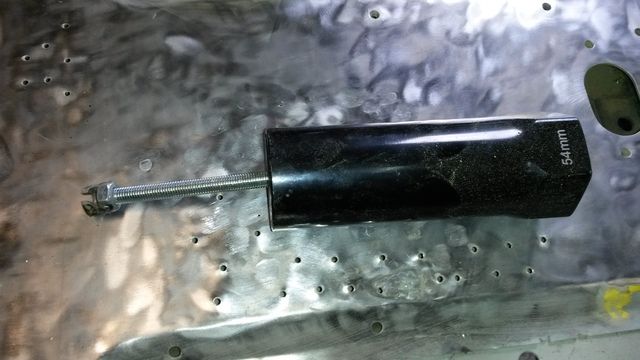

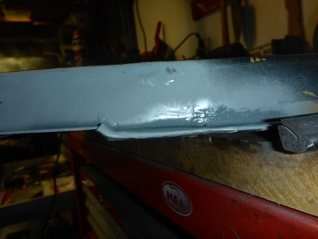

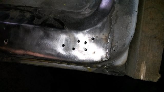

improved a little on my dent removal process and found a 2nd use for the 54mm hubnut socket
small dent
drill holes
insert screws
used the home made sliding hammer to gently pull out the dent
and dent is gone:grinpimp:

What and how happens to the little holes?

the holes I just weld up again.

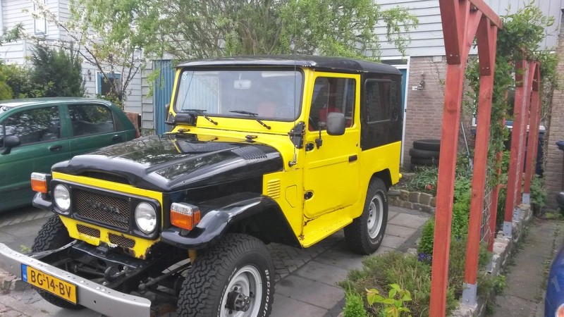

acc to the :princess:, the truck resembles this.................:bang::bang:

You have got it back together . Does it Go ?
Love the colour ?
I agree with little princess !
