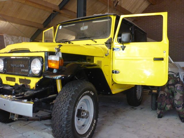

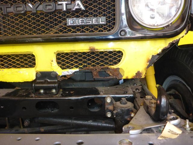

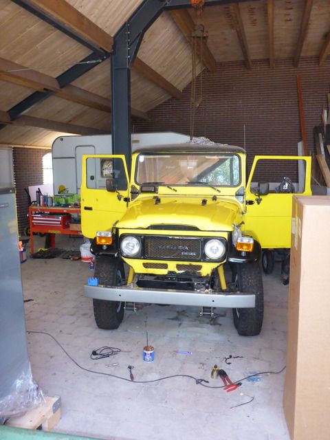

Finally ready for the yearly inspection:bounce::bounce:Dang this is exiting. I got the fender and aprons installed. Not to unhappy with the fitment. I wonder how it's going to be with the new grille and bonnet.
Don't really know what (if anything) I'm going to to with the LH indicator drooping to the left... It looks to me that the entire LH fender is sagging a bit
I think I'm keeping the old grille to see if i can repair it over the winter. Just to keep idle hands busy:rolleyes:

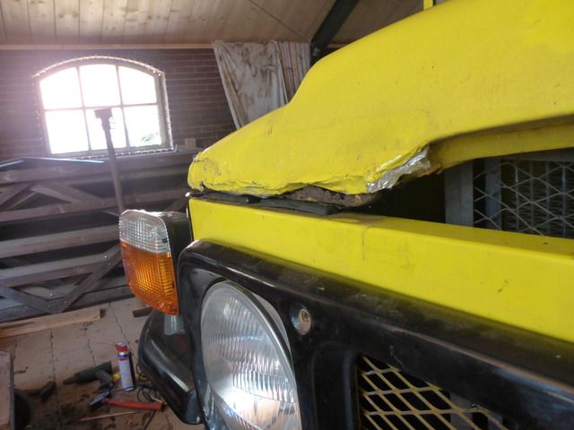

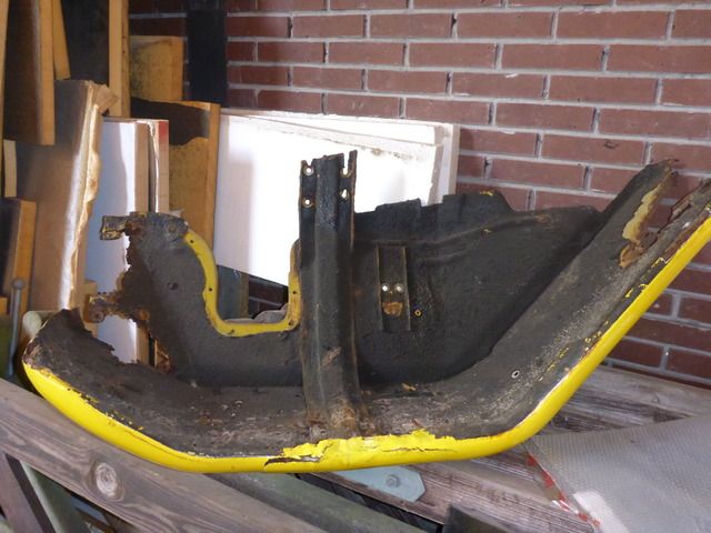

The damage does far exceed how it looks in the picture.
And to justify replacing the bonnet..
If you guys are wondering.... YES..that's yellow painted tape that is keeping the entire front RH corner together. Or to be more precise... The entire front is just tape painted yellow:cool:
And just one more to show the horror

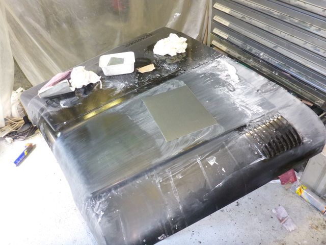

Did have a sleight mishap painting the bonnet though.....:censor:
If you ever wondered what orangepeal looks like.. this is it.
I had the adjustments of the paint gun wayyyyy wrong. It was like shooting paint with a garden hose:bang:
To fix it, I opted to just apply more clearcoat, then sand it down again. It's one hell of a job but taking all paint off and starting over would take just as much time and more paint. Still working on it. It's a :censor: trying to keep from sanding through the clearcoat.

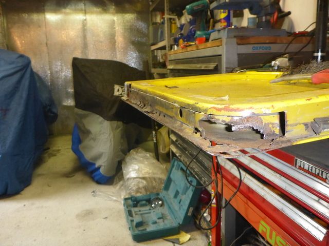

Next time i will NOT forget to take a pic of the seamsealed bottom side of the hood
Hi
Your back. And with lots of photos.
Lot of patches needed there. Think you need a lend of my folder.
What do you put all the rust down to?
I am well into the sanding of mine and so far no rust and very little dents. The result will be panels with little or no bog.
Before I brought my 40 series I must have looked at 100 or more cars and most had rust or bog. When I first saw Bambi the owner wanted $3000.00 over market price but I knew I would pick this up on the body repairs.

@Bambi Girl : I would like to put it down to a technical issues like a too small compressor which caused variation in pressure during painting and painting in a too small booth. But honestly.. I was too exited and didn't take the time to properly adjust the gun after it's last cleaning. And had the paint volume wayy too high.
From the pics, it looks like you got a nice coat. Hope the tips helped.
The reason for all the rust is just the climate. Rust really loves Holland. If it's not raining, it either just stopped or it's about to start:doh:. Plus the PO lived by the sea, so that doesn't help. And finally, the last refurb the sponge got was a bodge job. NO new metal just glassfiber over rust, apply 1/2 inch bondo and away you go...:bang:.
During the winter I'll sandblast the doors and post before and after pics. I can only dream of bodypanels as straight as yours seem to be. I CAN NOT believe the condition of your grille. I was at my belgian friend 2 weeks ago. I saw 16..yes 16!! grilles and we found 1!!! that was repairable. The other 15 were too shot to even start on:crybaby:
Looks you found a nice way to get the paint off, without being to aggressive. I think you're going to love the rotisserie.
@Ken White : the orange peel is the issue. The matte part is where i started sanding it down. I started off with 240 grid. then 400, 800. Now up to 800 then 1200 and last 2000. Then polish... So just another 20 hours of sanding left:deadhorse:

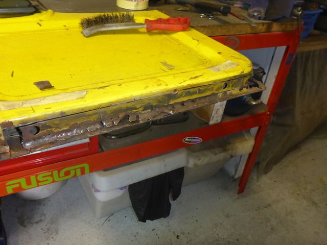

I just started chasing rustmonsters on the sponge. I decided to start with LH ambu-door.
Here is why
All this can be done with the most basic tooling. A vise, an anglegrinder, a BFH and of course a welder
