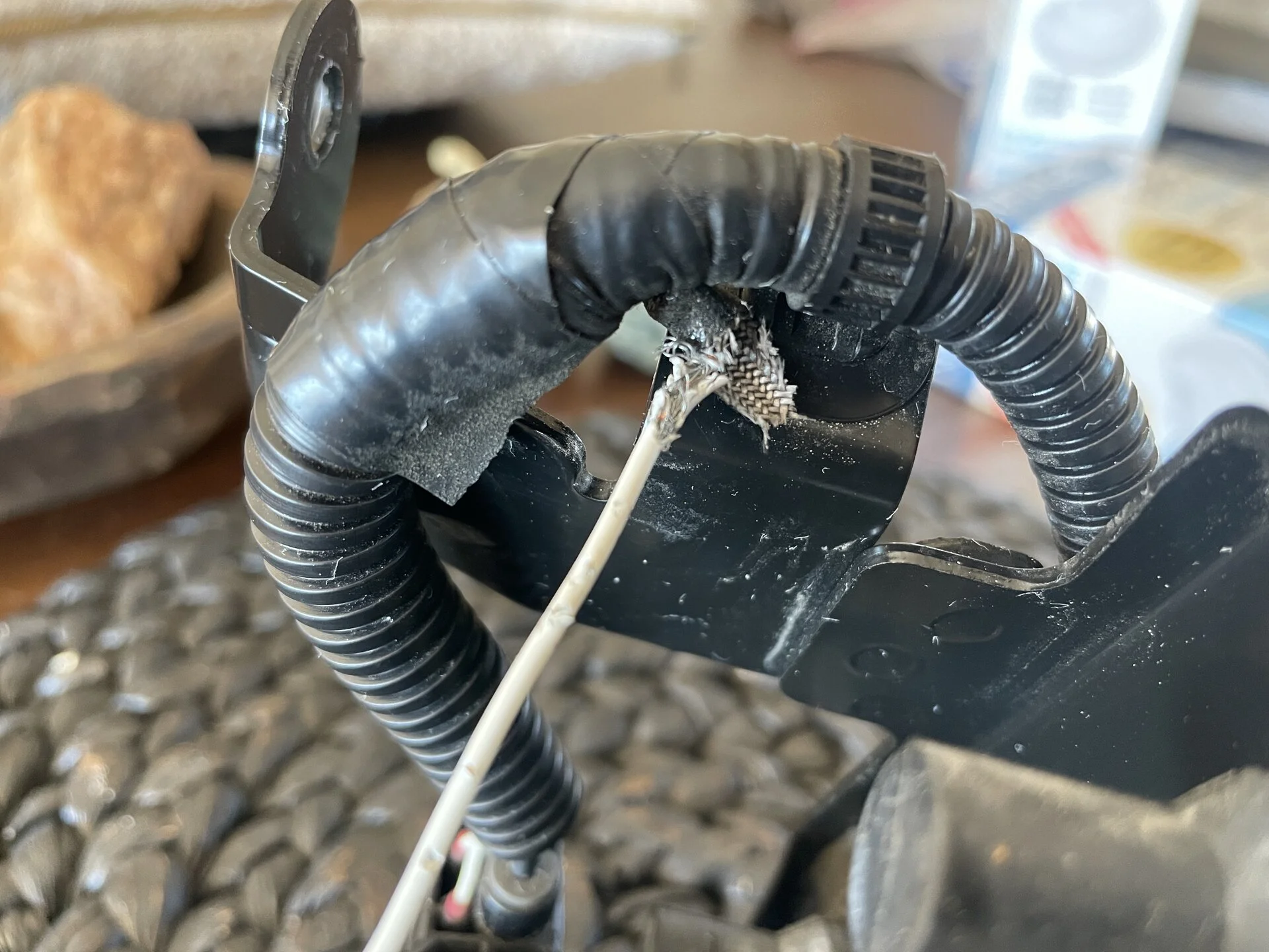

Rodent damage to my 2017 460. Help identifying small chewed wire, please. :(

I think it might be possible to splice but I can’t see the underside of the pump without removing it. If it’s just a couple bolts I could take it out and give splicing it a go. I do have some coupling connectors handy and the right electrical pliers. Is the pump tricky to remove?
If you go here: GX 460 Manuals
there is a factory repair manual that you can download. Albeit, it's not really a download. It downloads all the PDF's but it works off of HTML website, but it does work and will show you all that's involved removing it.
Or this may be simpler:

As for my particular issue here, I pulled the secondary air pump. It was three bolts on the mount, one hose, and a simple electric plug. So I managed to remove the pump without any drama. Cleaned up the mess all around it, and am waiting on a new pump. Lexus in Reno wanted $714 just for the part, not including any labor. Found it online for $470 shipped, so went that route. Should be arriving at the end of the week so I'll update again once I (hopefully) get it replaced.
Someone with better wiring skills that I could have repaired the damage, I'm sure. But the rats chewed up the split off sheathed wire (two small white wires in a smaller "harness" that splits off from the larger one), and the other side of it too. Leaving a lot of what looked to be potential issues down the road so I just bit the bullet and ordered a new pump.
