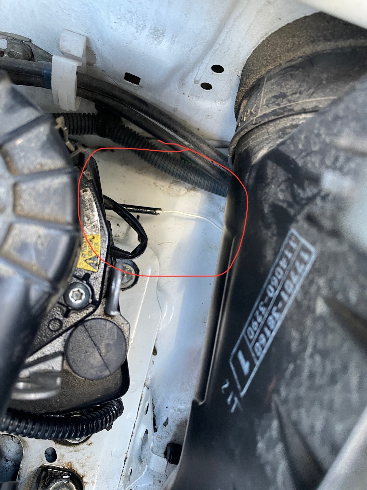

Hello Good People,
It's been a long time since I've poked around on the forum. It's only because I haven't changed anything on my GX since the collective wisdom here steered me in the right direction (still very appreciative!).
Living super rural these days and this year in northern NV has been pretty wet. So it seems the rodent population has exploded and along with it... ugh. Damage. After cleaning out a large nest and inspecting for trouble, I found this very small diameter chewed wire hanging free near the windshield washer pump. Emailed the folks at Lexus in Reno and they asked if my headlight squirter and windshield wiper pumps still worked, and they do. So not sure what this wire does at this point. Would anybody happen to know? Many thanks in advance!

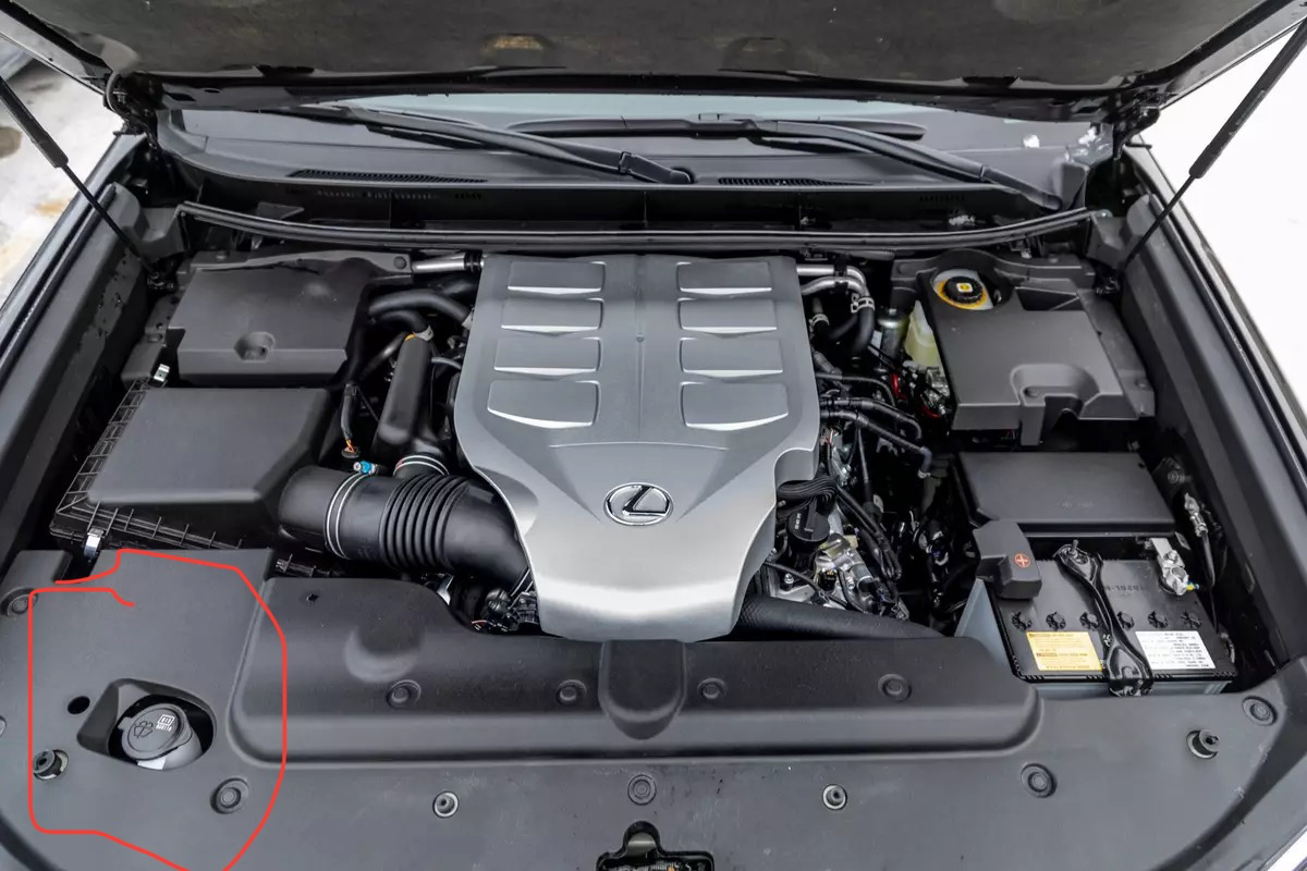

Thank you for the reply. I'm grateful. As for where it is, it's next to the air intake that goes to the air box. I removed the cover to get my paws in there. (pic stolen from the web for time's sake).

Is it part of that wire to the secondary air injection pump? That is what it looks like to me. Here is a pic of mine right now. Different angle. The wire comes out of the upper section and wraps down slightly with a ziptie/strap and then joins the harness with the loom below the filter on the air injection unit. Hope this makes sense.

I am positive that is the wire. There are no other wires near there. It is same size and everything.
Just got some more pics. I apologize for taking so long to give more info.
It’s a small rubberized outer sleeve white wire coming out of this component.

HVLA, you nailed it. Probably a dumb question, but do I risk even bigger problems driving the GX with this wire detached? The dealership is over sixty miles away. Perhaps a low skill person such as myself could replace this part? Or bad idea?
I think on the Lexus the air pump only runs during a cold start. It helps the catalytic converter get up to temp faster. If it doesn't throw a code it's probably ok to run it some. Over a long time it might cause clogged catalytic converters or other problems.
If you can find both ends of the wire and there's some slack you can splice it with a butt connector. It might be a little tricky with a wire that small.

I think it might be possible to splice but I can’t see the underside of the pump without removing it. If it’s just a couple bolts I could take it out and give splicing it a go. I do have some coupling connectors handy and the right electrical pliers. Is the pump tricky to remove?
