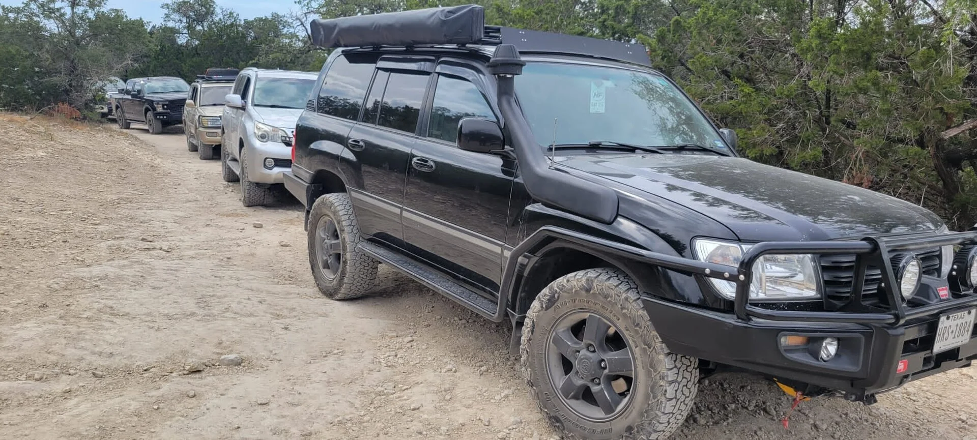

Pic for attention 😉

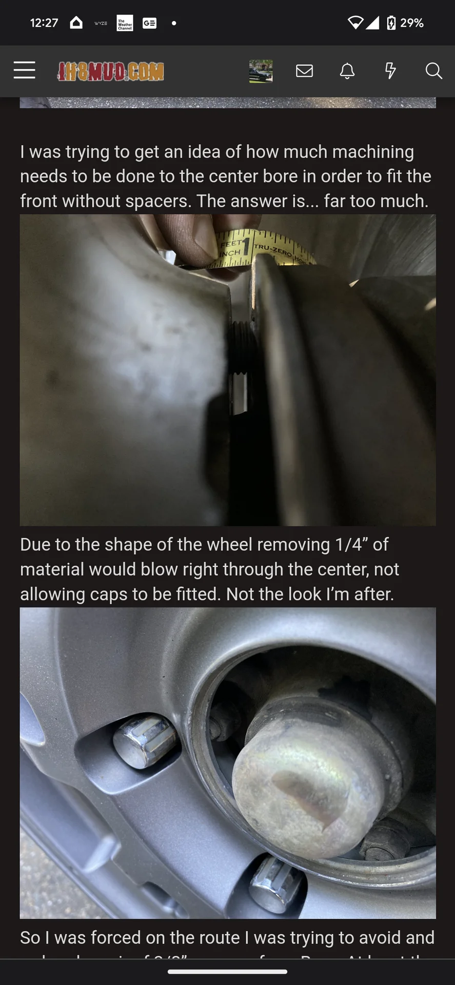

Where did you see these other threads? Will you cut the center of the wheels out and run without caps?
I’m using the minimum 1/4” slip on spacer (still plenty of thread engagement) for an effective offset of +44 along with domed caps. I would consider machining the wheels if it didn’t cut the whole middle out but I don’t think there is enough meat there.

You posted it here the same My Rock Warrior Wheel Project - https://forum.ih8mud.com/threads/my-rock-warrior-wheel-project.1210727/#post-13256823

I like to avoid spacers altogether for a peace of mind. I thought RWs compatible without spacers but it's not.
Well, 1/4 inch spacer compared 1.25 inch spacer is a totally different thing. 1/4 is a real spacer but 1.25 is an adapter actually.
I run spacers to put the tires just outside the fender. Besides looking good, they protect the fenders from trail rash.
If getting RW's is about having that big offset look (without spacers) you have right now you're going to be disappointed.
Look at the math. Your stock wheels have a +60 offset. 1.25" (32mm) spacers makes that into a +28 offset. Your tires are 10mm wider (5mm on each side of the wheel), so 32+5= 37mm, which means the outside edge of your current tires are about 1 1/2" out from stock.
RW's have a +50 offset. Minimum 1/4" spacer makes that into a +44, only 16mm more than stock. Add that same 285 width tire and you get 21mm which is less than 7/8" out from stock.
