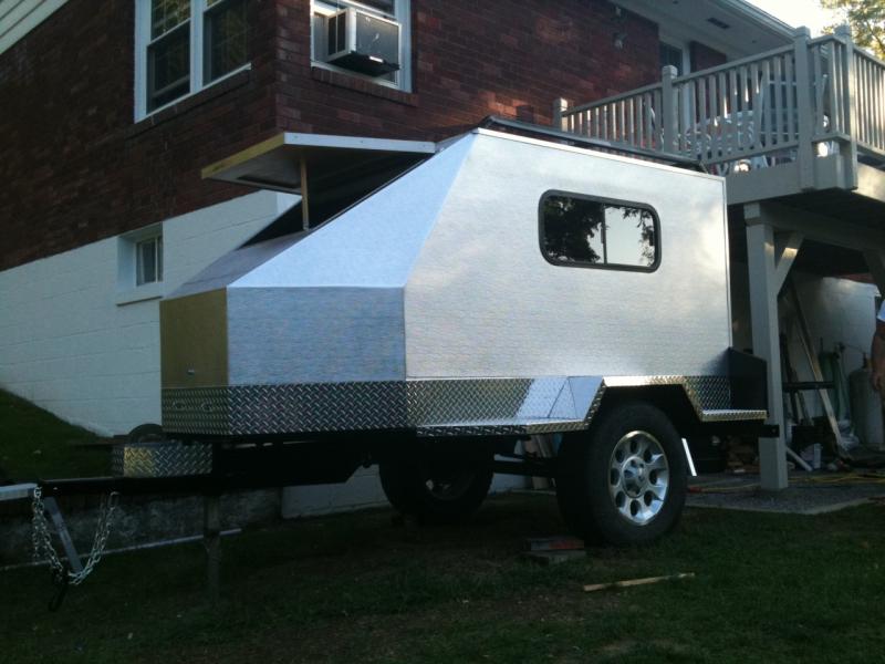

Here is a few with the back doors FINALLY trimmed, hinged and completed..and all the other aluminum trim is also done. Halle-friggin-lujah!!
Paint tomorrow!

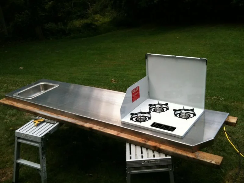

Threw one in the there of the kitchen top framed too...:beer:
when this is done i may have to drive up an see it in person!
What stove is that?

What stove is that?
I got it from Koffer out of a relativly new pop up he bought that was wrecked. He refers to it as "the Donor Trailer"...lol. He's using stuff out of it for his build as well.

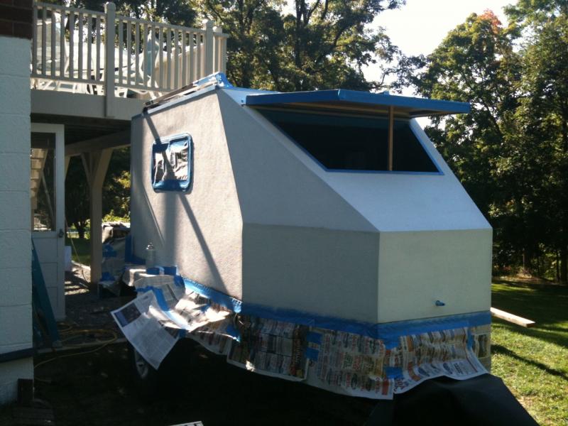

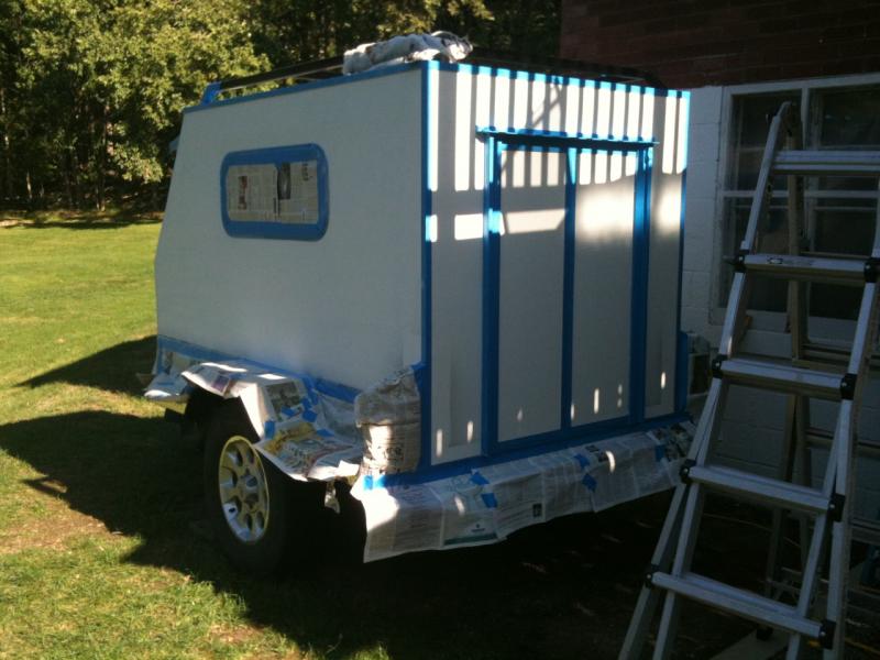

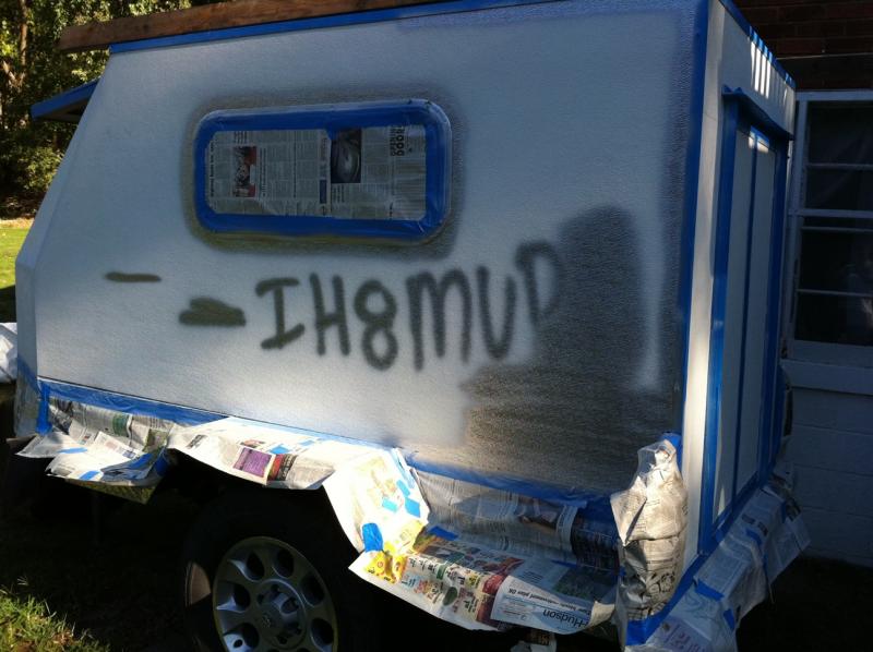

Overspray is NOT our friend!!
That's right boys and girls.....check back in a little bit to see the Silver Bullet
Hey!!
She's Silver!!
My nephew John came over to help tape off..what a huge help!!
We got her sprayed and stripped in record time!
:p

Do you have to prime the FRP or just use silver over the raw FRP? I've only seen the FRP with a slick finish and have no experience with painting it. Being able top pick some color other than gloss white makes it a more appealing material to work with.
Mike,
I used a Rustoleum Plastic Primer...believe it not I did the whole thing with one spray can :eek:
I did sand it with 80 grit on the random orbital, then wiped it down with thinners.
The top coat is also Rustoleum Silver...matches the 4runner close enough!
Of course at this stage, any silver would work....:lol:
