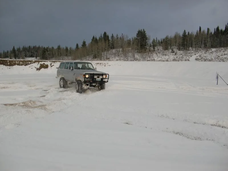

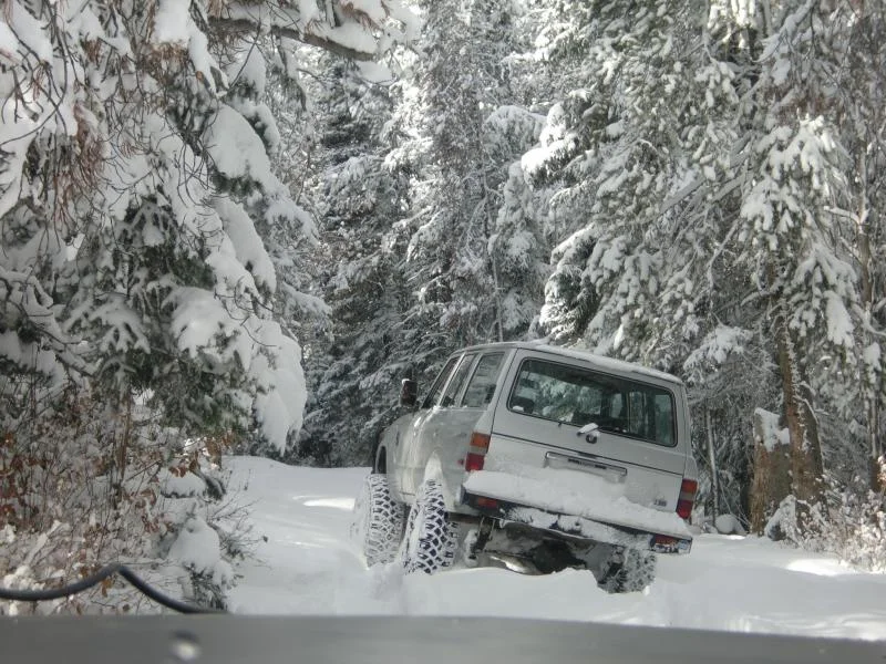

Great day of wheeling here in Wyoming, again!! :D

Only carnage of the day was a broken ARB line on my buddy's rear axle. He had it fixed in about 10mins. The Cruiser performed flawless all day! :cool:
