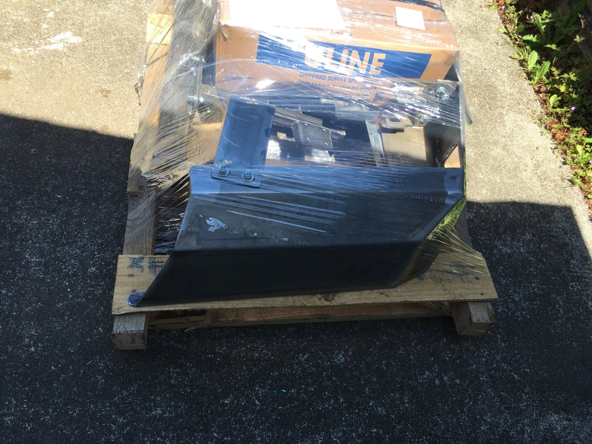

My bumper shipped today! I've decided on a DIY water based truck bed liner for $30/qt. I think one quart will do it. Thanks @GeorgeN for the bolt info, I'll pick up those extra bolts before I get started, and I need to order in my lights too.

Since I ordered a sixplug and then bought 7 conductor wire, I just ordered some more 8 plugs. My lights and double bed liner came in, hoping the bumper will follow.
