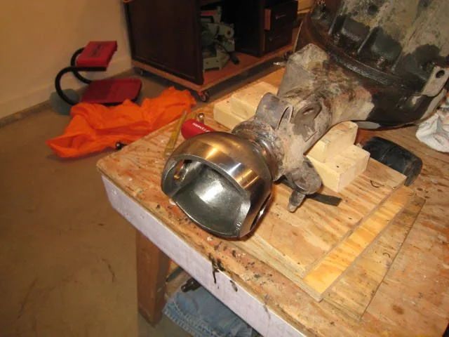

Got the '76 axle on the bench; starting the teardown.

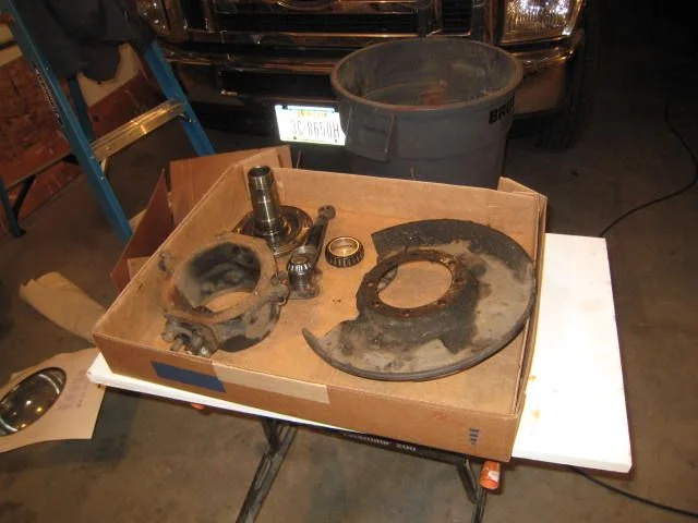

The front rotors have to go in to be checked and turned. Same time, they are gonna hot tank my knuckles, backers, and other junk.
Here's the stuff, in the box, ready to go.

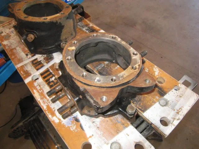

More pics of the tear down

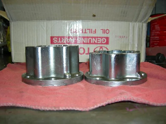

Here's a pic showing the difference between the long and the short body Aisin (or Asco) hubs. If you have the short body, it'd be easier to swap the outer axle (as Poser said above) to the later style instead of keeping the Selectros. The Aisin's not only are much stronger, but look better too. ;)

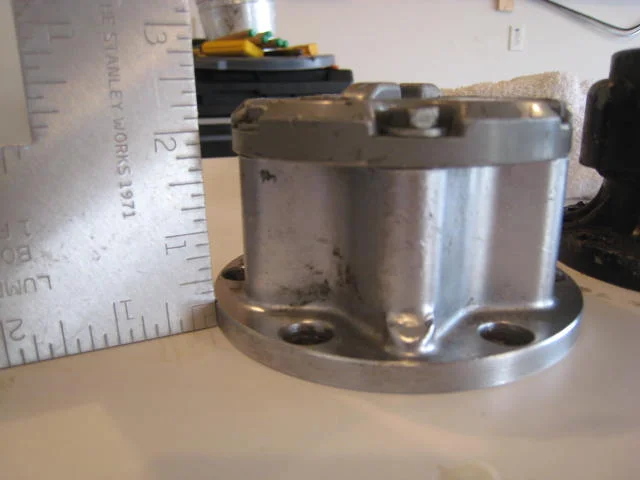

Here is a pic of the Selectro next to the Aisin. It don't look like I can use my Aisins on this axle w/o switching out the ends.
The Aisin body is right around 1-3/4" long.

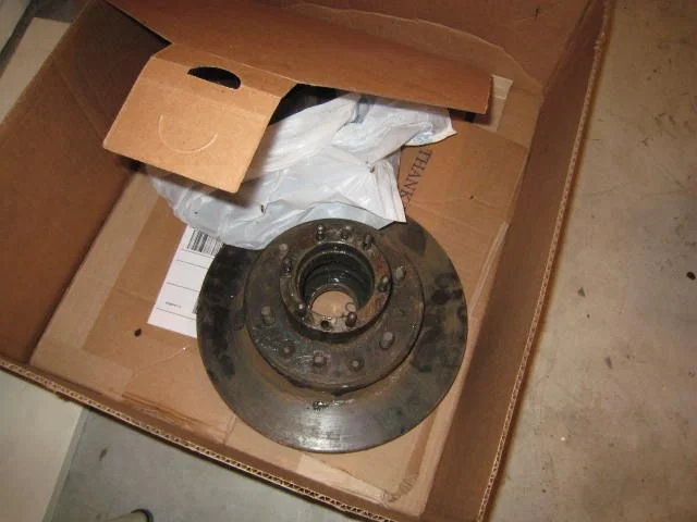

I brought the end parts (knuckles, backers, steering arms, rotors) in and had 'em cleaned up. The brake shop says the rotors are not usable. Too thin. I ordered up some new ones. They'll be in next week. In the meanwhile, I'll go ahead and start getting the knuckles and backers painted.

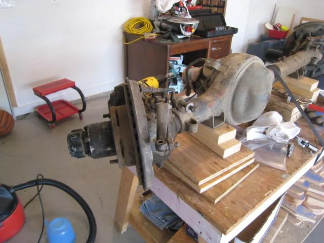

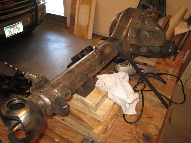

I took the axle body down to the car wash and worked it over with soap and water and a high pressure wand. Then, I plopped it on the work bench and went over it with a wire wheel. It still has some gumpta in some of the crevices. I have a ways to go with it. I was thinking rattle can primer and paint; nothing fancy, basic black. Here's the mostly cleaned up axle body:
Were you going to remove the differential and clean/inspect that, or just replace the pinion seal?
It looks a little damp around the companion flange area....
:meh:
Before painting, I was thinking I'd do a wipe down with denatured alcohol or mineral spirits or something. Is that a reasonable thing to do?
