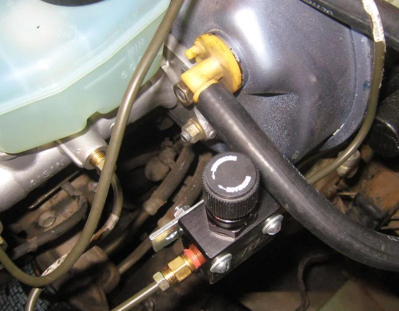

Have a look at the last pic. It shows the prop valve. Turning the knob one way is increase, the other way is decrease. Question is, if the rear brakes are locking, should I increase or decrease?

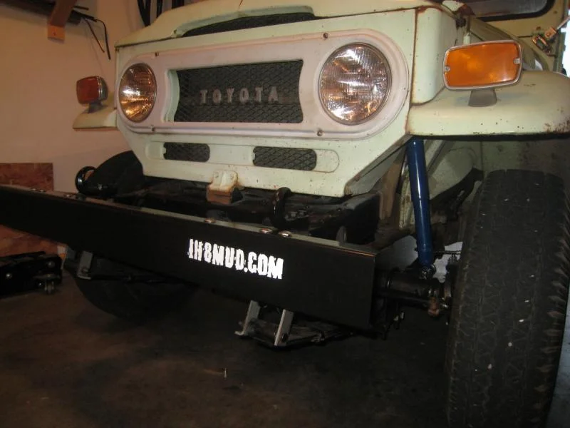

The first pic shows my new JTO front bumper!

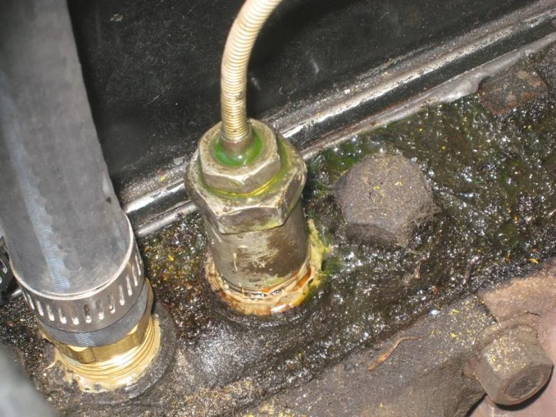

Here's a coolant leak I found this evening right at the temp sender:

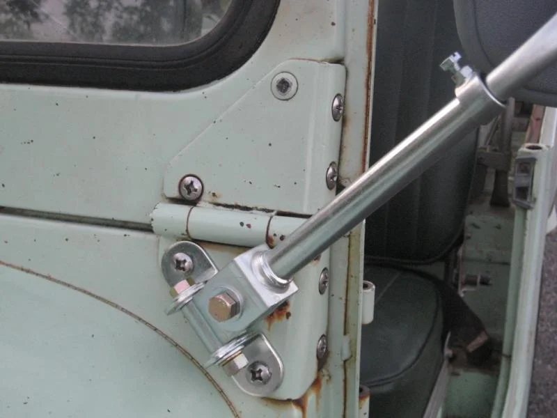

Not brakes, but somewhat related. I have my '40 top & doors off, so I needed new side view mirrors. Got the cheapie CCOT units, along with their stainless windshield hinge screws. Replaced 15 of my 16 screws. Look at that one here in this pic, he WILL NOT come out! I'd swear he's laughing at me. :)

Added a MUD sticker!
