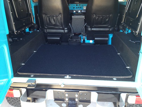

As for the personal preference aspect of bed liner, I think it's great if it's color-matched for two reasons:
-Anyone who has owned a black car knows that they only look clean right after being washed. I imagine that black bedliner always makes your interior look dirty.
-Color-matched bedliner doesn't stand out as much. If done well, most would not even notice it. This way, you get the benefits of durability without the drawbacks of the aesthetics (which again is my personal opinion).

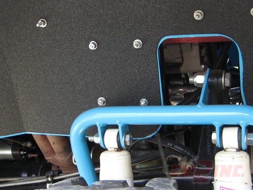

Ironically, I found this thread the day I ordered a Raptor kit. NBD, my truck is not for sale anyway.
Exactly, do it for yourself, not resale. I ordered the raptor kit as well, planning on doing the underside and the bottom of the inside. There are a lot of people that dislike it, but there are also a lot of people that dislike the color I chose, the wheels and tires I run, my seats, etc... can't please everyone! :beer:
