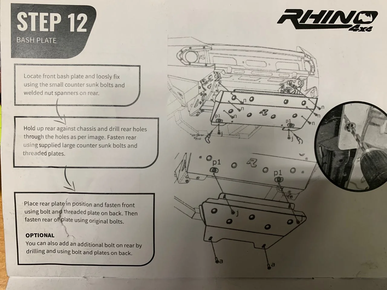

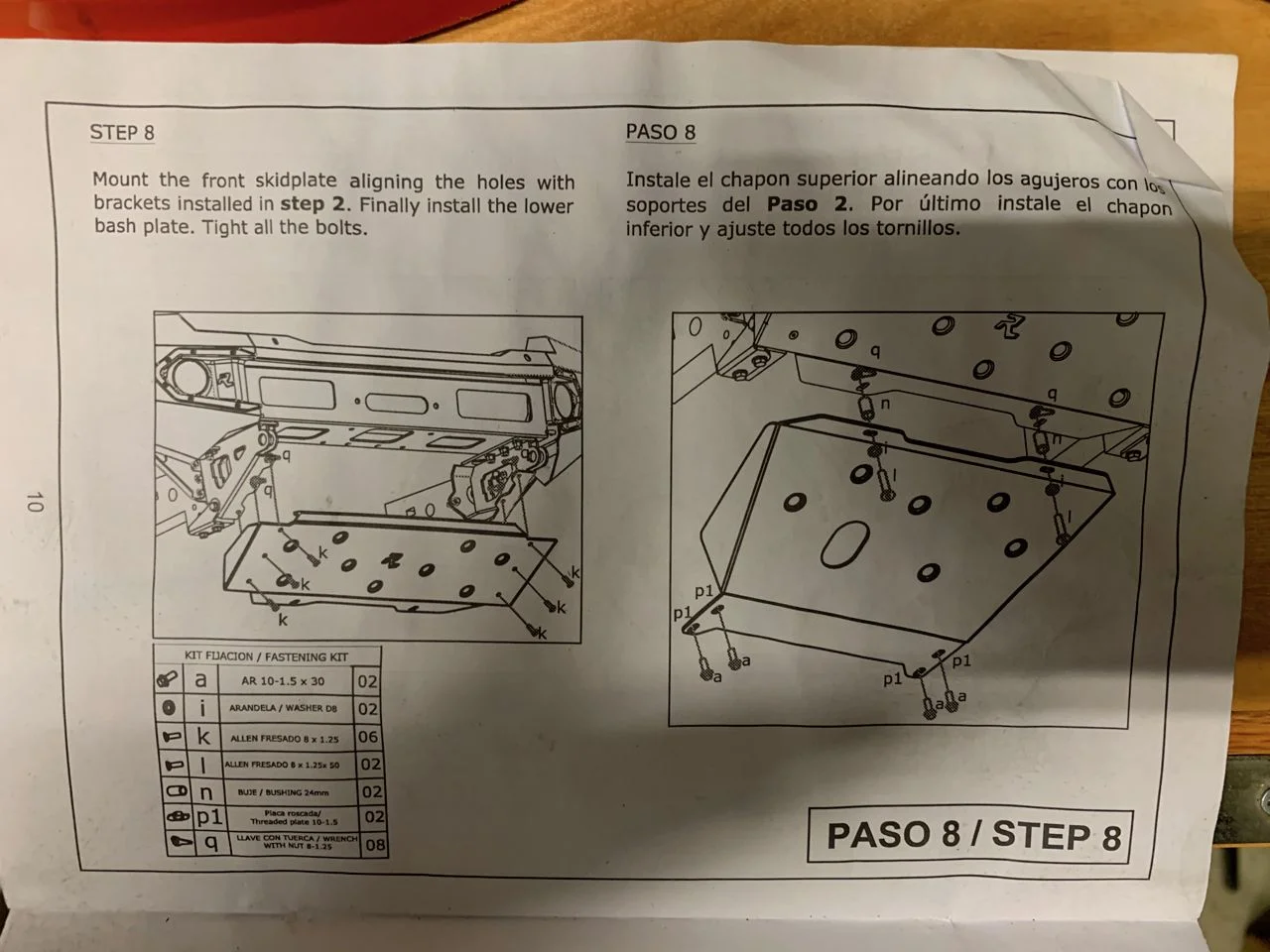

I received two manuals. The original and another for the facelift. I found myself going back and forth on the manuals. There are two pieces that go in to the frame chassis that connect to long bolts. I couldn't make any sense out of the photo in the manual. Called Rhino and spoke to Ben. He got me on track. He said don't drop the piece in the frame, of course I did and that was not a fun fishing event. BTW - Ben sent me another manual that was different than the two I received. I had to reference all three and decide what was valid for my parts.

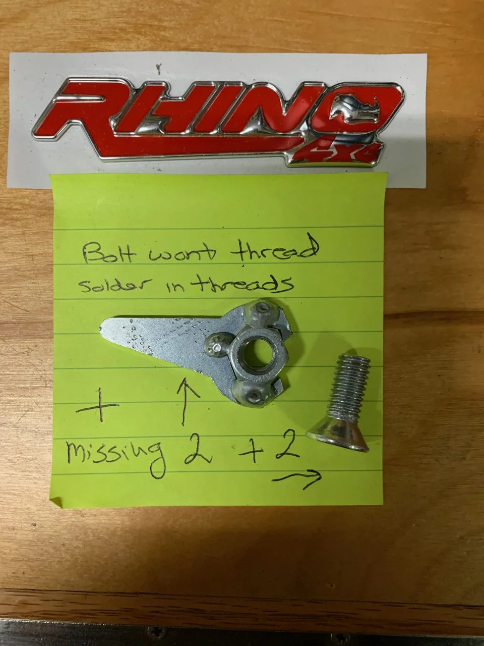

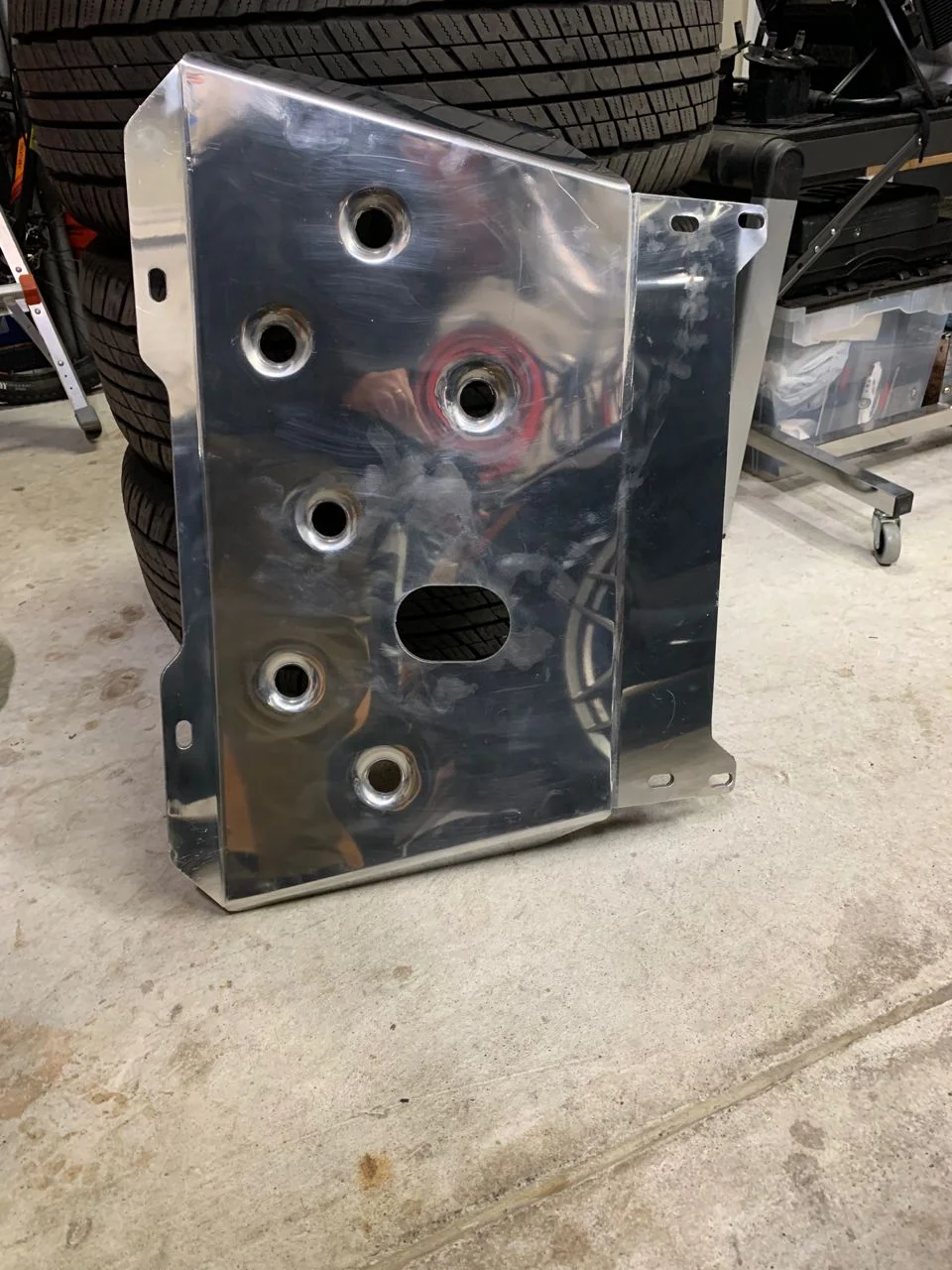

See images. These are for the skid plates. I do have the upper one on. I would go t o a big box store and buy but I don't think they sell these wrench nuts.
FWIW I recall having trouble with the skid plate install and those wrench nuts. Fortunately I had a plethora of random bolts, nuts, etc. handy to find something to make it work, but your experience is not unique. I had completely forgotten about that until I saw your pics!

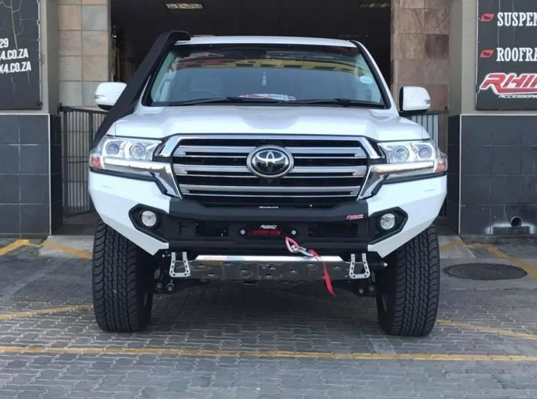

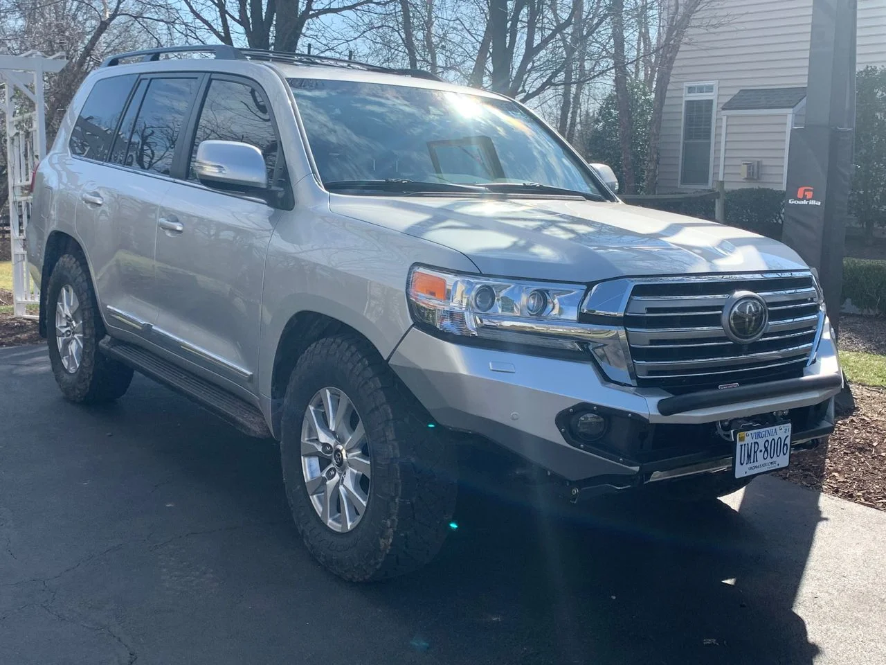

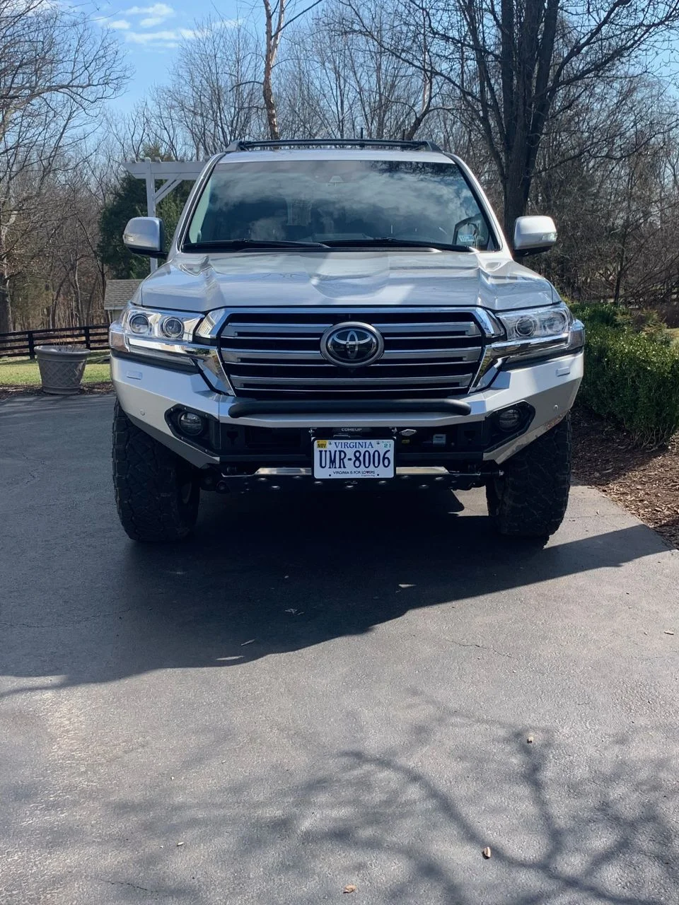

Got the bumper finally installed. For those doing paint, make sure and unwrap all your parts. I assumed only the wings needed paint. After getting them back from being painted, I unwrapped another part which was the center top piece and it was white! I figured it would be black like the winch cradle and lower middle. That set me back a few days. I had four paint quotes from $400-$1800. I settled on the lower end and it's not a perfect match but I really don't care and it sets the bumper apart. I need to get PPF applied.
My truck has the OEM suspension. The added weight includes ARB dual compressor, aux battery, Comeup Seal Gen 2 12.5 winch and this bumper. I will most likely add OME BP-51 as the next upgrade, after getting my Bud Built sliders delivered/installed. I don't know if I will keep the light bar on or not. I'm going with a light bar on the factory rack - also waiting for that to be delivered.

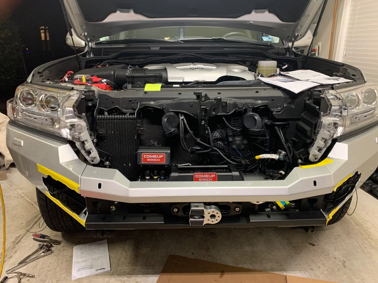

I'll share more photos of the install later and some tips. Missing some bolts and specialty nuts so have not installed the lower skid plate. Have reached out to Rhino 4x4.
That looks great!
Where did you end up putting the solenoid for the winch? Also, what fairlead and shackle did you use? What was your total install time?

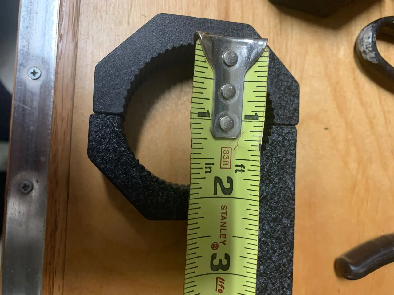

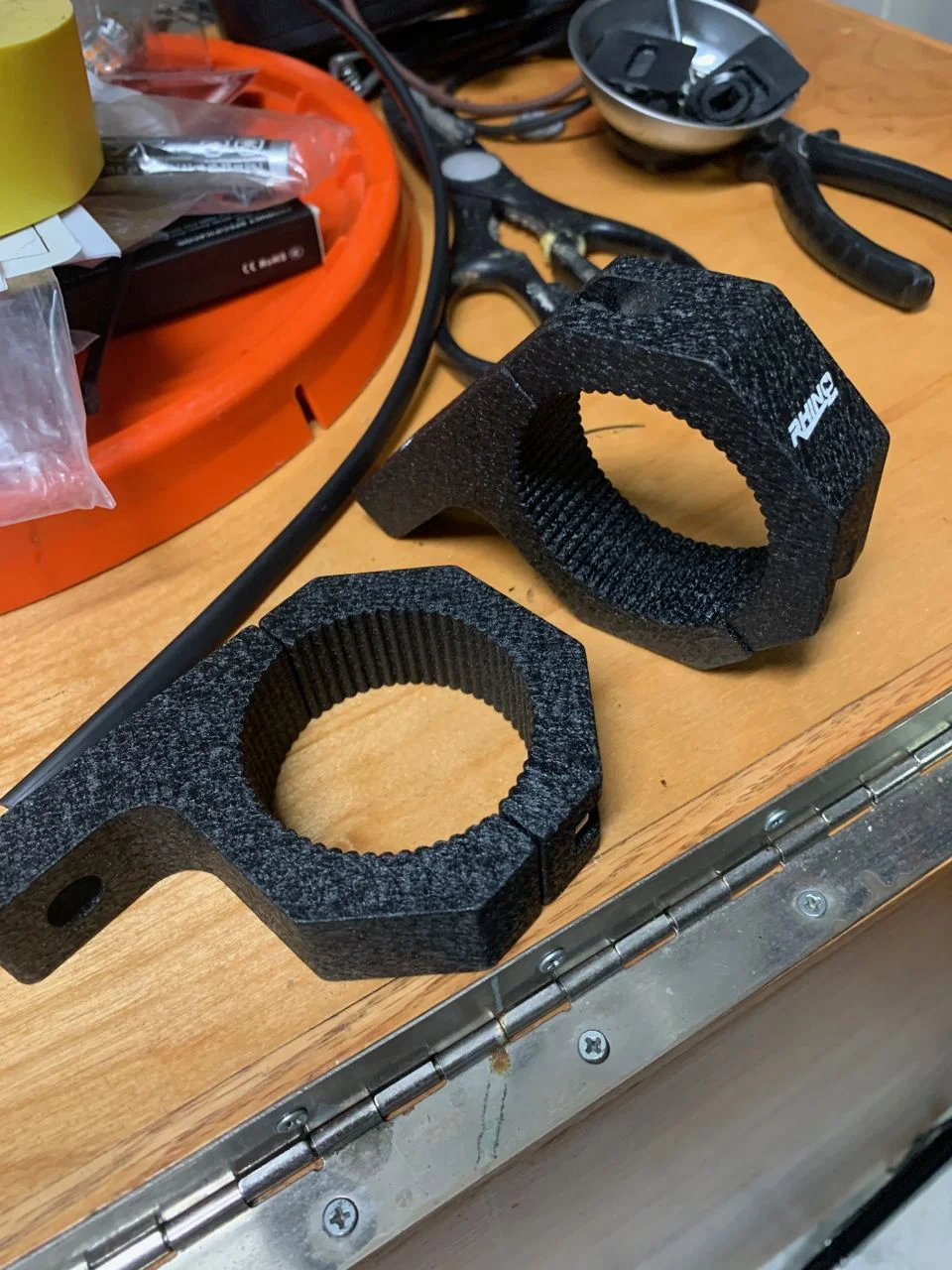

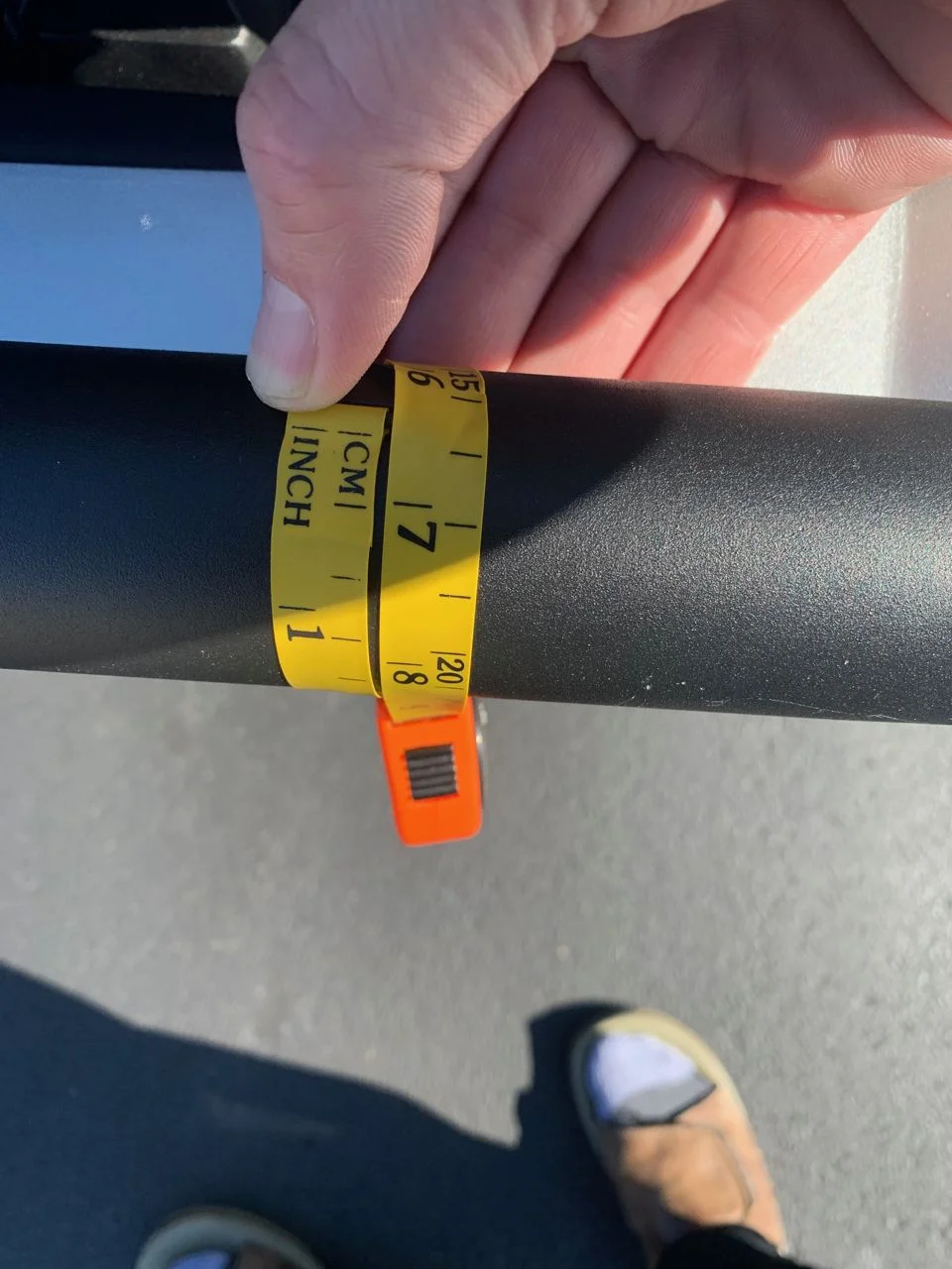

Did you happen to measure the diameter of the spotlight mount bar in the middle? I have one of these on order and will probably mount some lights... can't find anything on diameter on site...
Width from bracket mount end to the other is 33". Diameter is shown.
It should also come with these mounts.
Thanks for going to the trouble? I think you are giving me circumference... which if I am reading right is 6.5"? I can divide by "Pie" to get Diameter
There you go. It's ~ 2" in diameter. I can't measure now as wife is out and about in the LC.
