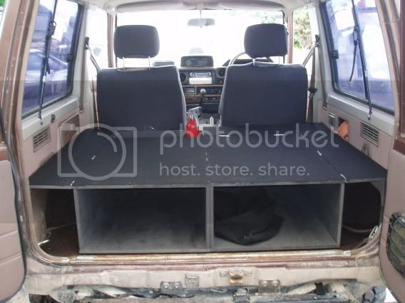

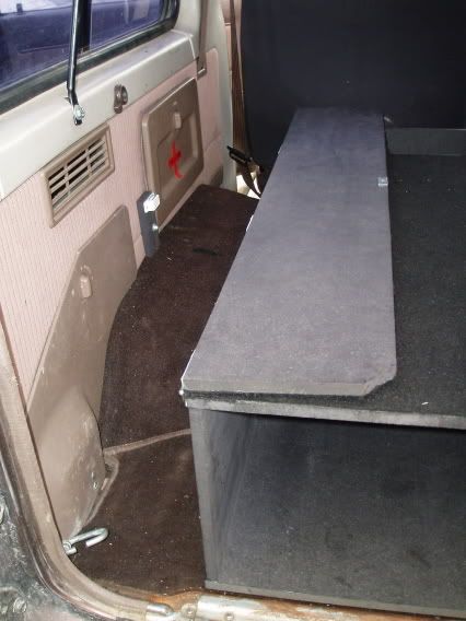

My LJ71 has some vertical bars there that would have been a retrofit to get it legal when it first arrived in NZ as a used jap import. You can see them in the pics below although the seats & belts have been removed:
Not sure if they are picking up some factory bolt holes there or if there's just a big washer behind the sheet metal.
Cheers
Clint
Cheers
Clint
Thanks for the photos Clint, but I don't have those bars on mine. In fact, my rear side windows are solid, so quite different. Thanks anyway!
