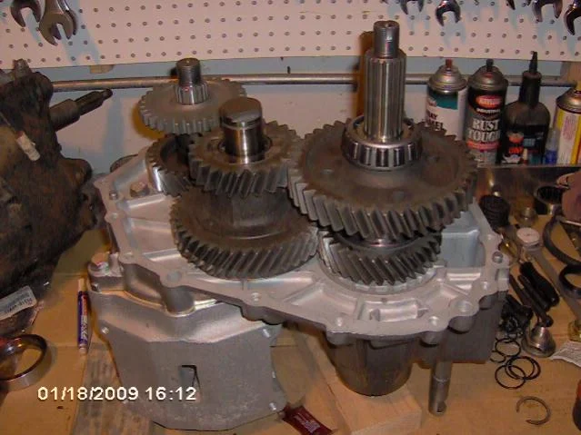

so tonight i stayed late at the shop. greenfox came down to give me a hand. i have a brand new AA ( mark's adapter ) for mating the th700 to the split case. the only thing missing are the instructions. go figure. but how hard can it be? i've done a few over the years so i thought i'd wing it. a couple of things did'nt make sense at first but after a couple of "dry runs" (assembling the partial t-case without seals, gaskets or sealants ) i had it all figures out and assembly began.
here's a before pic:
as usual, i had stripped down the donor t-case, ran it thru the parts washer, bead blasted some of the parts and painted them. i also wire-wheel anything threaded just to make sure the threads are clean and there won;t be any issues when things get bolted back together. doing so takes extra time but it makes assembly a cinch.
after about an hour, we were roughly half done and things were going well.
decided to take a little break and bbq some hot links. had some chips and an ice tea and got back to work. about an hour later the case was 90% done. i wqs getting pretty tired ( my lovely son has yet to realize that you're supposed to sleep at night ) so i decided to call it a night after cleaning up the tools.

finished product for tonight:
