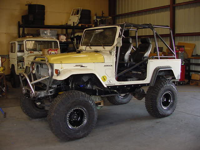

over the last couple of weeks, my partner in crime, don aka fc187, and i have been doing a few things to the cruiser. don has come up with a great family cage design. i wanted to incorporate the seat tubes/mounts and some sort of storage rack, preferrably removeable. that way i can have a back seat in it or when the seat is out of it, i can carry more junk. it's designed to be tall enough to store the coolers/tool boxes underneith. that way i don't have to dig thru a bunch of stuff to make myself a sandwich on the trail. much easier axcess to food and tools and that should save a bunch of time. i think it's a concept that'll catch on.

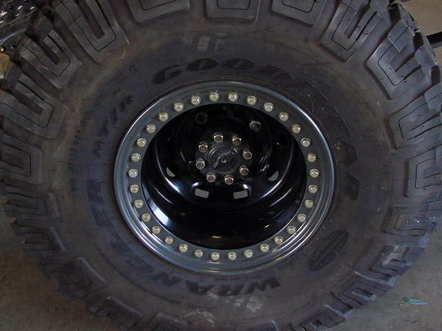

i got the cage, the luggage rack and the bead lock rings back from the powder coaters yesterday. did'nt have much else going so i decided to put the bead locks back together. that only took 4 hours.....
next i bolted the seats in the frames temporarily. the guys at ace had mis-packaged the lock-nuts i needed so i could'nt mount them permanently. hence the cage is sitting on top of a few 2x4s in the tub right now. otherwise the seat mounting bolts would ventilate the tank for me. they're extra long right now and need to be trimmed, but not until i have the proper hardware on there. here's a pic of the cage in the rig without the luggage rack.

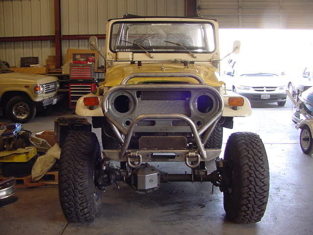

last week don also built a new bumper and stinger/winch mount for the rig. we decided that the bolt on bumper was'nt the way to go and wanted something sturdy, compact and functional. here's what we came up with:
if you look closely at the last pic you can see that the trans cooler line will hit the headlight bucket. so i have to take the rad and coolers back out and re-position the trans cooler. it'll end up being more centered in the open grille area which will look better, cool better and create enough clearance for the trans cooler lines. the sheet metal is only mocked on there right now with a few bolts and the hood and bib are not the ones i'll be running.

how much body lift did you put on there? looks awesome, would like to lift mine.
Thats alota bolts!!!

i'm running a 2" body lift to create room for the clocked atlas. otherwise it would hang at least two inches below the frame and i would'nt have as much clearance. i had to do some trimming on the re-enforcement ribbing on the bottom of the tub even with the body lift to get enough clearance as it is.

the body lift came with the rig. pretty sure it's a BTB or something along those lines. powder coated aluminum blocks and a bar across the back 4 body mounts. pretty sure i will make new ones though cause that part is very bulky and heavy (like i outta be worried about an extra pound or two at this point!:lol: )
