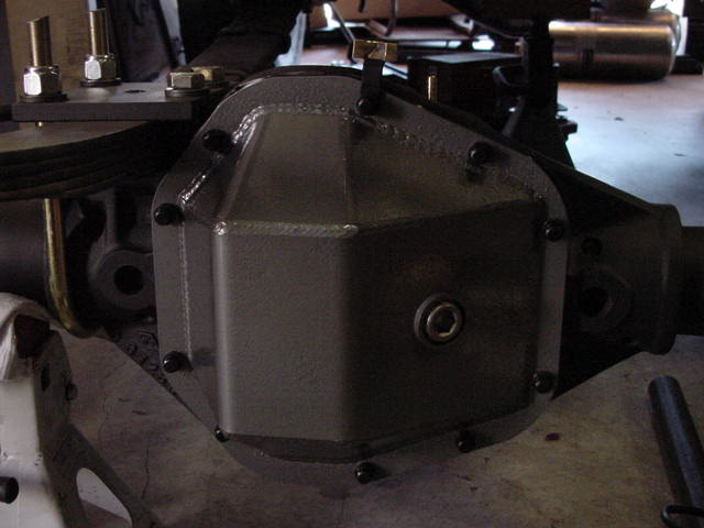

somebody had voiced their concern about diff protection earlier in the thread. i was unsure of who's cover to run but watching rustynut's covers in action and meeting dan and the crew from www.bluetorchfab.com helped me make up my mind without and doubts. i bought a pair of their d60 covers and these babies are stout to say the least. the stock "thick" cover is about .160" which is just over an 1/8". the BTF cover is .375" which translates to 3/8" and allows for more fluid capacity.
couple of pics. one is a comparo of the BTF unit versus the stock "thick" cover, the other one is of the BTF cover installed on the front of isabel.

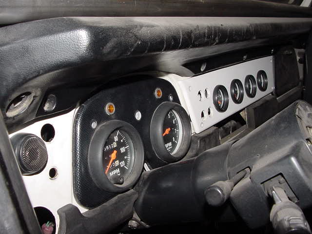

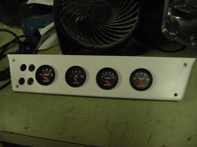

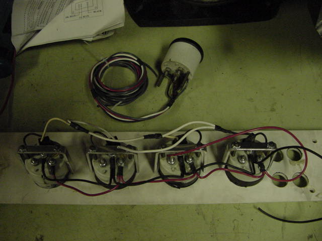

i started this week by removing the rest of the chopped up factory harness along with some more rat's nest wiring so i can start with a clean slate. pulled both gauge panels and rewired the gauges, or at least some of the wiring on them as prelim work to the complete rewiring job. i'm trying to get a bunch of "sub assemblies" completed so when the point in time comes to install some of this stuff, i'll have a lot of it ready to go.
i don't like crip connectors because they can and will fail over time due to vibration and corosion issues, so i hard solder and use shrink tube on everything. this takes a lot more time and creates more work, but i think it's worth the peace of mind.
here are a couple of pics of the gauge pods and gauges.

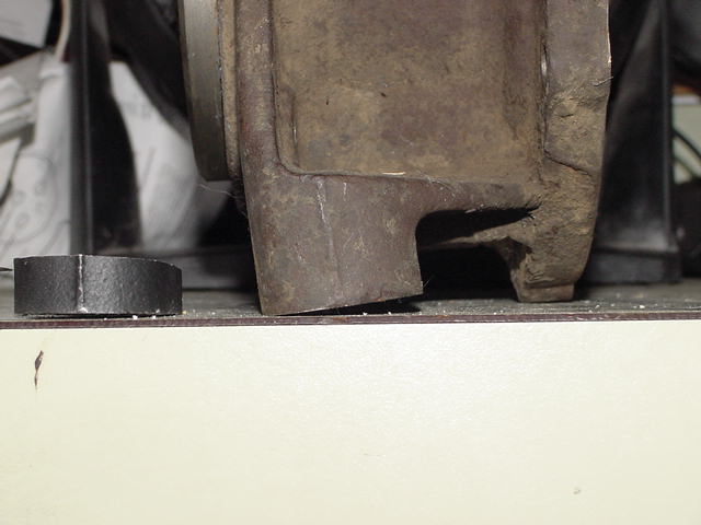

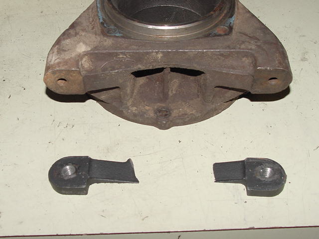

after re-installing the atlas i quickly figured out that the transmission adapter mount hung down too low. so back out with the t-case and adapter to create more clearance. i figured the easiest way to do this would be to chop the needed 1/2" off the adapter by chucking it up in the mill. but the "feet" on the adapter are not perpendicular with the sides, so i had to come up with something else. i could of course change the angle on the mill head but then i'd have to re-index it to cut perfectly horizontal and that can take anywhere from 30 minutes to 3 hours. that was'nt part of the program so i marked the adapter as well as i could and used my portaband. that got me pretty close and the grinder finished the rest.
here are a couple of pics of a stock adapter, along with the removed sections and a pic of the modified unit installed in the rig:

I like that center guage pod. Did you make it?
As for the new job, are you doing the same sort of thing? Still the go-to guy for trannys?
the gauge pods in the cruiser were made by cruiser friends of ours in the counter top industry. they made a few of these but only for friends and no longer make them cause they're waaaay to time consuming and their business is beyond swamped, which is a good problem.

On the diff cover what kinda paint did u use ? just curious
thanks for the compliment rachel. have'nt heard from you in a long time. the paint on the covers is hammerite. it creates an uneven yet verh hard finish that's easy to touch up, should work out well on the diff covers cause i know they're gonna get bashed. :grinpimp:
