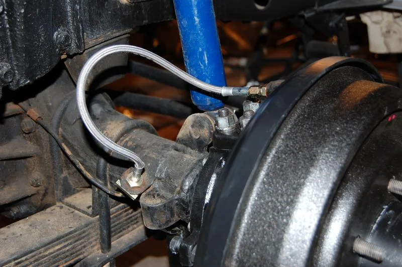

I am a newbie here and have a 72 fj40. currently replacing master and all 8 brake cylinders. Decided while I am in there I should do an axle rebuild (Somewhat over my head) Front brake lines were badly cracked and I was able to find braided ones from Skyjacker Suspensions via a local shop here in Denver. Too bad the shop thought they were sold in pairs and I have to wait a week for them to get the 2nd one. I think they sell the one for the rear as well and they are all a longer than stock to accommodate a lift.
Hope the picture attaches!

your info is in the wrong thread. THis thread is specific to the 9mm lines, which are a peculiar animal to the pre-71 cruisers.
FWIW, I think your lines are too long. A lift kit does nothing to change the distances you've highlighted in your photo. Only differences are in lines that run from axle to frame.
Downey Off Road also sells the lines, in many different lengths.
