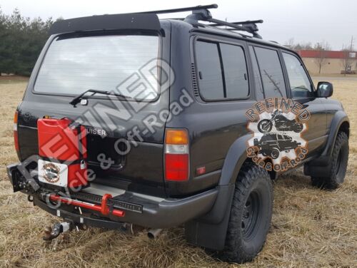

Long time no post in this thread. I was looking at some more cosmetic things as the old girl is still under way to baseline. Has anyone tried these? I’d like a full bumper and spare tire/swing out rig but seems pretty expensive.
