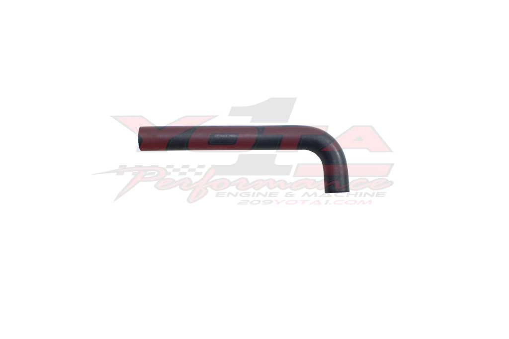

Another question m. Tried to find pcv valve hose I had to cut off because it was somewhat rubber welded on. I found this part number 1226161060. But doesn’t seem to have anywhere legit to buy it. Any insight? Thanks
