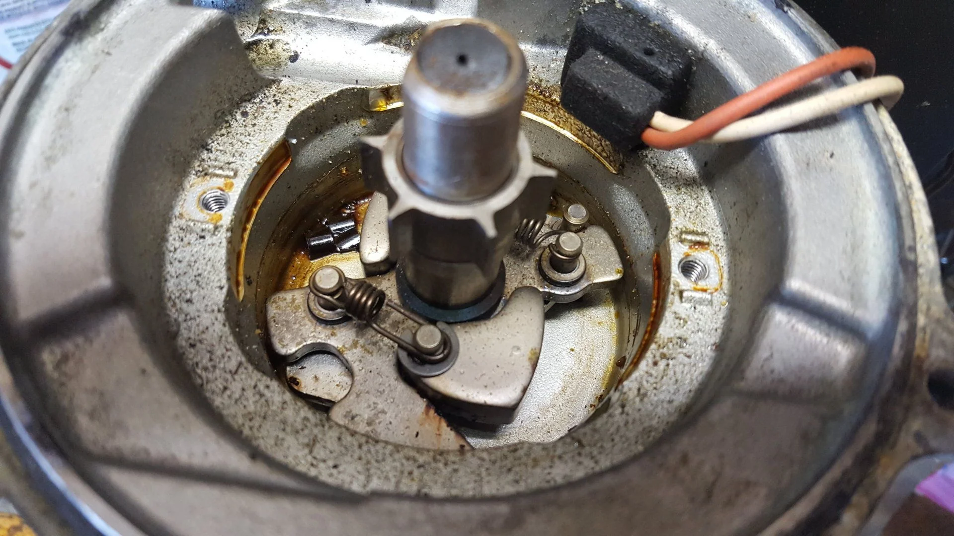

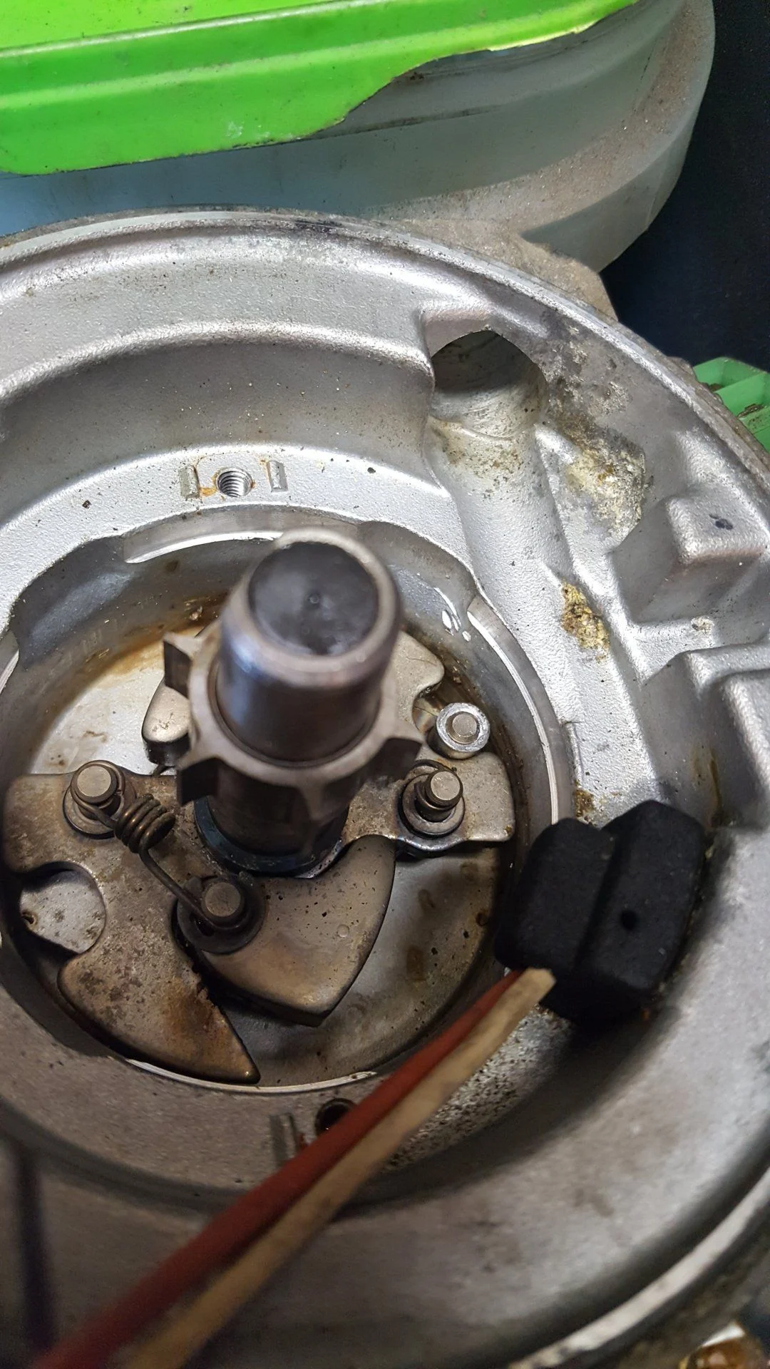

I had a few minutes this evening, so finished pulling my dizzy.
I followed the FSM, but somewhere along the way there must have been a change because mine had some differences from what was in the FSM. It was close enough though that I was able to get it done.
This is what I found inside:
Definitely time for the mod. This is what I used, bought at HD:
And the finished product (after hitting the insides real quickly with a drill):
I cleaned it all up and sprayed some dry lubricant in there and it all moved nice and smoothly, except for this guy:
It was downright crunchy.
If my understanding is correct, this plate doesnt move much, just with the vacuum advance. According to the FSM there should be 'some' resistance. I wasn't super keen on how stiff it was though, so I packed the bearings with grease and then cleaned it up.
Hopefully I didn't mess anything up.
I reinstalled the dizzy then grabbed the timing light. @PoloSlayer and I set the timing to about spot on. The engine sounded pretty good, although I noticed the dizzy was rotated more clockwise (when looking down from above the engine) than before. Previously the adjuster tab was pretty well centered, now it is rotated so that most of the tab is on the wheel side of the bolt head.
I don't know what to make of this, if anything?

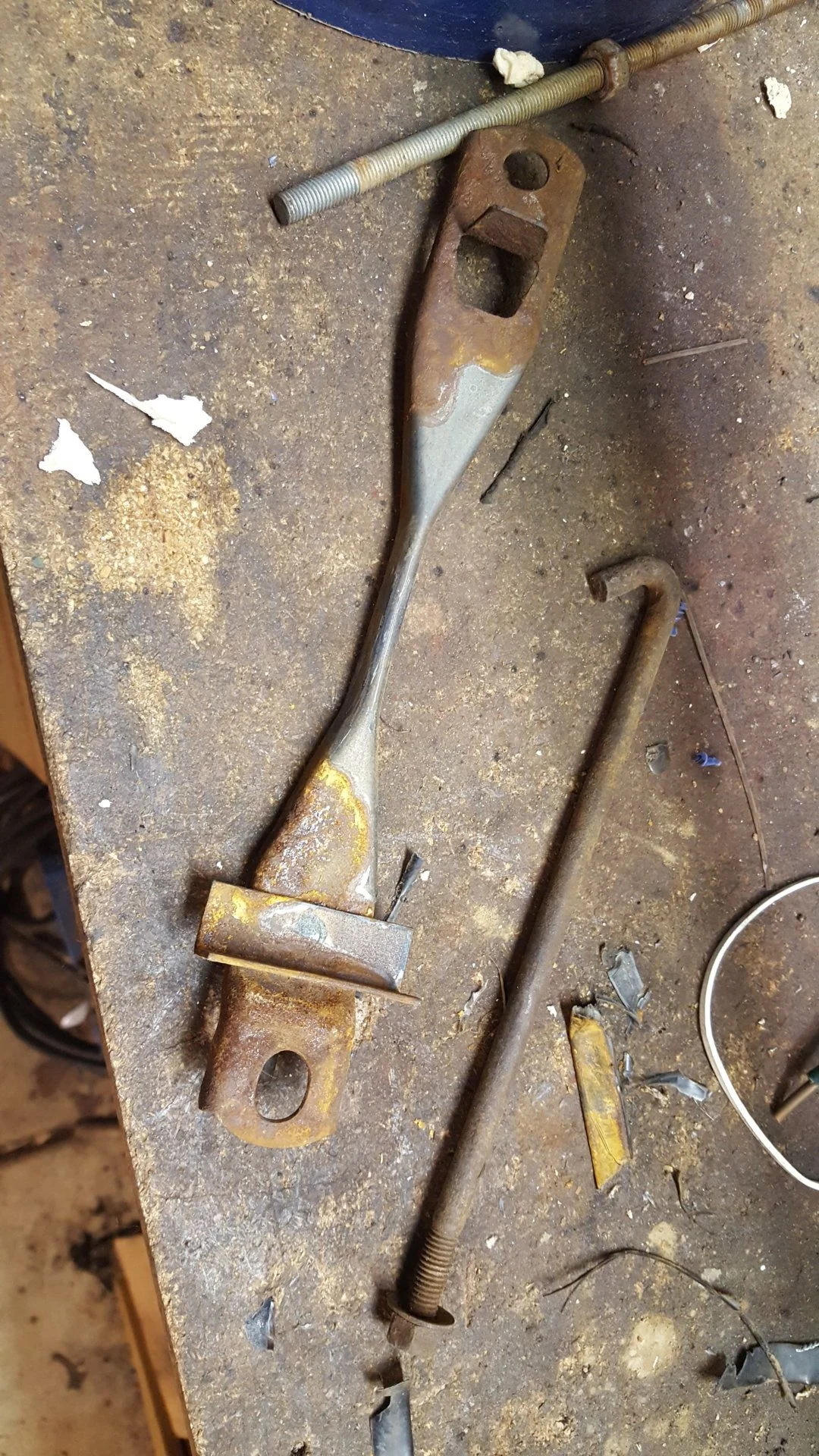

Here's how it looked after I removed what remained of the rubber coating:

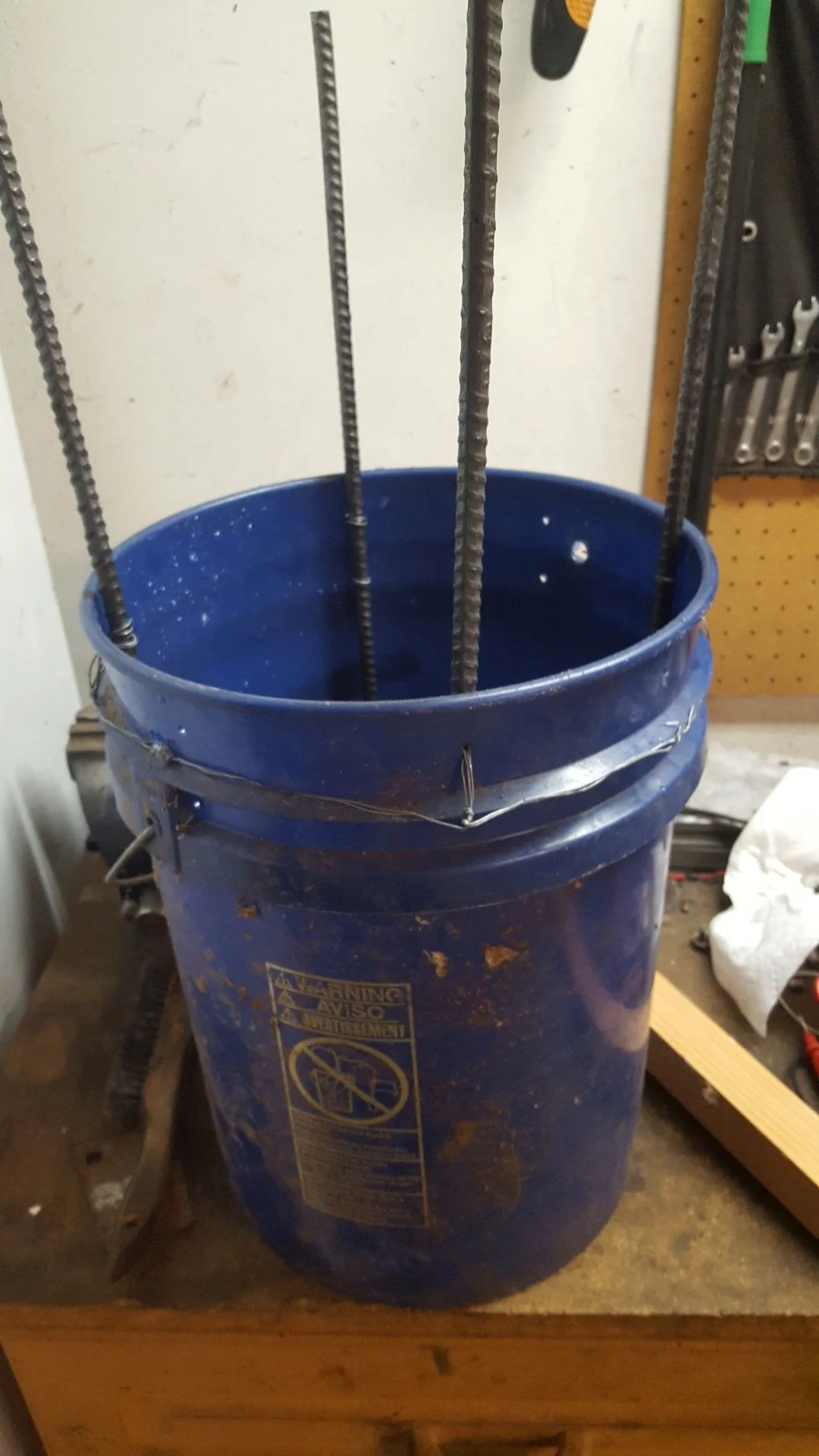

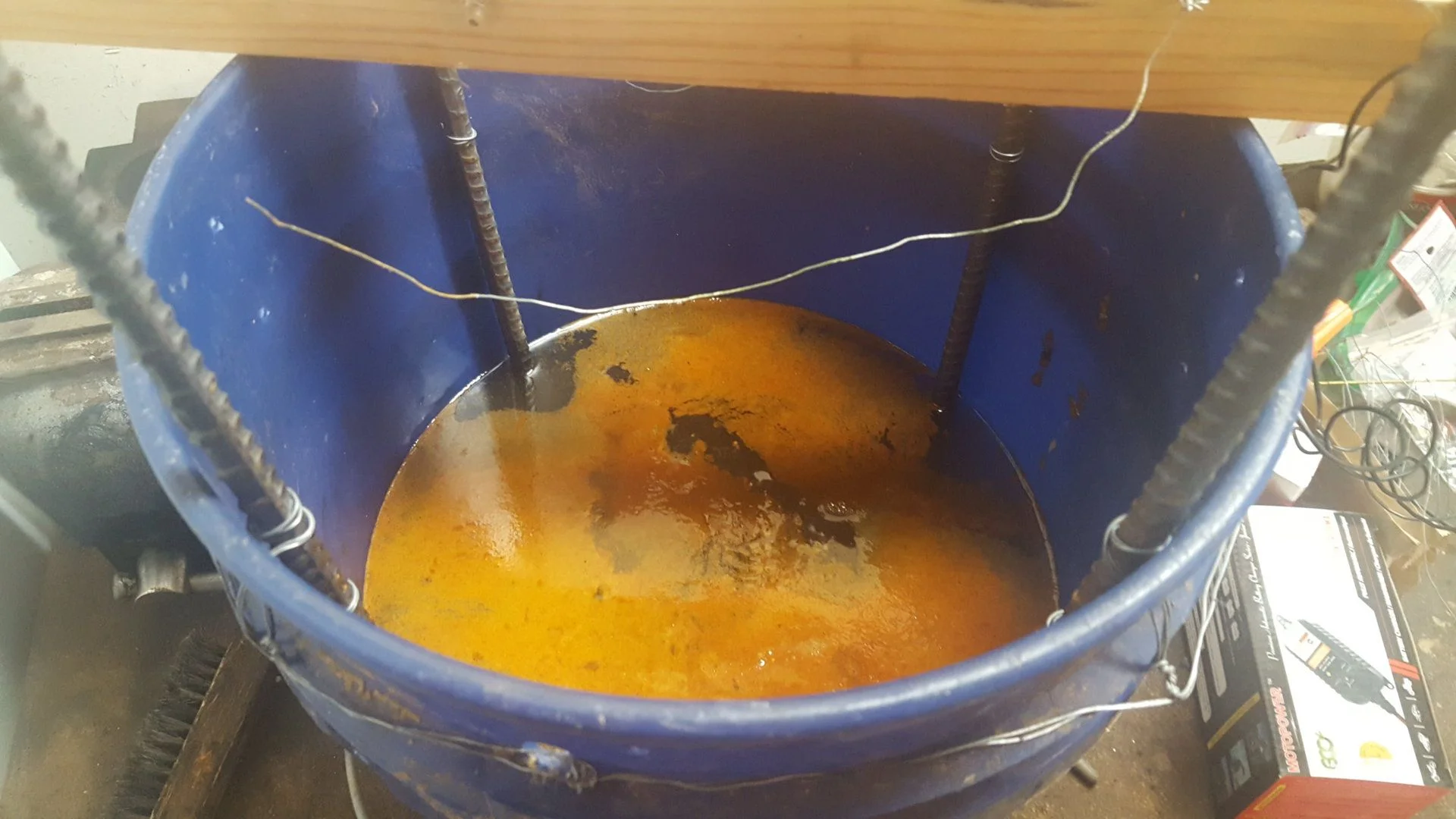

I scrounged in my garage and found an old inverter off a router we haven't had for who-knows-how-many-years. Not very powerful, 12v and 1.8 amps, but enough for a proof-of-concept.
Then I grabbed a bucket and some old bailing wire and raided the laundry closet for some washing soda. A trip to the hardware store and $9 later and I had 4 pieces of 2' rebar.
It took me maybe 45mins to put it all together:
And an action shot:

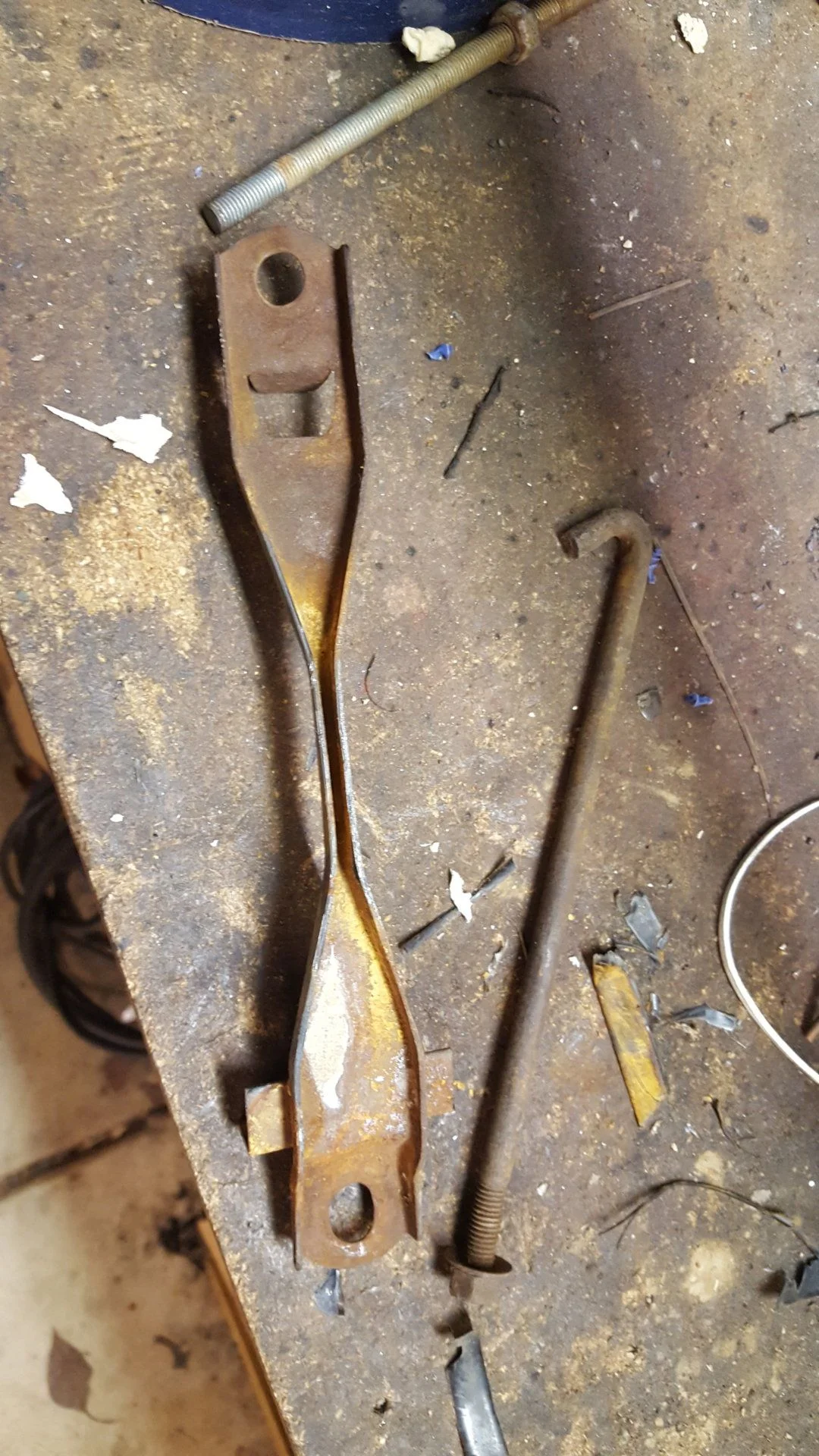

The final result:
I really like how non-invasive it is, and virtually no work to do. You just can't be in a rush. I wasn't prepared for the nasty black mess afterwards, but it scrubbed off pretty easily with a brush and water in the kitchen sink (while my wife was gone....)

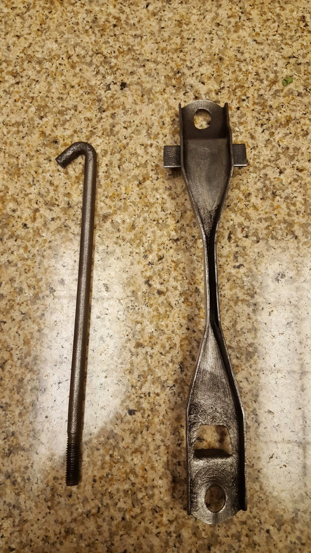

Ha! Awesome. I’ve got a beat one in my garage too! Show me how that hook part is arranged. I held it up and simply put it back down feeling rather clueless. ;) so please enlighten me!

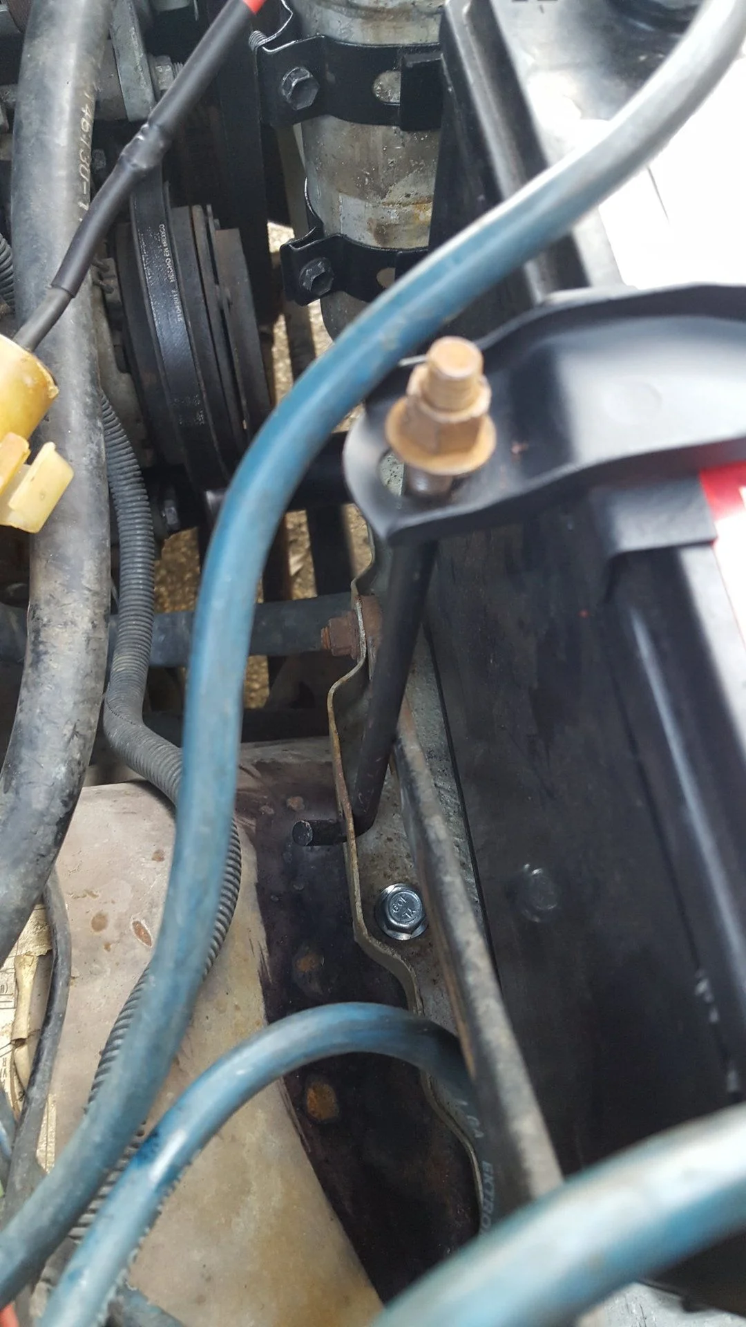

The hook end goes through a hole in the battery tray and the thread end goes through the clamp and gets a nut on it. The other end of the clamp bolts to the front frame of the truck.
I'l try and snap a pic tomorrow once the paint on mine dries ;)
@NeverGiveUpYota here you go:
