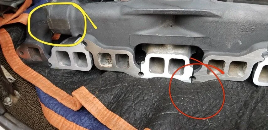

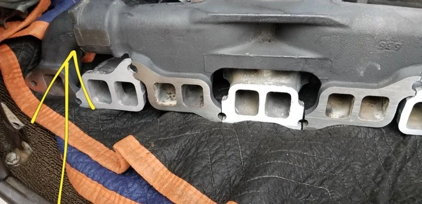

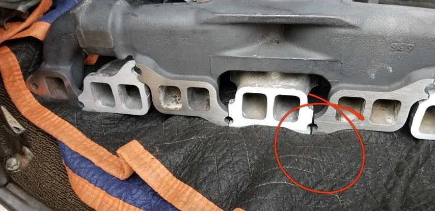

You mean he did the flanges where the bolt heads press? Damn lucky you found someone willing to do that part!
The area I circled is just a shadow right? It appears like a change in flatness.
Be sure to take a round file to the holes because they’ll now be ovaled from being planed.
Yep, just a shadow.
I asked him to spot-face the bolt holes, but he didnt have a tool that could get down in there to do it.
My concern is on the horns, if you look in the pics at the top you can see where they hit the sander as well and got flattened.
Yep, just a shadow.
I zoomed in but I’m not seeing what your seeing. The horns ought to have been planed too. Many will say they should be tack welded THEN planed. The guy I’d gone to hadn’t, I didn’t know that detail then. I had a machinist friend take it later to his work and check it on a true stone and found the intake ends were cupped. He planed it for me at his work by simply flipping it over and using its own weight to take it down. It’s not perfect but far better.
Is that what your concerned with?
I see what youre talking about, on the coupling area of the exhaust manifold. Mine are ground there and no problems so far.
Yep, the yellow circle.
Yeah I agree w/ @CuCruiser. that’s the outer surface. Nothing to stress about. The machinist definetly has to grind deep tho if he took material that far off. There are two raised areas that are meant to get hit before the body of the horns. There’s also two circular areas too that I believe were were it was attached to the mold when it was poured, those tend to get ground down too (I’m not seeing them now but there somewhere).

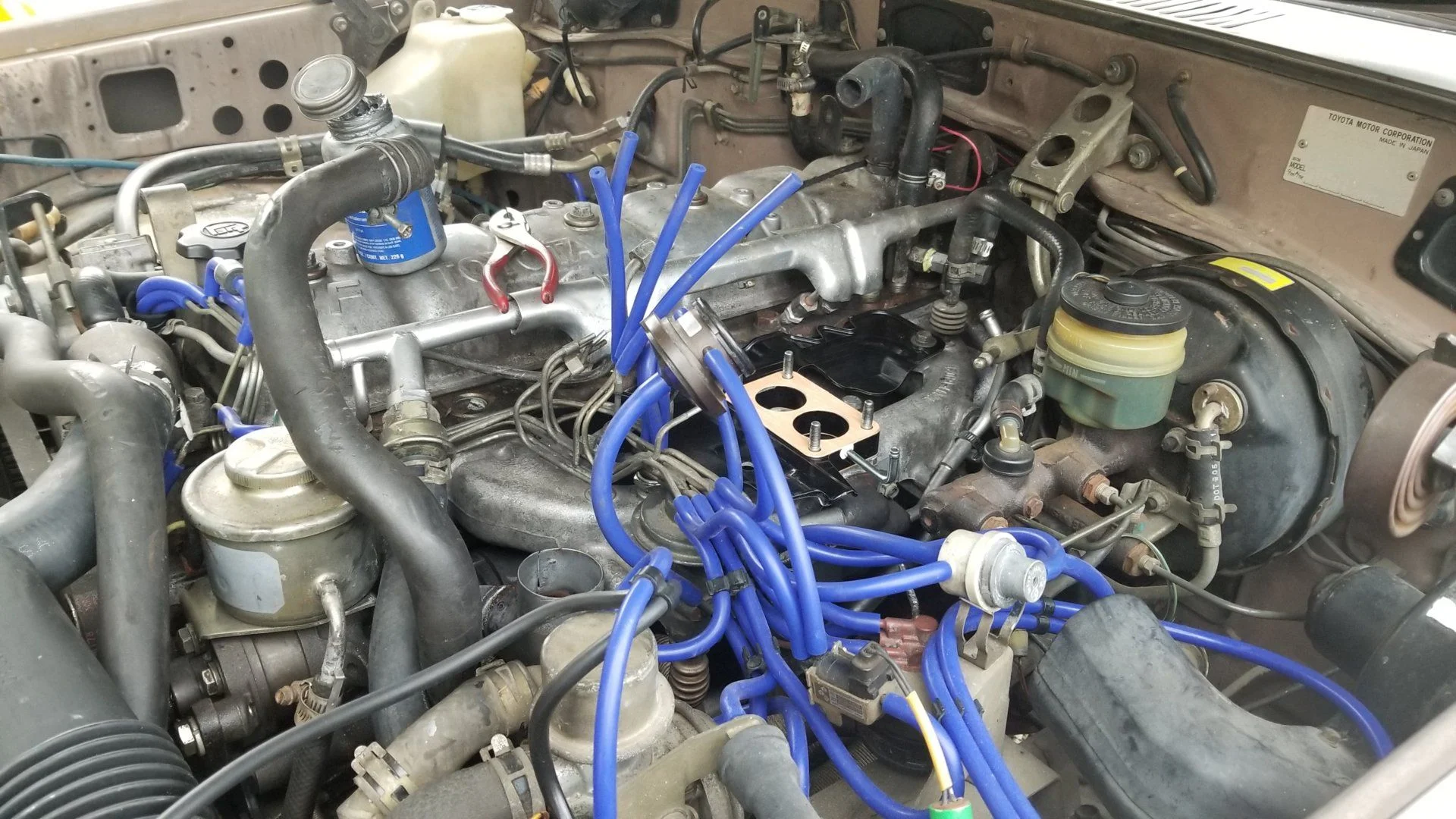

Had a few moments this weekend and finally got back to this.
Cleaned up the engine a bit and started bolting things back on:
Just need to go back through all my vacuum lines and I should be good to give it another try.

No leaks, but it's still running poorly. The only things left I can think of are the dizzy (doesnt seem to hold timing very well) and/or I botched the carb rebuild somehow.
