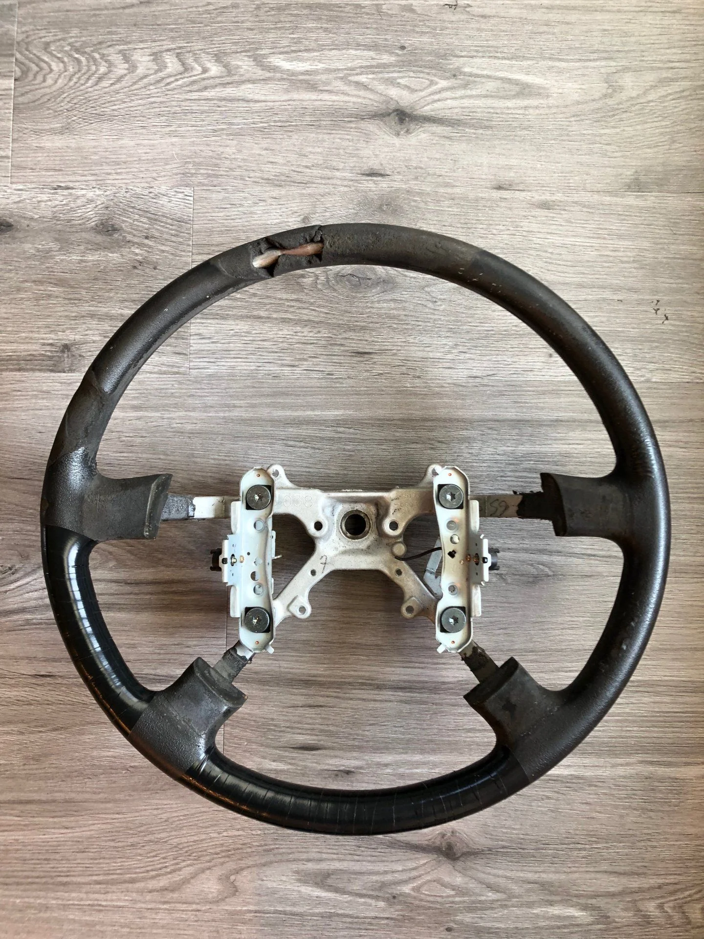

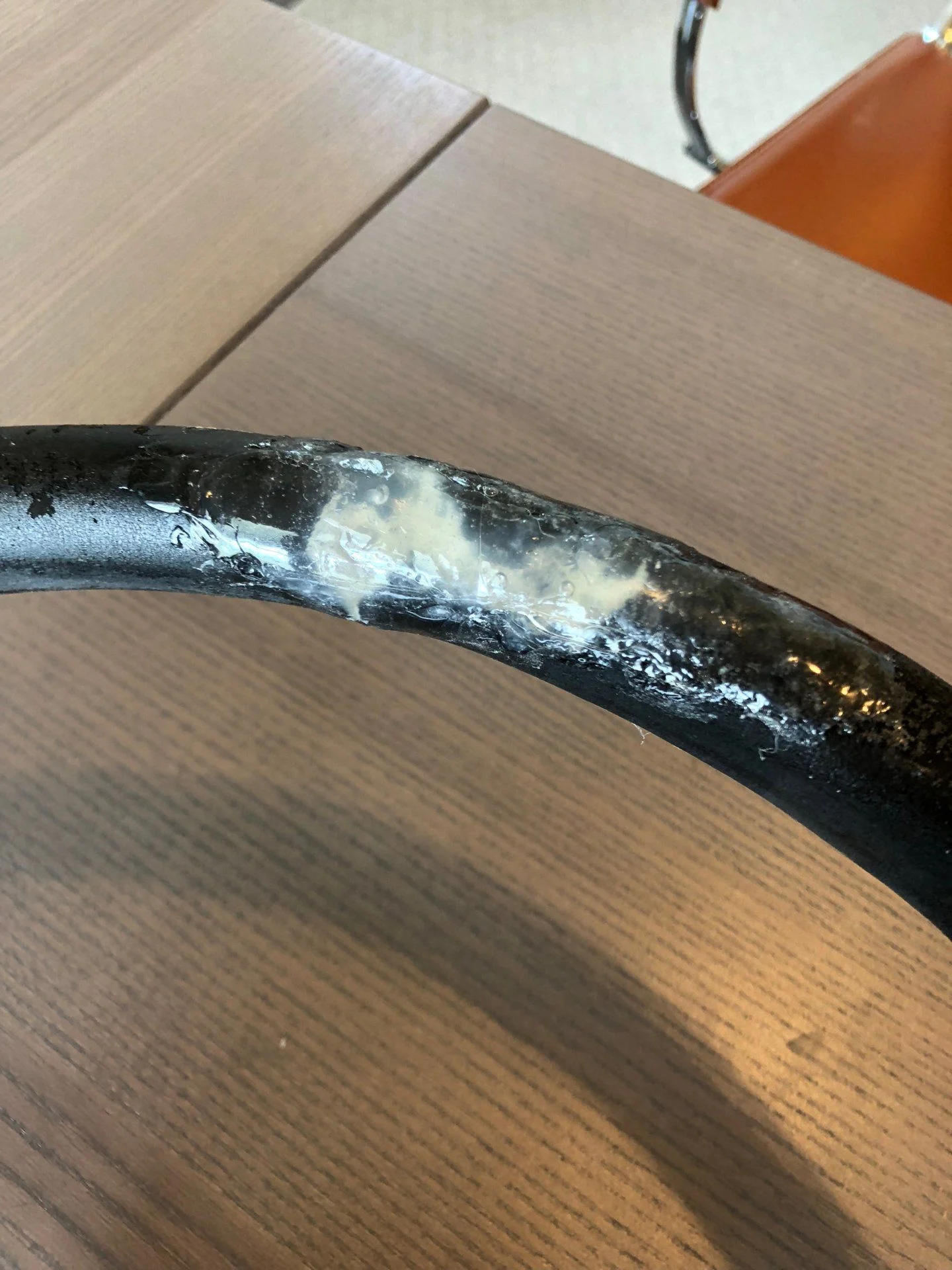

Restored wrapped and hand stitched the steering wheel of my LX450. I originally ordered a wheel off ebay and it ended up be the wrong one, so I decided to restore my original (badly worn wheel) The entire foam/rubber ring moved on the actual metal wheel, so I split it and bonded it with a few drops of water and Gorilla Glue.
The area worn down to the metal, was filled in with Shoe Goop, since it would be strong and have a similar feel to the wheel.

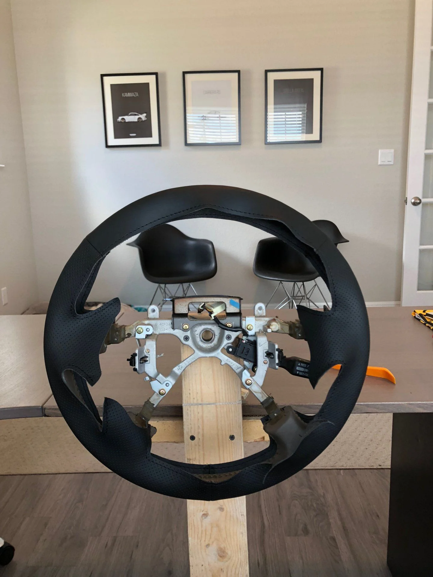

I then installed a thin silicone wheel cover off Amazon in order to provide a thicker grip prior to stitching on the leather cover.

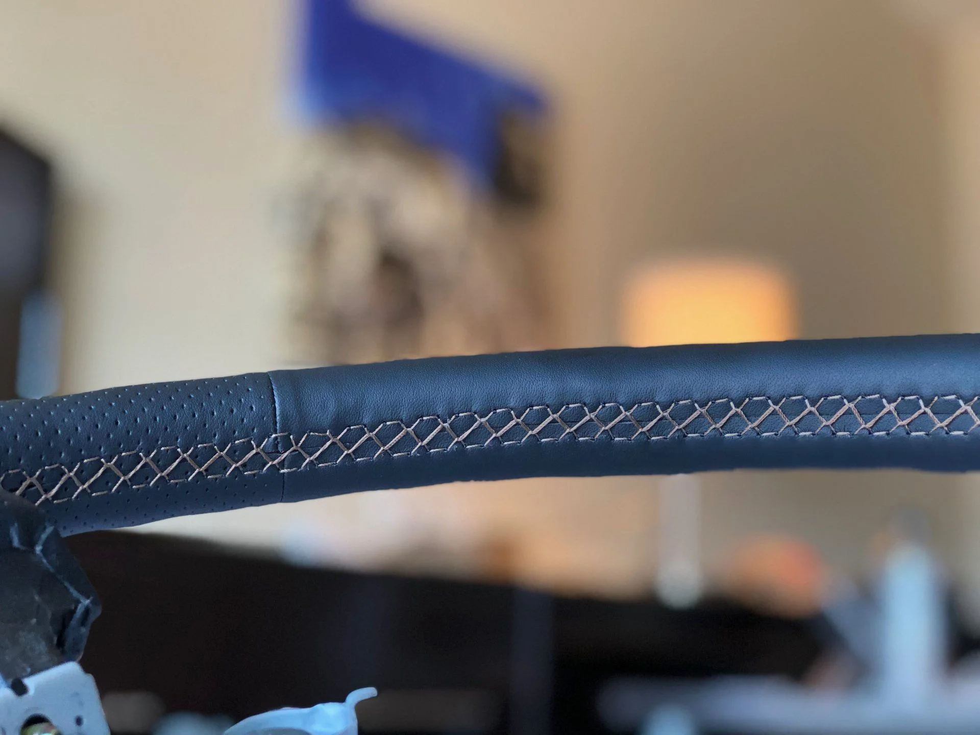

As you can see, I also decided to go with a black leather since I didn't really care for the tan. But I did bring in some brown deviated stitching to help tie in with the interior. The stitching took me about 5 hours to complete and boy were my fingers hurting afterwards.

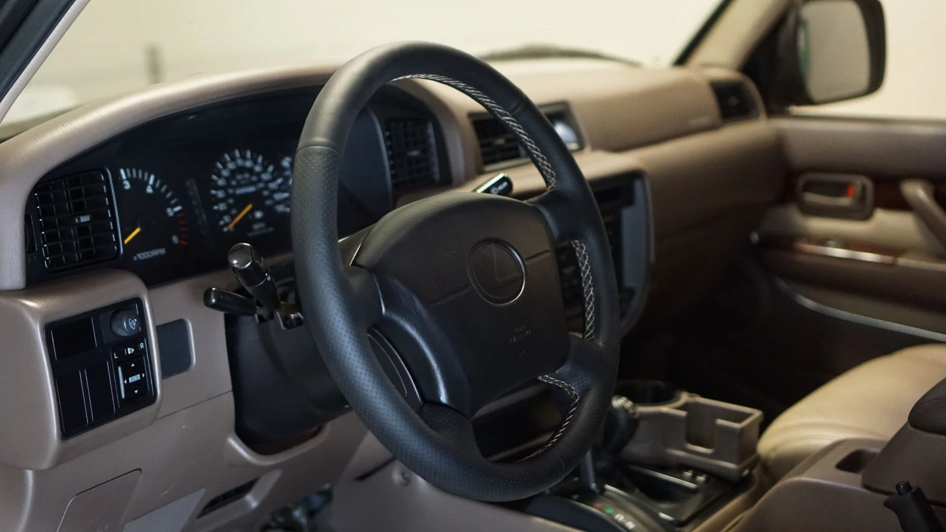

To complete the look it decided to dye the airbag cover and steering column, and I'm quite pleased with the outcome

Beautiful! What did you use to dye the airbag and column?
I used Color coat and I'm happy with the result. The key is to properly prepare the plastic to take the dye. All interior plastics have some mold release on the from the factory and it needs to be removed, to do so I used Tri-Sodium Phosphate which you can purchase at any local hardware store.

The wheel of the very first photo and the wheel with the leather cover on (un-sewn) are two different wheels. Are you really showing the wheel you restore here?
If you had read the first sentence in my post, you would understand why they're different. I just didn't take pictures of the stitching process the second time around, and figured I'd provide the pictures of the process that I did have. But if you require something more confirming, look below.
