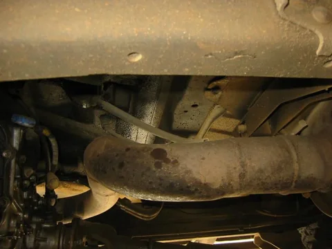

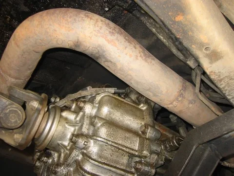

NV4500/Txfr Case with exhaust path front to rear - here C-channel tranny mount and exhaust passing betw rail and txfr case:
View looking to front:
Longer view looking to front/engine/downtube:

Fit is definitely tight---turns out on the 82 FJ60/RastaRig the engine was moved over to squeeze the exhaust side/rail spacing by about an inch less. We'll be doing that same 3in exhaust passthru with less space---making fuel shield vital.
More views showing exhaust front-to-rear:

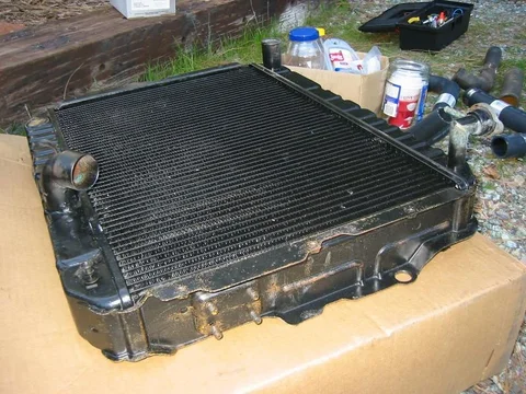

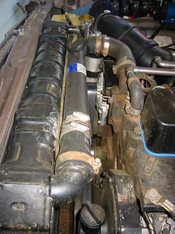

... more radiator views...

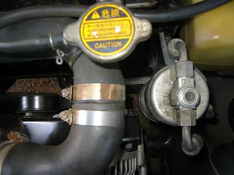

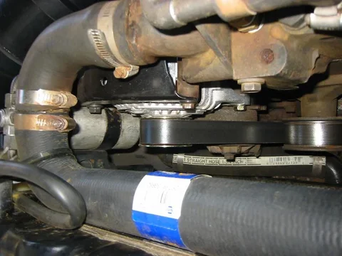

This is showing inlet to 6BT which is connected to lower radiator via the Copper Artwork twisted "U" shooting through the final straight radiator pipe in background:
... and you can just see from this TOP view...that final straight away lower out of radiator at bottom/left of pic view. Pulley to RT of pic is the 6BT water pump:

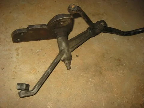

..... however I have never seen the NV4500 throw the shifter through the stock shifter hole. ...
...and Cliff asked to see an NV4500 shifter through a stock Toy. Here ya go Cliff:
... well, okay to be fair to Nellie2.0, that previous was from RastaRig.
Here is Nellie1.0 shifters---both:
Brings a tear to my eye, R.I.P. Nellie1.0:

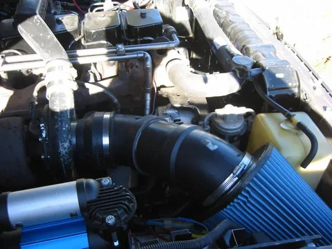

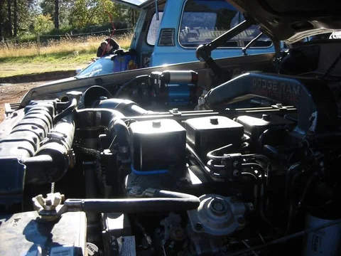

Do you think it would be possible to mount the 6bt a little higher up if you made your own charge pipe from the turbo to the TB? Or would that require chopping up the transmission tunnel?
