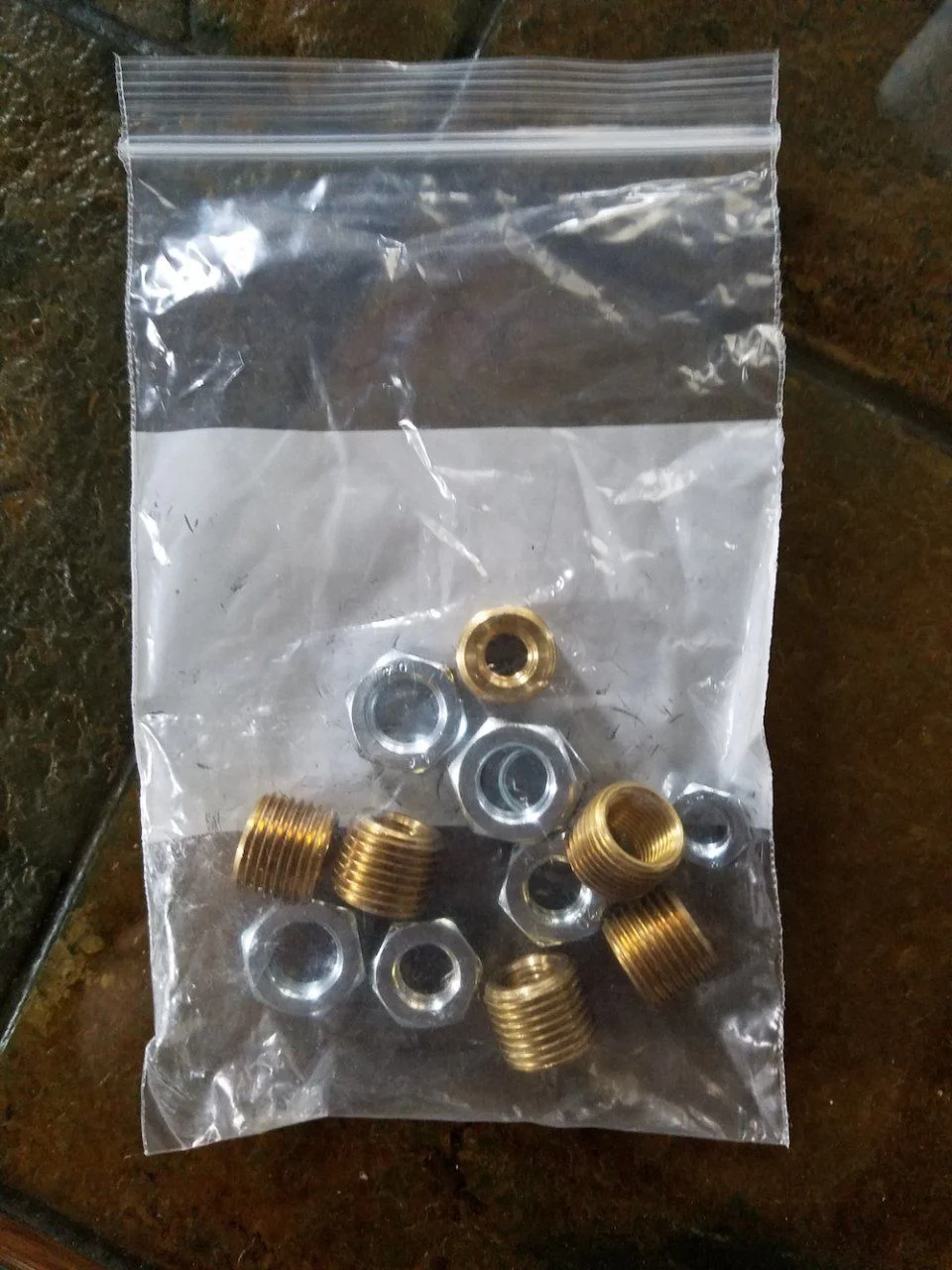

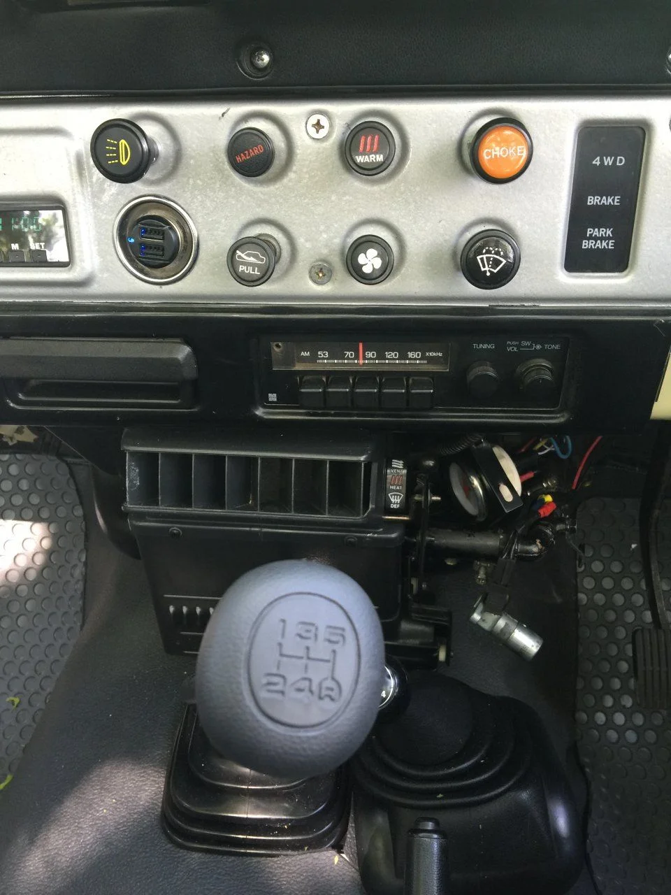

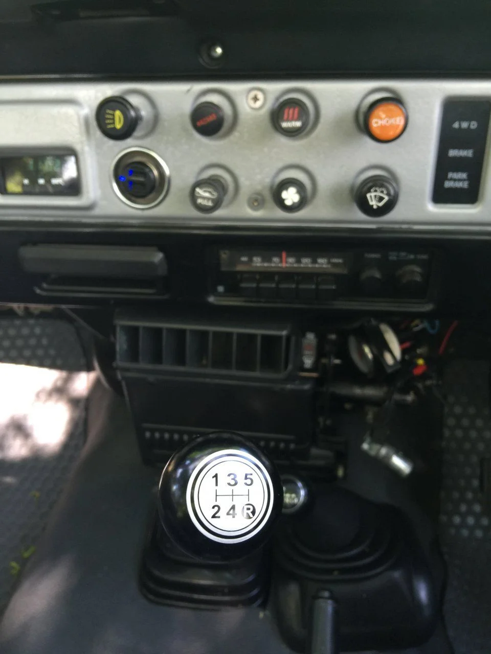

You may be able to find an adapter. Here is a kit I received from a knob I ordered one other time. I just got my 5speed version. I will put it on this weekend. I used lock-tight last time, so I may have trouble breaking the seal... The lock-tight worked awesomely, so no need for a set screw in my previous version.

My 5-speed knob fit correctly. The 4-speed is a smaller bolt size. As others have mentioned, it is 10x1.25. I hope there is an adapter. Alternately, the adapter set I posted above uses a size bigger than the 12x1.25 and has a step down to 10x1.25, so widening to meet an adapter could work. My set is 16x1.5 outer, then 10x1.25 or 12x1.25 inner.
Hope something like that is easy to find and drill/tap.

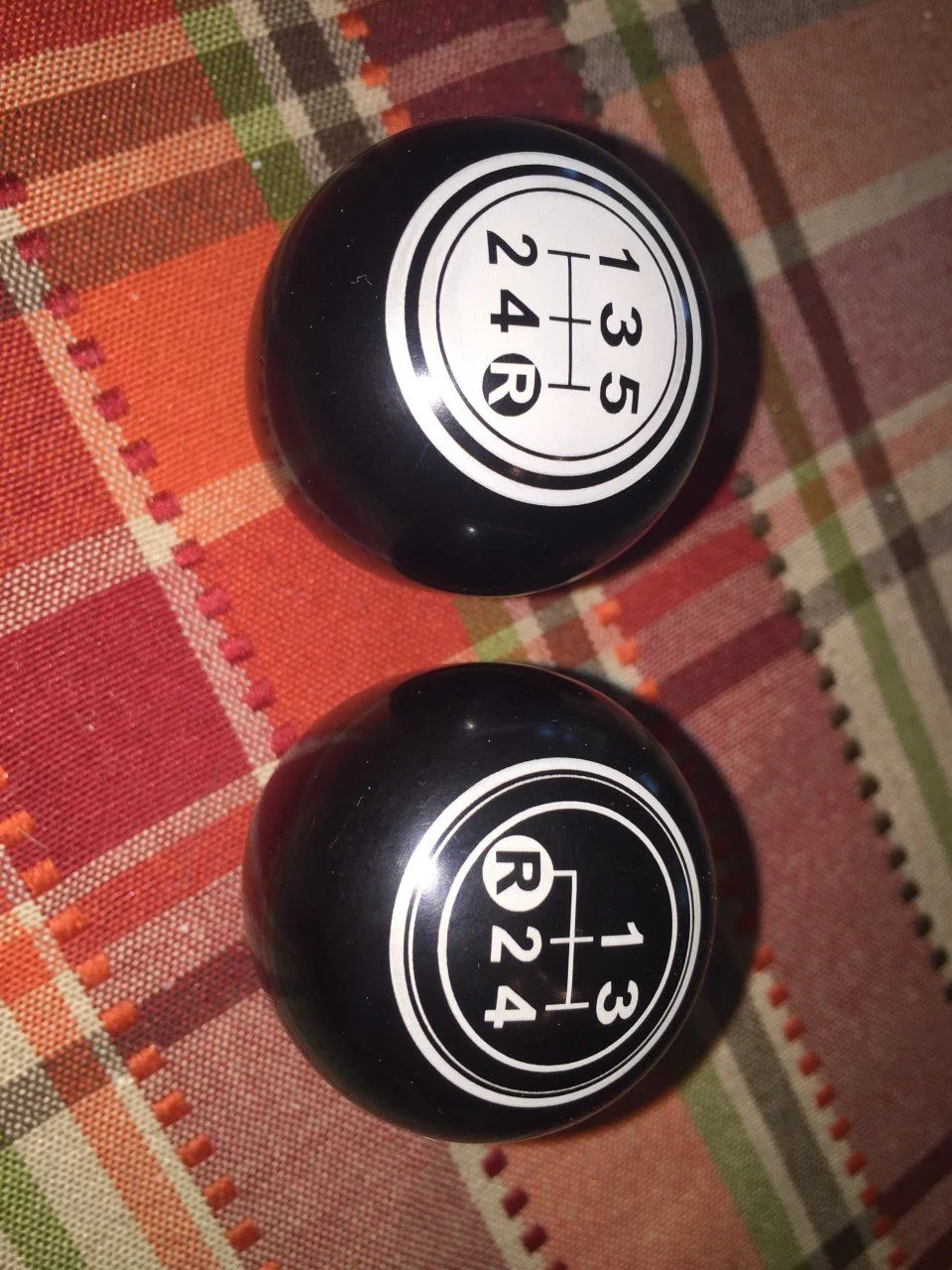

The set screw was necessary as with the originals once they are screwed down you could turn them abit further as the threads were just plastic. These being solid aluminum, don't budge. So the set screw(6-32) allows us to lock it down. I tried to place it in a inconspicuous spot so it's doubtful it will ever be noticed. As far as the other questions regarding color, please see the Facebook link for the photos. The 4&5 speed knobs have reversed colors as the originals. With anodizing the laser simply dyes out the base material leaving white to shine through. Are you asking if the 5 speed could be reversed to look like the 4 speed? Then yes I saved a couple of knobs that haven't need lasered just invade someone asked for a special let me know.

I want 5 speed with black base look like the 4 speed knob
Do you still have stock?
So on post#56 there is pic of 4 & 5 spd knob. Are you wanting that exact 5 spd or are you requesting a special 5 spd that has the shift pattern reversed like the 4 spd? Sorry just want to be clear.

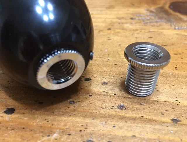

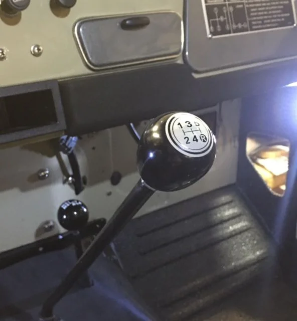

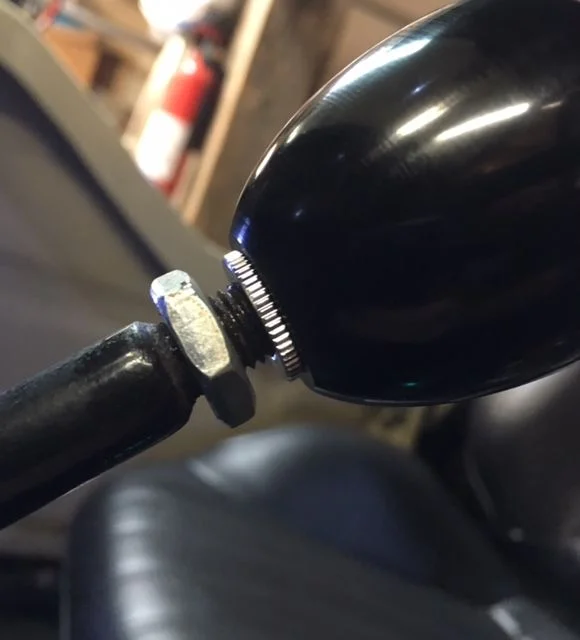

Ya'll - Iam helping out Keith with his "Knob issue" ;) Keith's knobs rock, and I even own one myself.
I had an adaptor made to solve the 4-speed thread size issue, and Keith and I are coordinating our efforts to ship these out ASAP. So if you have one of Keith's 4-speed knobs, and find an envelope in your mailbox next week from Cruisercrap.com, it's your adaptor!
When using the adapter, put a drop of lock tight, and then use set screw.
Use the 10mm nut I'll send, to adjust the angle of the knob.

What I need is 5 speed knob with black color and white marking number just look like 4 speed
