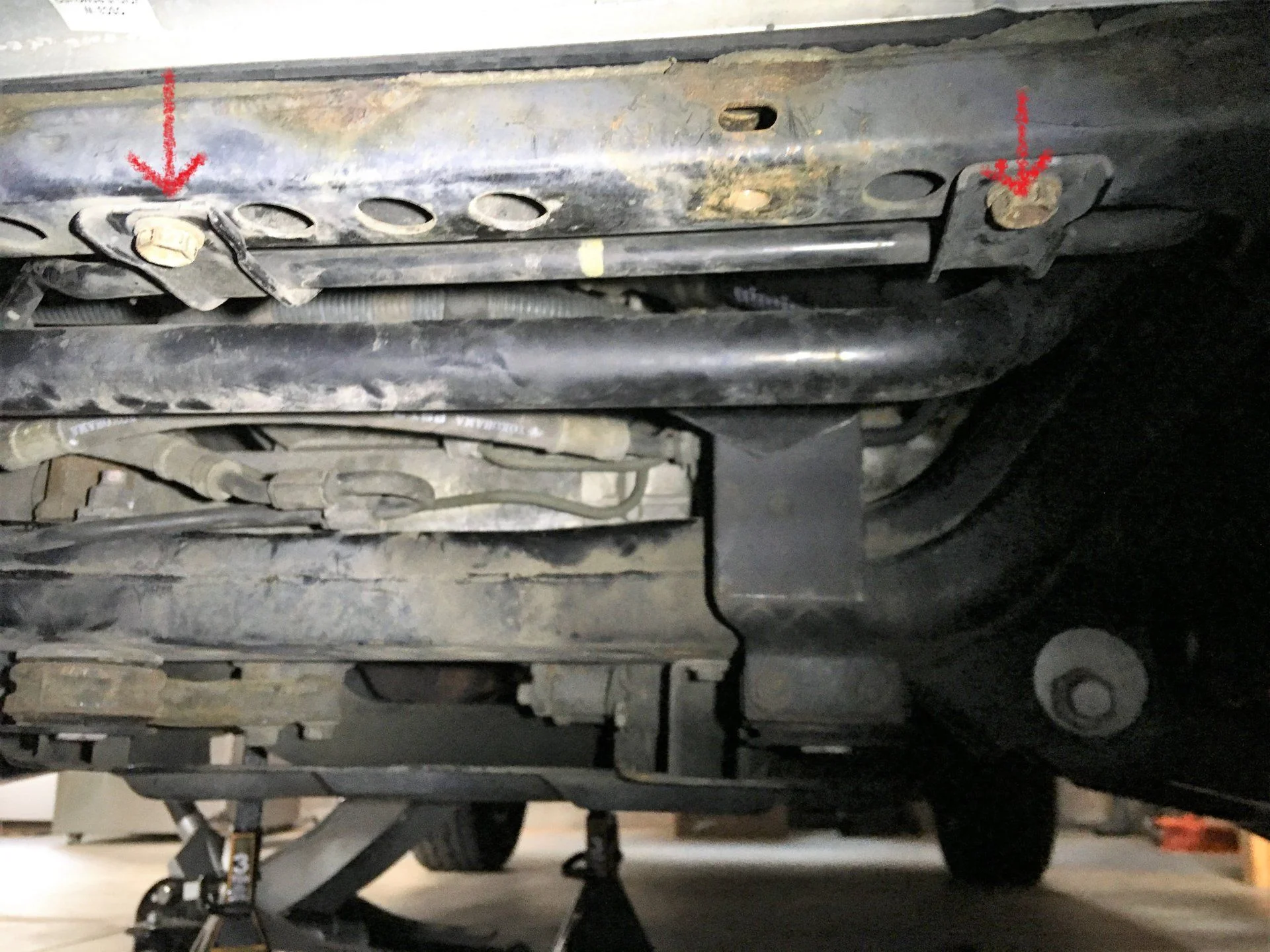

So I just spent a few hours doing this job, and found a much easier way to get the alternator out than to remove the power steering pump bracket, or sway bar. I have attached two images, and the bolts you remove have red arrows pointed at them. They hold what I believe are lower radiator hose lines in place, and once removed allow you to gently push them out of the way to fit the alternator through. You do not need to remove the sway bar, however, removing the right front passenger tire is still advisable. Hopefully doing it this way save people a lot of time and headache. Thanks.
Dave
