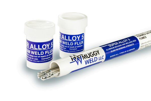

I couldn't get clearance to use that as the hole was on a curve. I got the kit with the hose and two connectors. Cut the line and installed the new hose and connectors and air has been working great with no leaks.
