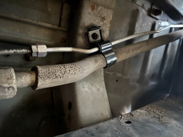

Not sure how I missed this thread, but a couple years ago I replaced my entire rear line with 5/16" nickel copper tubing and a couple a/c splice kits, did a quick recharge, and its been fine for a long time.
I tried bypassing one leak at a holder bracket with that Dorman rubber kit, but then a leak popped up at another bracket. Everyone of those holder brackets is suspect and could pop anytime its bumped. The Nickel Copper tubing is cheap, got 25ft from Amazon, and its super flexible and easy to bend yourself, plus rust resistant. I didn't route it exactly the same as factory but I made it work.

Nice! That looks like you just replaced a short stretch of lines rather than the full length? How did you identify where your leak was?
I read somewhere on mud that this is common place for leaks,i cut the foam which was dirty/oily wet and saw tiny bubbles coming from this spot
KFunk740 - interesting idea, did you put any foam around the nickel copper line like the original, or not needed? Also curious what brackets or mounting you used, like zip ties?
I did slide the foam off the old line and put it on the new one, kind of annoying but I figured I should. Just good ole zip ties.
Hoping that someone can give me some quick pointers. Was recharging my AC system, heard a hiss and noticed a fog cloud under the vehicle. Pinpoint leak where the line passes through the bracket (circled). I assume this is the rear ac line, can someone confirm/comment? I am just starting to understand what I need to do to replace this line. This location is parallel to the muffler, under the middle row passenger side. Thanks in advance.
Yep, that is your high pressure line. Road grit has worn through the soft aluminum line inside of the rubber bushing there it touches the line inside of that bracket. Easiest fix is to cap your rear lines, or you can look into replacing them with flexible hoses or replacing the hard lines.
Thanks for the confirmation @MTrun - so let me run this by you/those who are farther down this road than myself. I can't cap the lines at this point, this is our adventure wagon and I've got 3 minions requiring AC in the back. With that in mind I'm leaning towards the flexible hoses option. Its looking like splicing in the copper nickel flexible line with the Dorman line splice kit is the next logical step (lower cost/less complicated) short of replacing with new hard line? Also I assume that the bracket will disintegrate as soon as I get to removing it, so will be replacing that as well? Once that is all set, run a vacuum on the system, test pressure. If good refill system, mission accomplished. If not good add some dye to the system to find additional leaks. Am I tracking?
Giving this a bump for anyone who could weigh in on my following 'plan' (looking for a yes that seems like a good idea or no you are headed down the wrong trail and here's why). Just hit 80 today and my sense of urgency to fix this issue is quickly escalating:
I plan to follow the @KFunk740 strategy mentioned above by cutting out the majority of my high pressure line and splicing in 5/16 nickel copper tubing with 2 splice kits. I don't plan to touch the ends of the high pressure line where they attach back into the vehicle, because it sounds like this quickly becomes a headache (a number of comments talking about the rear bolts shearing off for example). Remaining question - is it worth replacing the 3 clamps, or are these so corroded that its not worth the effort? And if not replaced, how would I attach the new line...all that is coming to mind is zip ties, which doesn't feel quite right.
Thanks in advance for any final thoughts, comments, and/or pointers here.
I am certainly not qualified to answer these questions, but can speak from my experiences. Replacing the hard lines was a pain in the @$$, but I was quite proud of myself for doing it. My system has worked flawlessly since replacement, except until it didn't. As the months went by, seems I still have a very slow leak from somewhere -- can't tell if it is related to the lines, the 6 other components I replaced, or somewhere else in the system. All that to say, even though I may have done it "right", it isn't perfect. Part of me wonders if just capping the rear lines would have saved a large amount of time, hassle and made a more reliable system in the end. 80 series land cruisers never had a rear AC system, so I see why it is worth it to some people to trade a little cooling in the back for a reliable system by capping them. Your mileage may vary. The clamps in my humble opinion don't add a lot, and are an imperfect design (just judging from the way they are the first failure points in the hard lines). Many of the clamps can be individually purchased new oem, just go to PartSouq and find the part numbers on the exploded diagrams. If you use zip ties on an alternate replacement line, I would just encourage you to ensure you aren't making new abrasion/wear points -- perhaps wrap those spots in a small amount of self fusing silicon tape for instance and then put the zip-tie around that for a homemade rubber bushing that won't attract grit.
In the end -- I don't like varying too much from factory design as Toyota engineers spent countless hours trying to refine the design as it is -- HOWEVER, seeing that these lines were never really designed to be wear items (lifetime components), I would say we are forging a little bit of trail on this one.
2 years on with the flexible hoses, I havent’t had to add freon once and I am more than happy to have a more balanced cooling throughout the car, instead of the front vents blasting full cold at me at those hot days.
