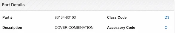

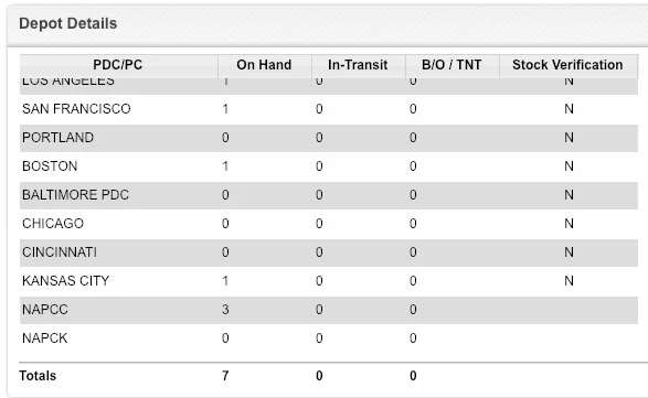

New lens is still available from Toyota for a very reasonable price. Used lenses tend to be scratched up, deteriorated over time.
83134-60100: MSRP $44.42 7 available in the country.

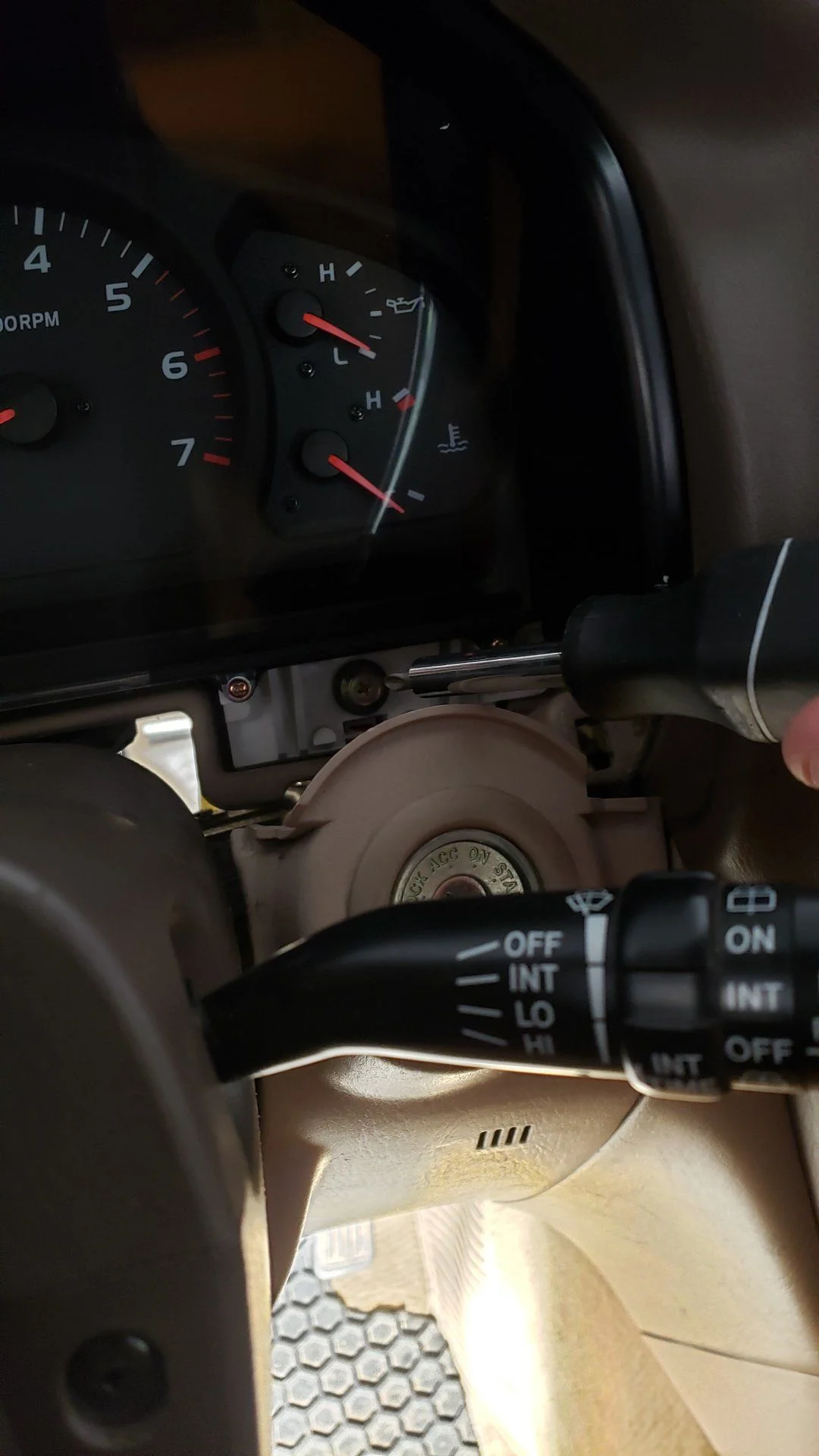

I replaced mine (100 not 80) in less than an hour. Don't need to remove the steering wheel. Do disconnect the battery though. Just make sure you have a tray to catch the small screws from falling into steering console cover. Also, the large gold-colored screws won't seem to tighten. See picture. Doesn't seem to matter though as it all snugged up nicely with the other screws. Also, don't spray any Windex or armor all on the lens. It will cloud.
