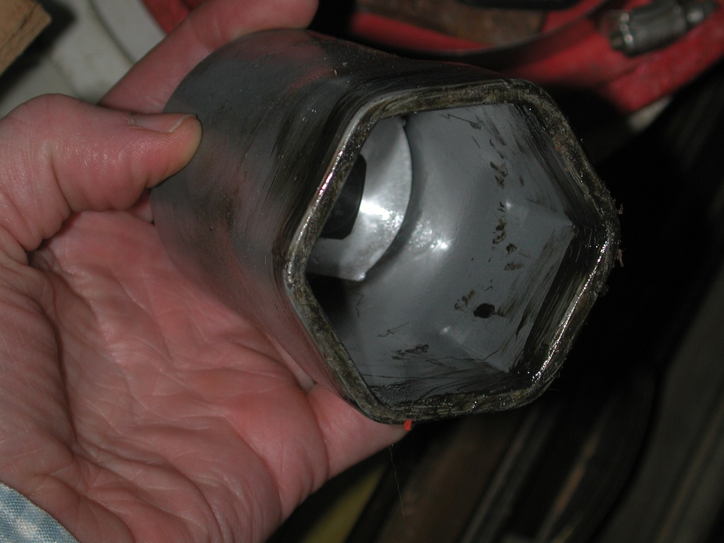

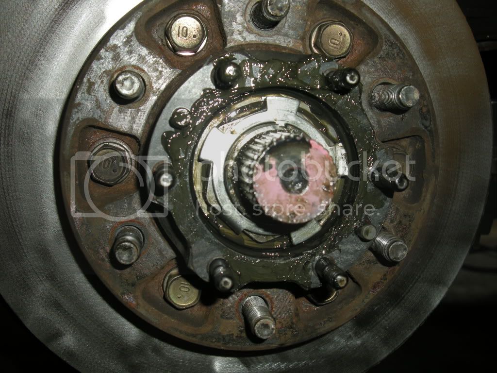

First, you need to clean some of the grease out, and tap the locking tab back. Now you have a BIG flat nut, and you probably don't have a socket that big. I didn't so I used a small punch and tapped it loose. It only goes about 1/4 turn before it is loose enough to take off with your fingers. Take note of the position before you remove it, as reassembly will be in the same position
Now take the locking tab out.
ANOTHER BIG NUT! Same thing--take note of the position--tap it and it should loosen right up.
When you put this nut back on, it should be little more than finger tight. spin the rotor often when reassembling to get a good seat on the bearing.
