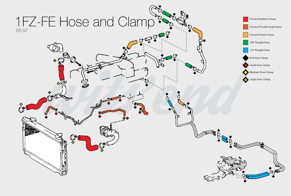

@NLXTACY do have the Toyota #10 clamps on your site?

Joey to the rescue again.
When I replaced every hose and clamp in my cooling system Joey's new offering would have saved me a lot of time and frustration.
Joey, it would be nice if you would offer a set of clamps with the hoses. My preference is the OEM style, not the Breeze constant tension. I think the Breeze are too bulky and heavy, particularly for use on the plastic heater control valve. I ended up buying Rotor Clip brand, which I'm very happy with.

I did find that sorting out the sizing myself was a PITA, so if you're still figuring out how you're going to offer your hose replacement set, I would suggest including the Rotor Clip (or similar).
