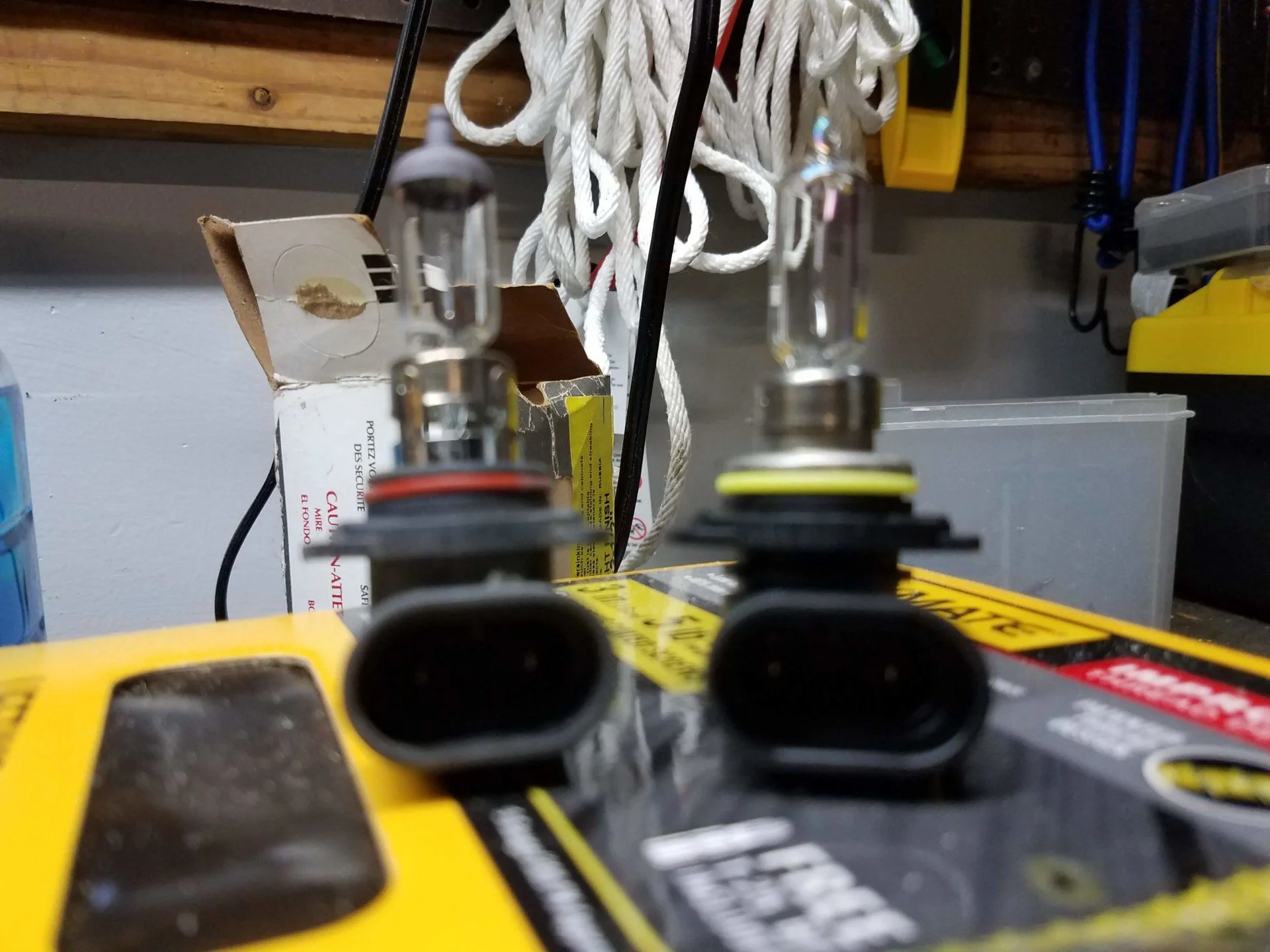

I went with LED bulbs. The light pattern is pretty scattered. I have let to try to adjust the bulb a ton. Diode dynamics bulbs don’t fit. I’m guessing some others don’t as well. The problem was the back spacing on the bulbs design The light out put is nice and bright. My old HIR bulbs where pretty comparable but did not last long.
I ordered these for about $19 for 2. I think I got the number off the Candle power website IIRC.

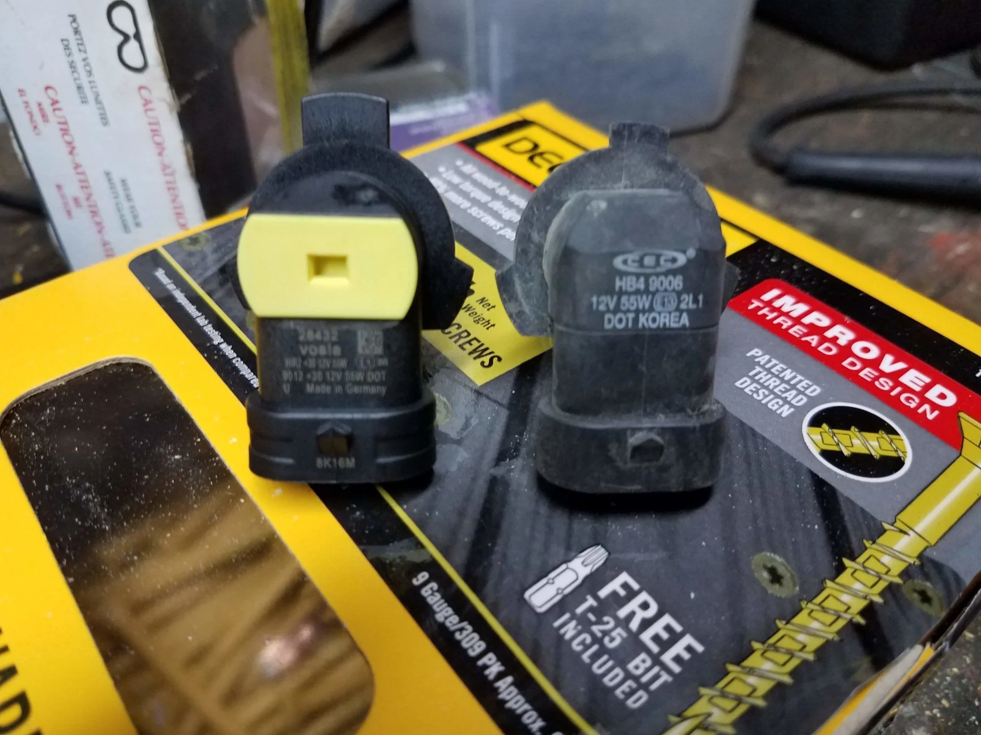

Genuine GM Bulb Part# 23342527
What arrived was the vosla bulbs (has the yellow plastic on them in the pictures). Had to do a little trimming on the tab but wow what a difference. I didn't do anything more than trim the tab, connect the connector and put them in the hole. Nobody's ever flashed me so I guess they're all right.

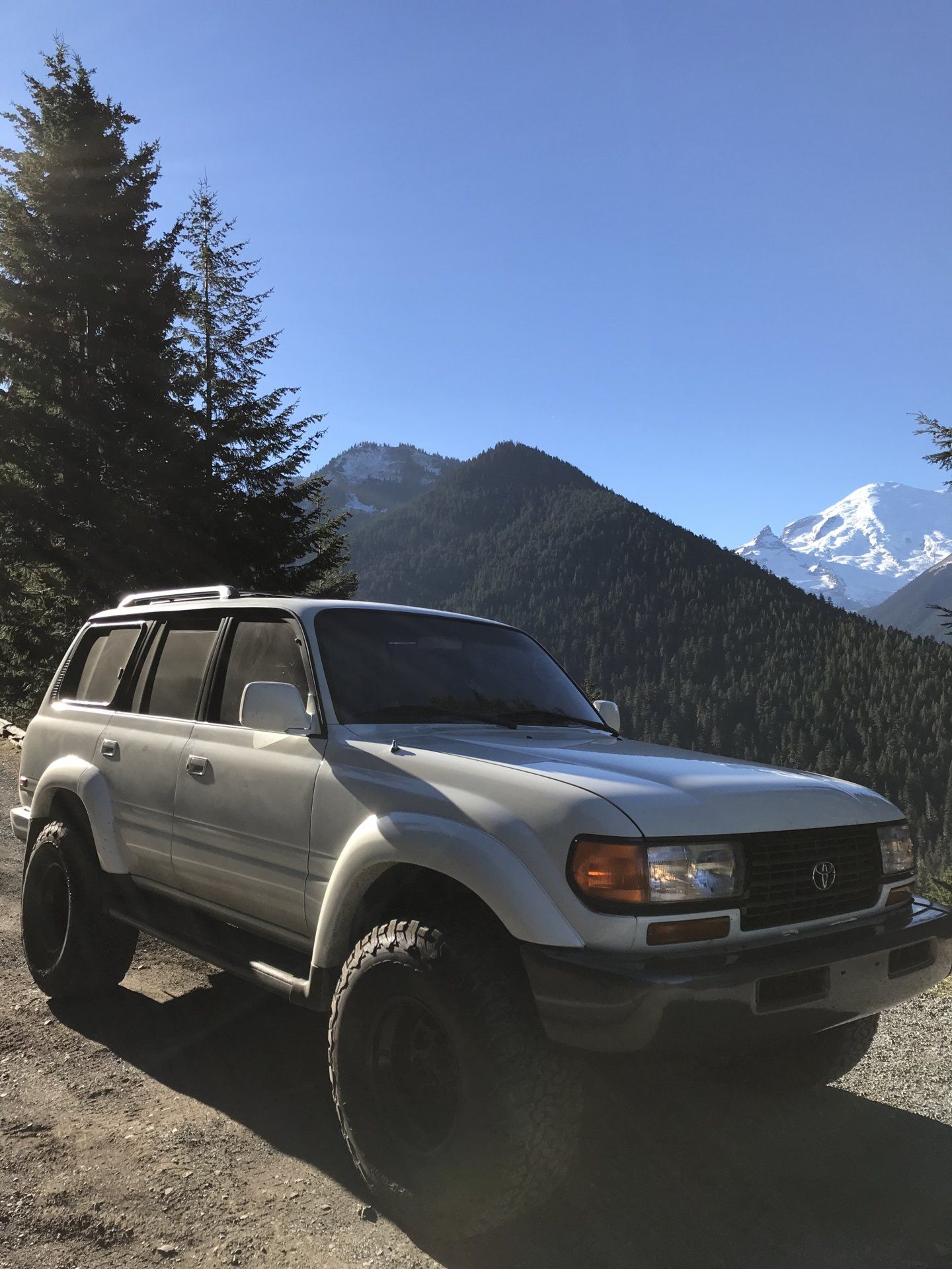

@clx16 I've been watching the round headlight thread from the beginning and I'm a big fan of the look (FJ60 is my spirit animal), but just can't swallow the cost for something that's mostly cosmetic. Now if I tried 9011's and found it inadequate, maybe I could convince myself it wasn't cosmetic :eek: Side note, even though I have a Lexus, it has a toyota grill and headlights :meh:

I am an enabler and I bet your radiator is not protected behind that grille like it could be haha.

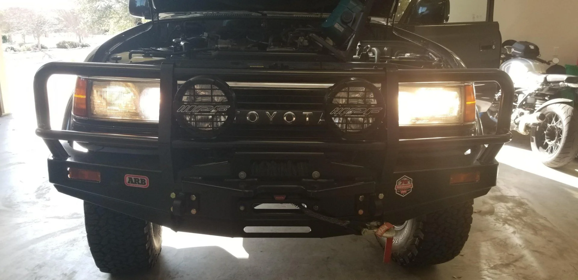

Yesterday I put 9011 bulbs in all bulb positions. It took a bit to trim them to fit the low beam harness. Otherwise the needed tab trimming didn't take much time with a file and calipers. Seriously a major upgrade.
DS (right in the picture) has the 9011s and PS (left in the picture) shows the stock 9005/9006 combination.
The low beam position on the right in the photo appear about as bright as the high beams.
