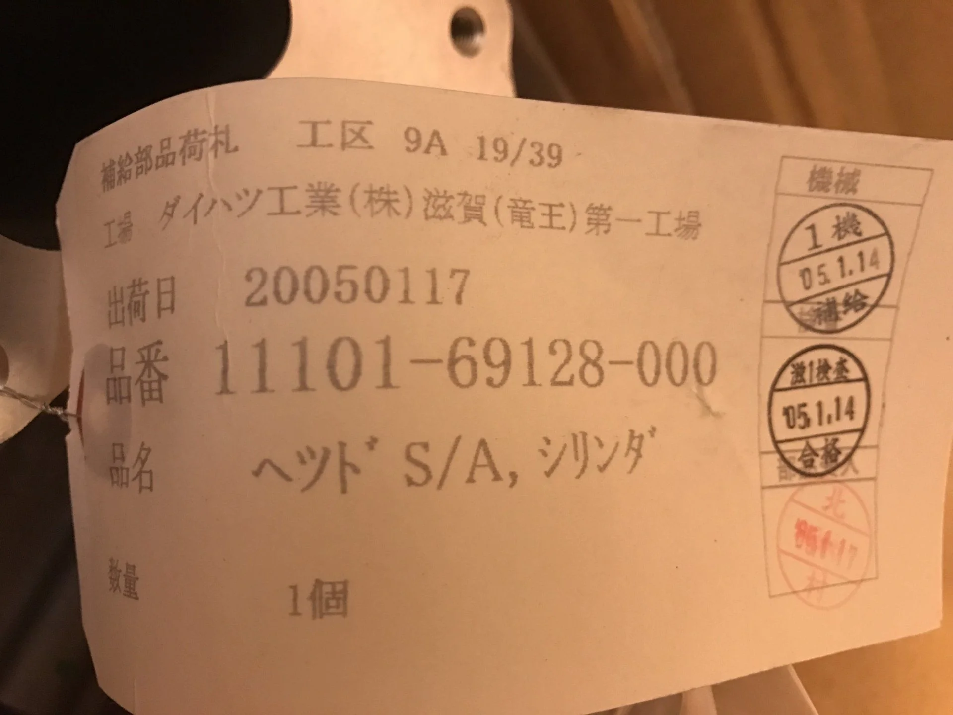

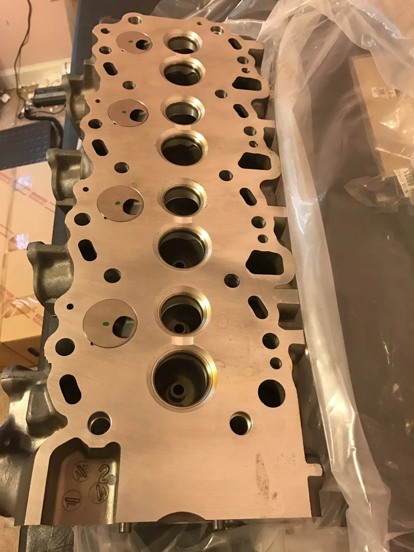

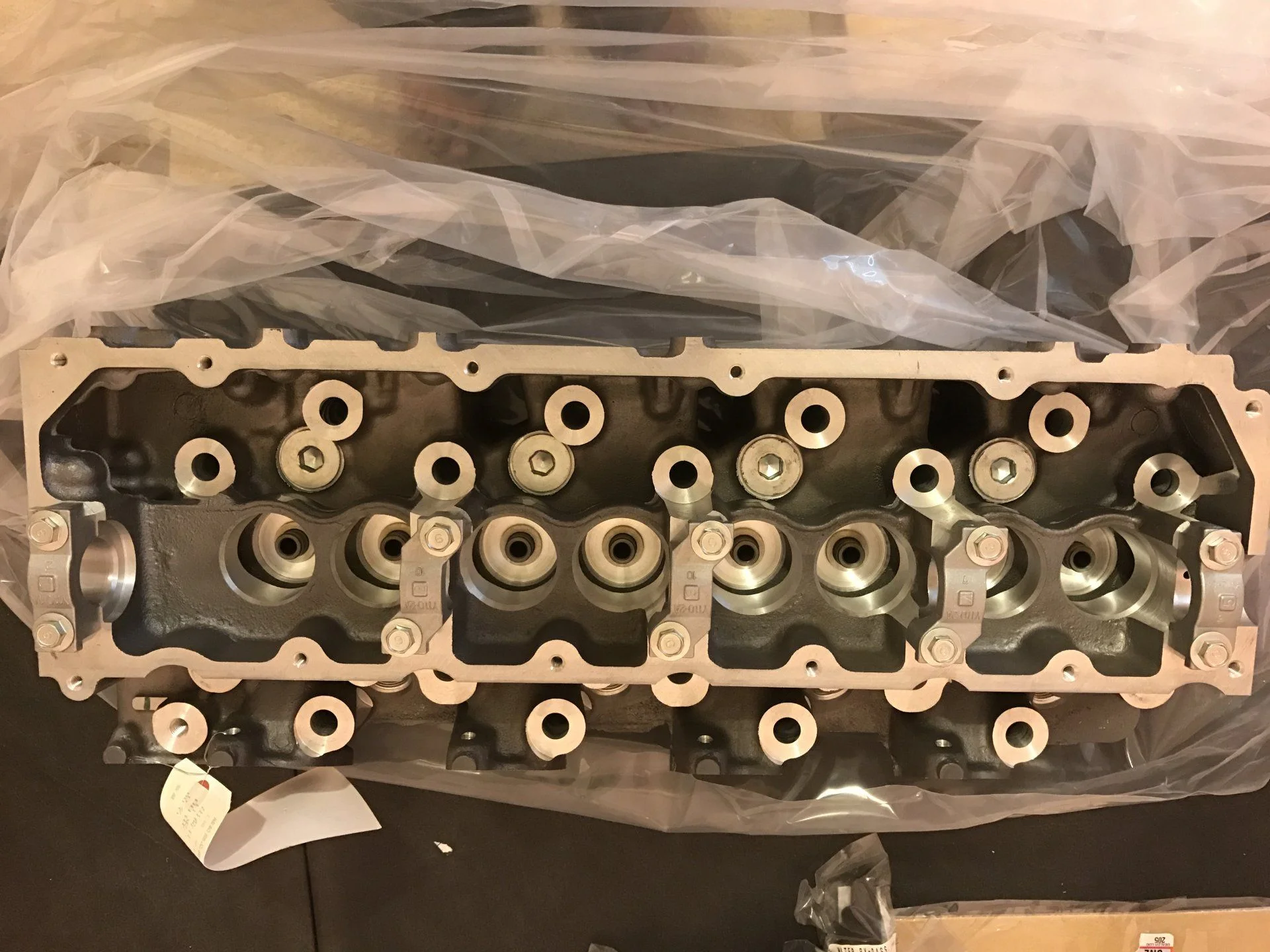

No Toyota heads come “loaded”.
They are bare heads with only valve seats, bearing caps, pre-combustion chambers (if applicable) and valve stems already pressed in.
Everything else must be sourced and installed.
Here is a 1KZ cylinder head, for example.
