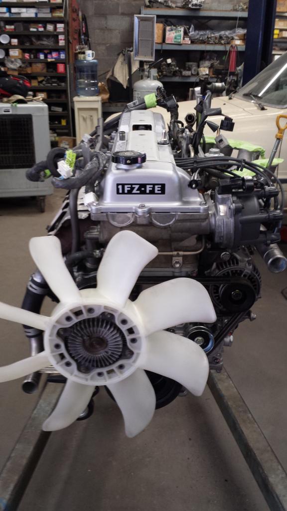

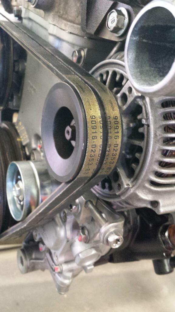

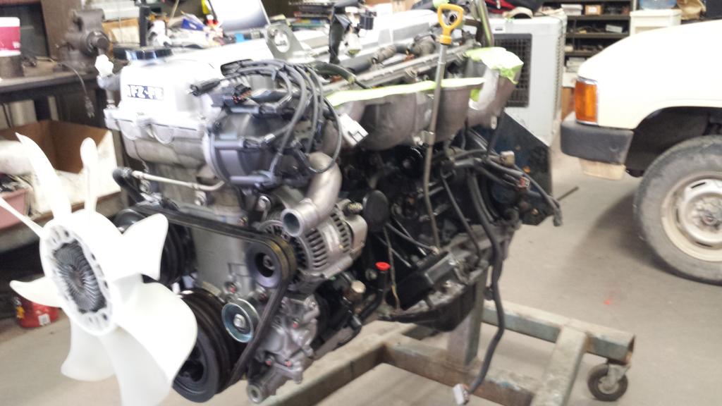

The starter on the engine was an off brand rebuild so I ordered a new Toyota remanufactured unit. They had both 1.4 kw and a 2.0 kw models and the price difference was just $20 so we got the "cold conditions" 2.0 kw model. Got to put the rest of the accessories on, belts on, distributor, new packing, new rotor and new wires on. The fan was cleaned and installed. Clutch seems to be in excellent shape. Went a head and ordered a new ECU temp sender, new exhaust manifold to pipe studs and some miscellaneous wiring harness clamps and tabs. PHH replaced with silicon hose and constant torque clamps from 1FZFEPHH.com
Hopefully this weekend it will be going back in!
Motor is in and most everything is hooked up except for the transmission harness, the O2 sensor harness and installing the battery box, air cleaner, radiator, fan, and shroud. I can not express my love for working with a lift instead of on the floor with jack stands and jacks! Pics to follow.
She's alive! Got everything hooked up and filled the radiator up and she fired right up. Ran it in the shop for a bit and topped the radiator and transmission off and took her down to fill her up. Very smooth with just a little exhaust tick somewhere. Cruise and ac working great. Hooked up my torque pro program and bluetooth adapter to monitor the temps. It is 104 here today and the temps were running between 197 ad 199 down the road and up to 206 while idling. Not too bad! No leaks other than the ac condesation!
