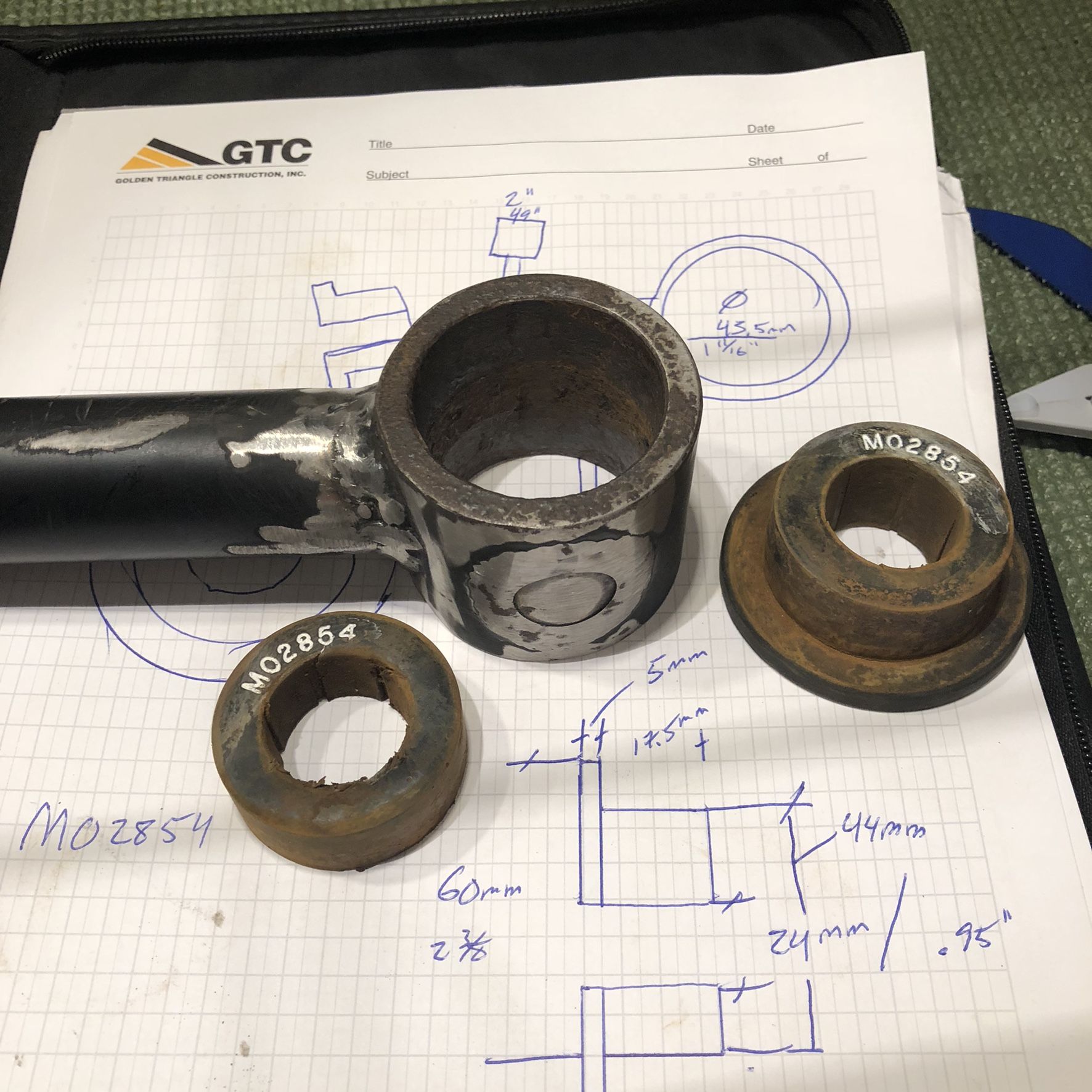

I need to replace the bushings that were in my Man-a-fre UCA's. Can anyone point me to a site that has a large variety of options in the size I need? The part number I found on the old bushing doesn't bring anything up.
  • Outer Bushing Dia. 44mm / 1.73"
  • Inner Bushing Dia. 24mm / .95"
  • Outer Tube Length ~36mm / 1.4"
  • Inner Sleeve Length ~60mm / 2.36"

I'm pretty sure that's a Daystar part number molded into the bushing. I can't find anything on their website though...might be worth a phone call and talk to a person.
No, I called them about a month ago regarding this. They haven't sold these arms for several years and he didn't have any info on them. Said he believes they were re-branded metal tek UCA's. Metaltek doesn't sell this style UCA anymore (if they ever did)
If you know what the durometer rating is on the polyurethane you can just have new bushings machined.
Thanks Joey. I'm getting tired of the pain in the ass this is becoming. The amount I'd save by replacing the heims and bushings over just buying a new set of arms is quickly making this venture not worth it.

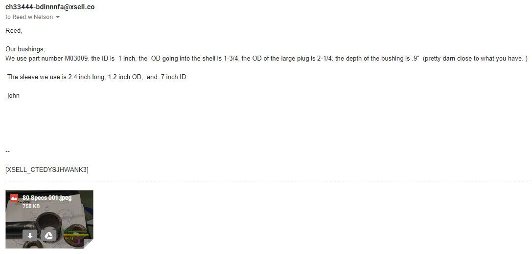

Seems like OEM isn't an option here but if it is, partsouq.com is a place to go.
